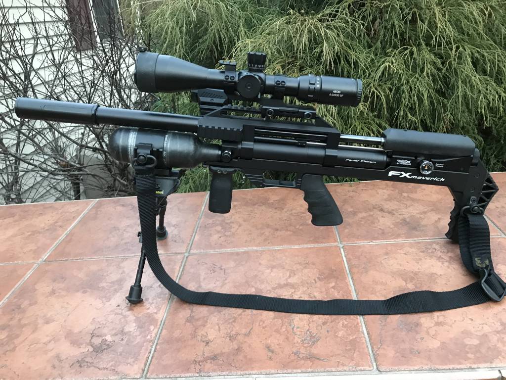

Am I the only one who thinks this is a dangerous way to attach a sling? Poster says he carries barrel down also. What happens in a downhill fall? Barrel possibly digs into ground causing the carriers weigh to pull on the bottle, which is now being restrained. Doesn't seem like a real good scenario go me.
Seems as safe as carrying depressed muzzle with any other sling apparatus. The pressure to shear the bottle off with the sling attachment during a fall is no more of a concern than falling and hitting the bottle on a fixed object. I like it very nice... 👍
