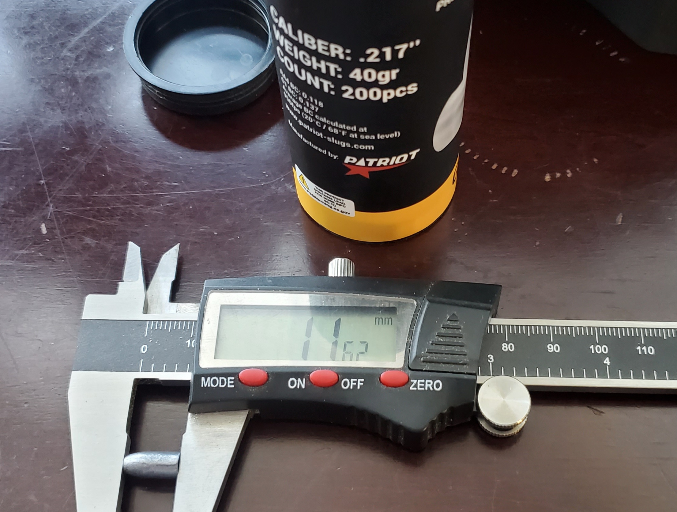

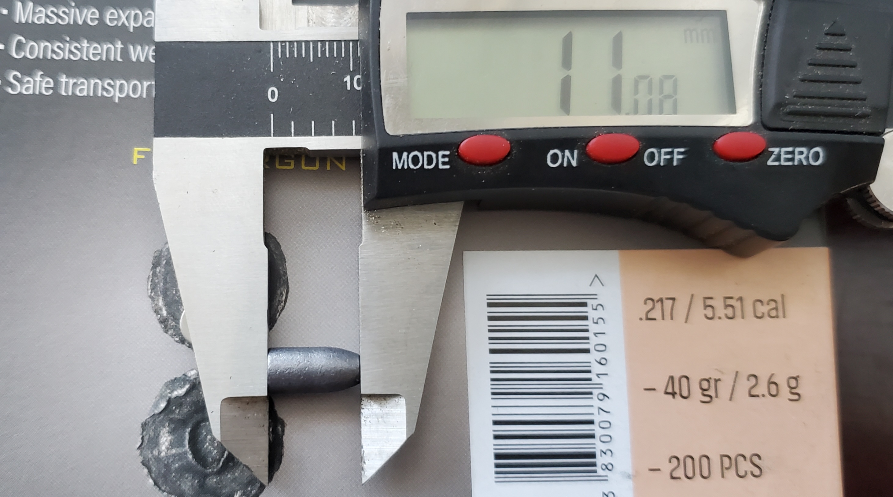

I can’t find length for 40 grain slugs and I assume they are a little longer than the 38 grain NSA which is already a tiny bit too long for the factory 1:16 twist rate. The 38 grain nsa and 40 grain Javlin would need the 1:14 twist rate but FX isn’t shipping that in 700mm liner, plus other factors such as shot count and how violent recoil might be other reasons why they are shooting 34 grain. The BC difference between 34 and 40 grain is about 10% so the juice might not be worth the squeezing by pushing the gun to absolute limit. Only time will tell but I’m sticking to 35 grain NSA myself for now.

According to javelin info the BC for 40 grain is 0.137 and 34 grain is 0.117.
Thanks! Both of them definitely need 1:14 twist rate.
Where did you get a twist rate from length? Thanks.
Allen
online Twist rate calculators, I use this one:
Surface area formulas of area of an circle(base/bore of the slug) is
A = π x r squared
A for .22 slug is 0.15, A for 0.25 slug is 0.2 square inch. Force is measured in pound per square inch. With reg pressure/tune being 100% identical at 2000 PSI:
