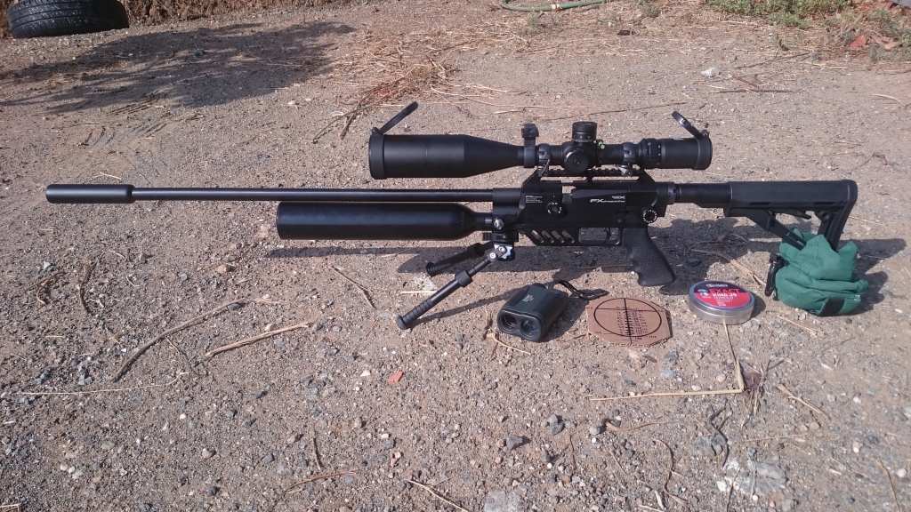

Hi Jonathan
To end my headache ..... with the configuration that I have in my weapon or I can get and having enough regulation margin: Dreamline tac aluminum bottle cal .25
with double plenum, new Huma transfer, needle filed and with speeds with King Heavy MKII 34gr, regulator at 110bar and 267ms (876fps) or 150bar and 305ms (1000fps)
What liner would have to buy for the Hybrids and King Heavy MKII to work perfectly ........ The superior standard or superior heavy. ???
B, regards
Diaz, the Standard Superior is supposed to shoot Hybrids and the MKII Heavies very well.
