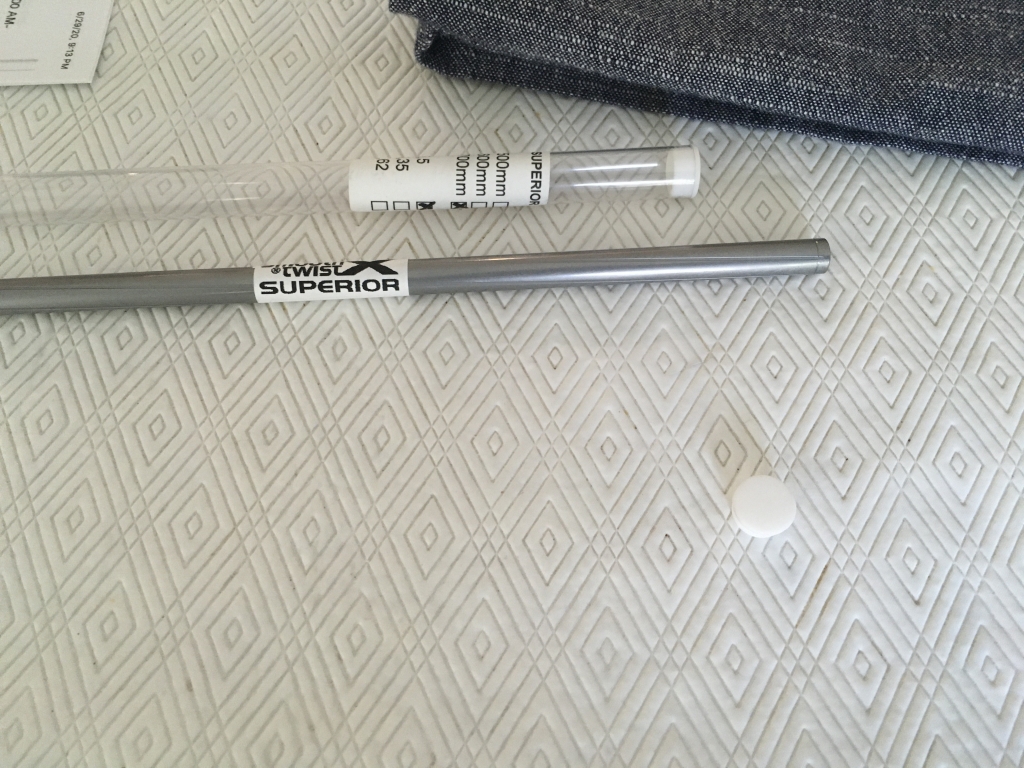

Quick question to Jonothan: what is the twist rate on STX superior smooth twist liner in .22 500 mm?
I have bought one and it measures 1:23 although its a bit tricky to measure as you have to measure half way oint then double it, I have found FX absolutely useless in giving me the actual measurement, they keep on telling me its 1:19 but that is what the STX measured !!
The superior standard is 1:23 twist
