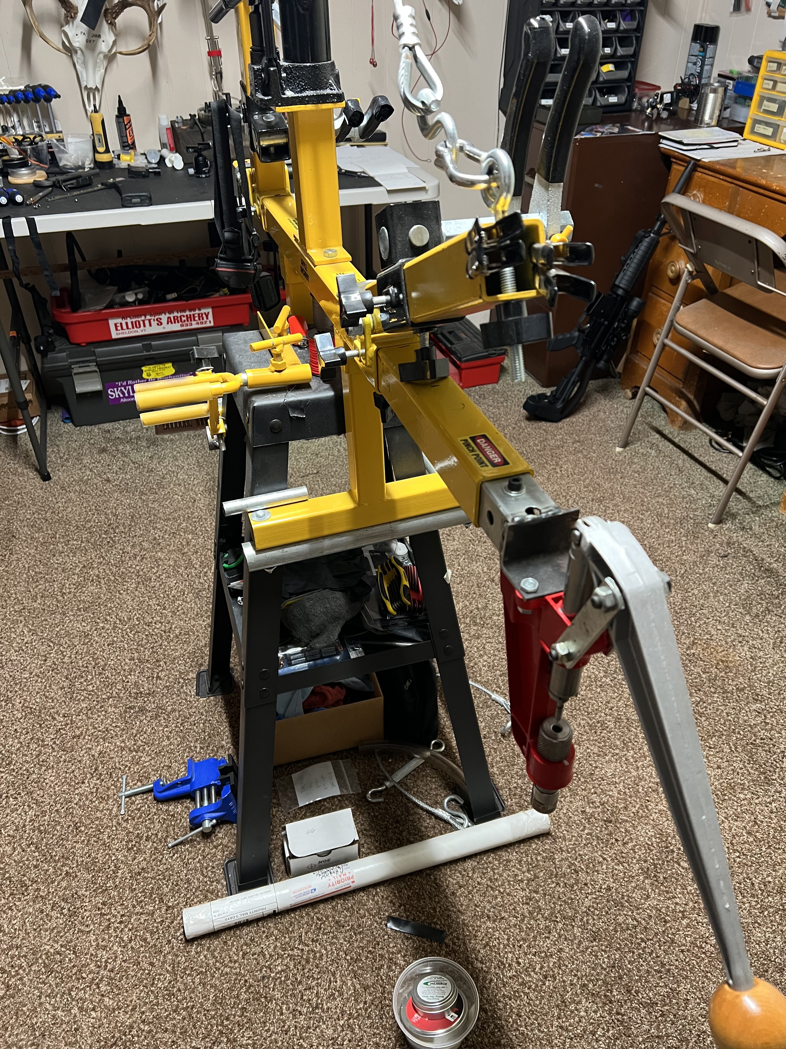

@Vetmx What all do you have here? Looks like a swaging press.
