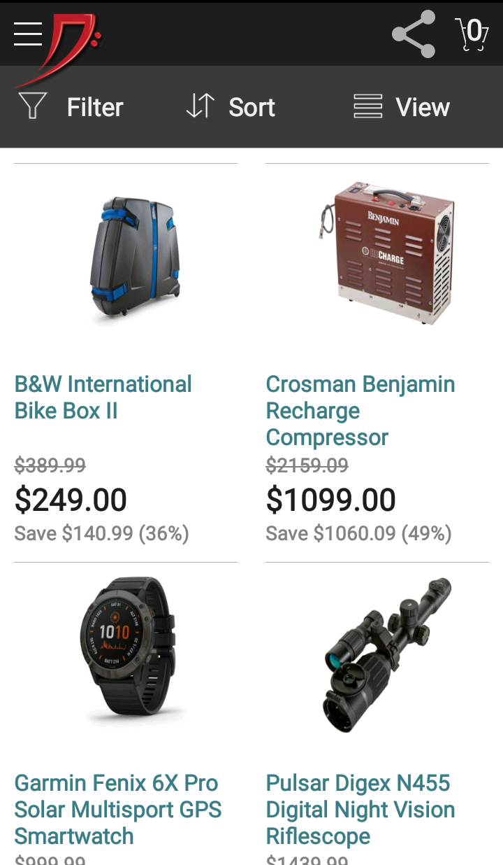

I have had excellent luck with my Benjamin ReCharge compressor. Only 22.5 hours on it and it is a Chinese compressor, but has been flawless for me and all I've done is change the oil a couple of times. I mostly just re-fill guns, but I also have a 6.8 liter and a 18 cu ft tank which I have also filled, then topped off with the ReCharge. One year warranty on the compressor, as compared to the 5 year warranty on most Benjamin products.
There is another recent post on AGN about the ReCharge and its less than stellar performance in Club use. But I haven't had any of those issues with mine. I don't normally purchase from Optics Planet, but they had the best price ($1,239 and IIRC free shipping, and in stock). The purchase was fine and so far the compressor has definitely been well worth the price for me. I use one of the cartridge filters (oil/water separator) I bought off Amazon for about $100, and other than a couple of quarts of compressor oil that is my total investment.
