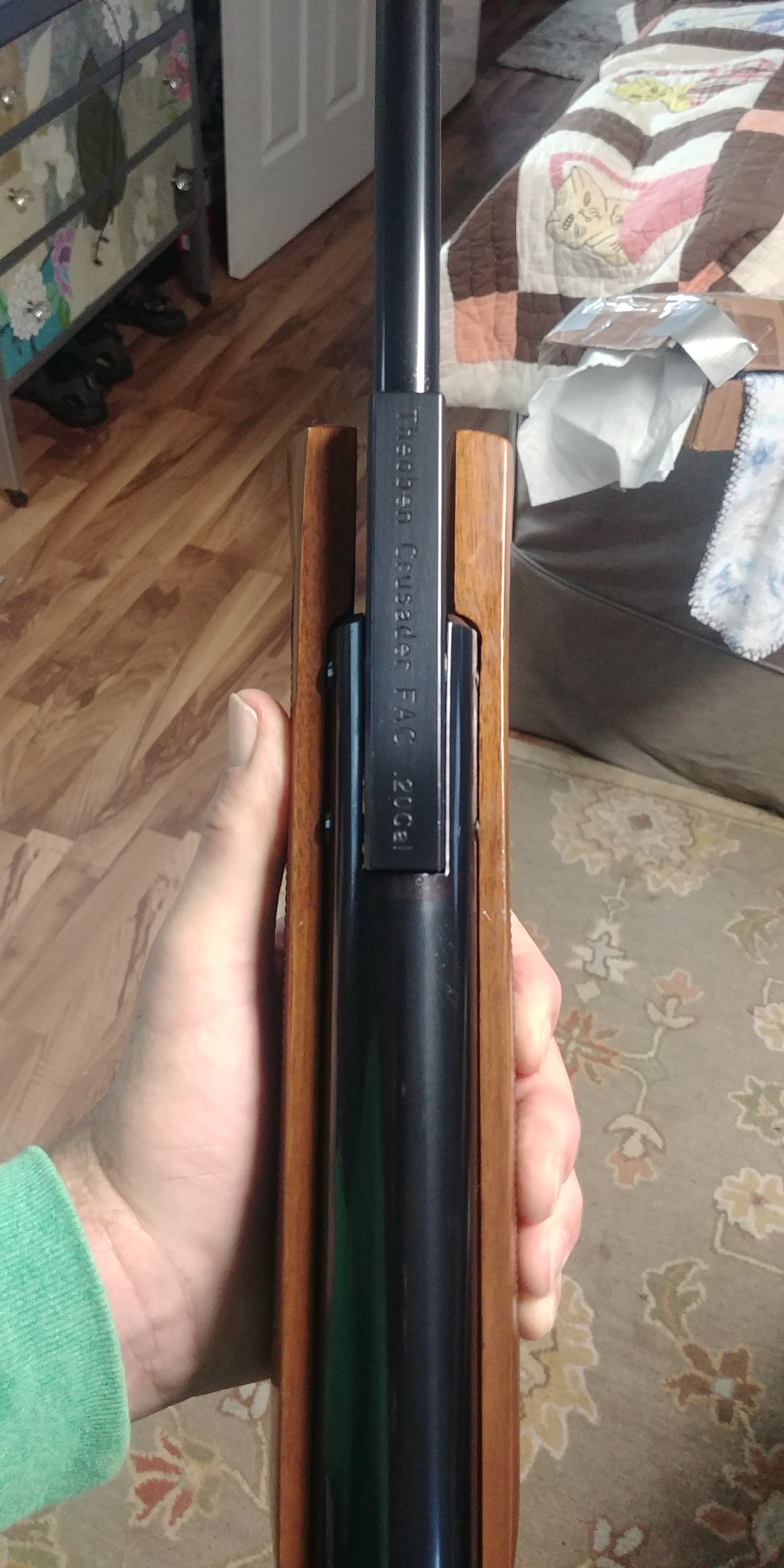

Back in the 80s I would read the articles in the Beeman catalog and Robert was a big proponent of 20 cal. Decades later, I bought the German spring rifles I wanted as a kid. I kind of regret selling my Beeman R9 in .20 cal. it has smashed plenty of pigeons before I got into PCPs. Now, I only have a R7 in .20 cal left in my collection. Photo of the leftover .20 caliber pellets I have in my closet.
I haven’t seen a box of login penetrators in decades .

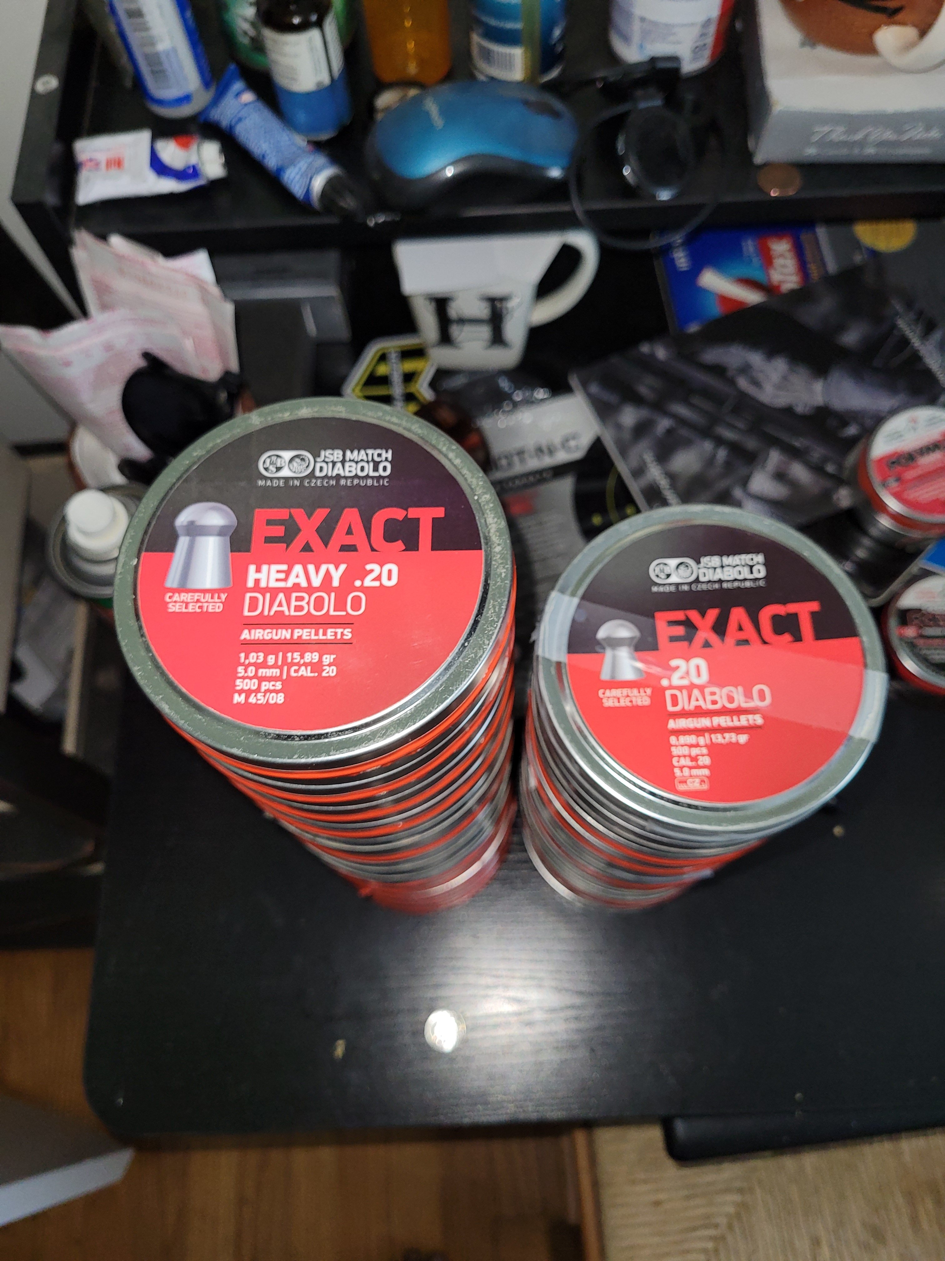

I still have a few of those same Benjamin and Sheridan pellets left. I recently found some JSB Heavy 15.89 on Amazon.

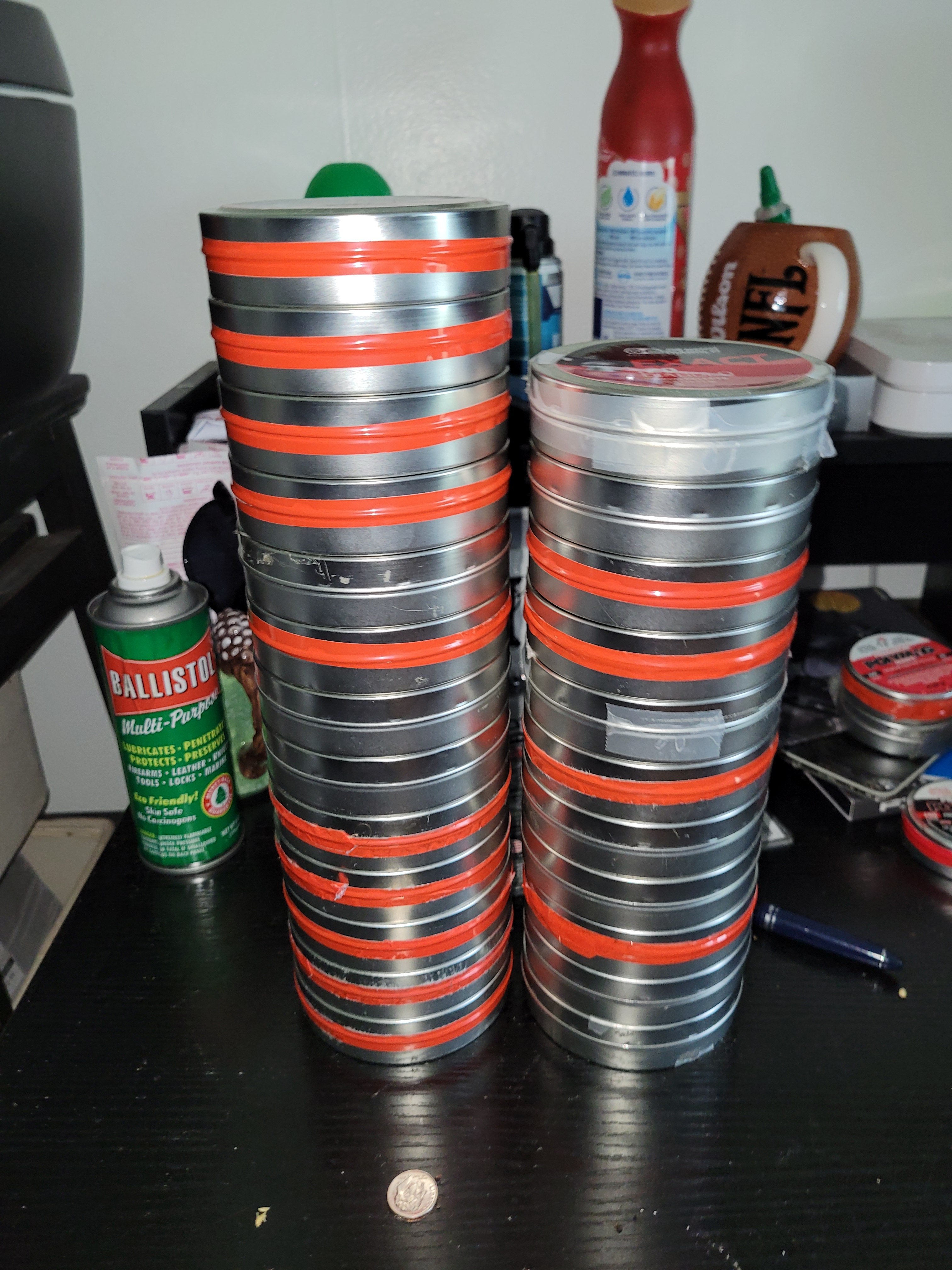

I have some stock in .20 cal. They should last a while only have the 2 pistols and a couple of rifles.

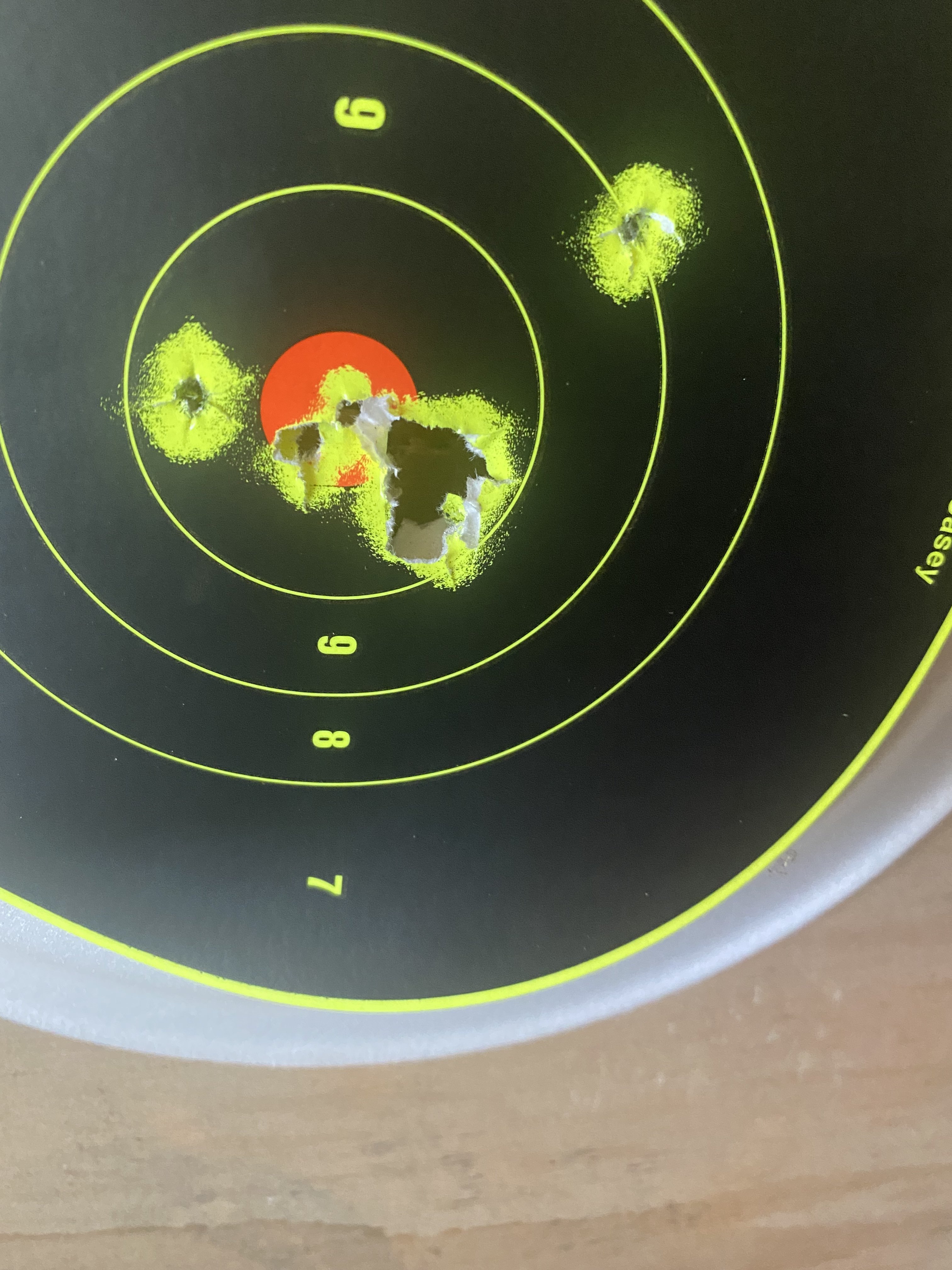

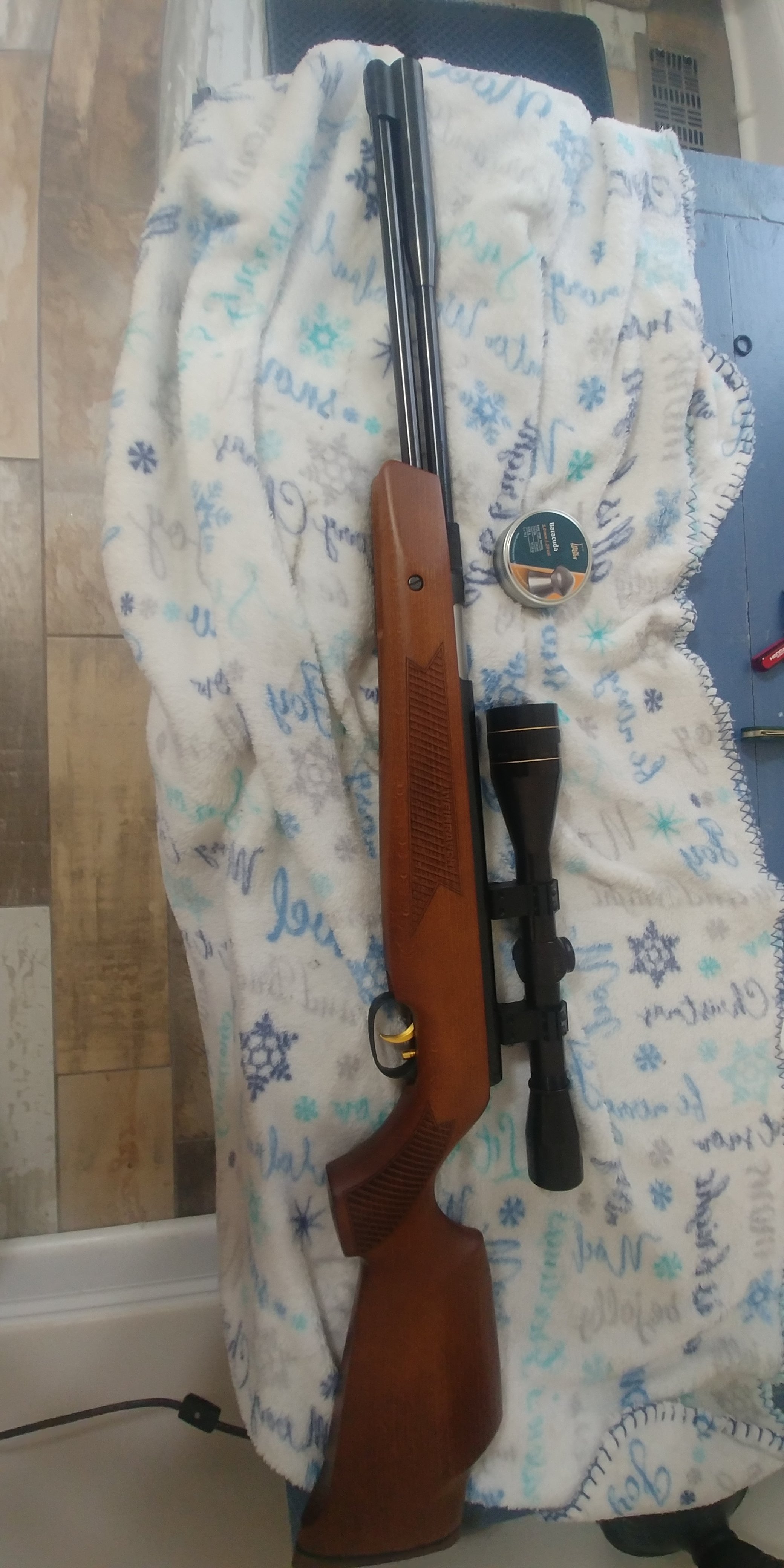

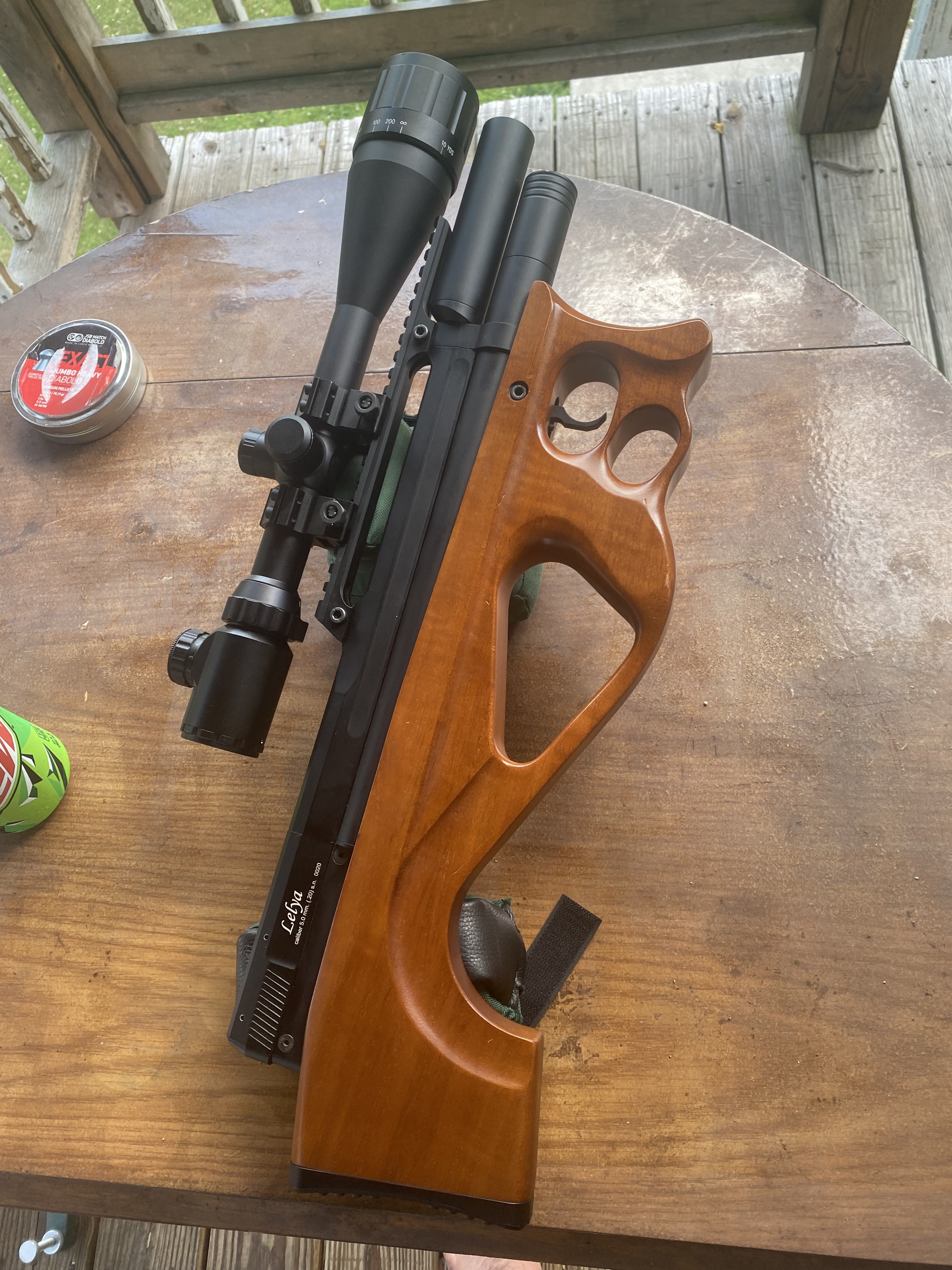

Just got my first .20 cal scoped up and sighted in and love it, the big hole is 15 shots @ 50yds awsome accuracy from such a small platform, the rifle over all is only like 20”. For me the .20 cal isn’t dead and just a new beginning for me, going to stock up on pellets before they are non existent
Excellent little rifle 👍🏻
