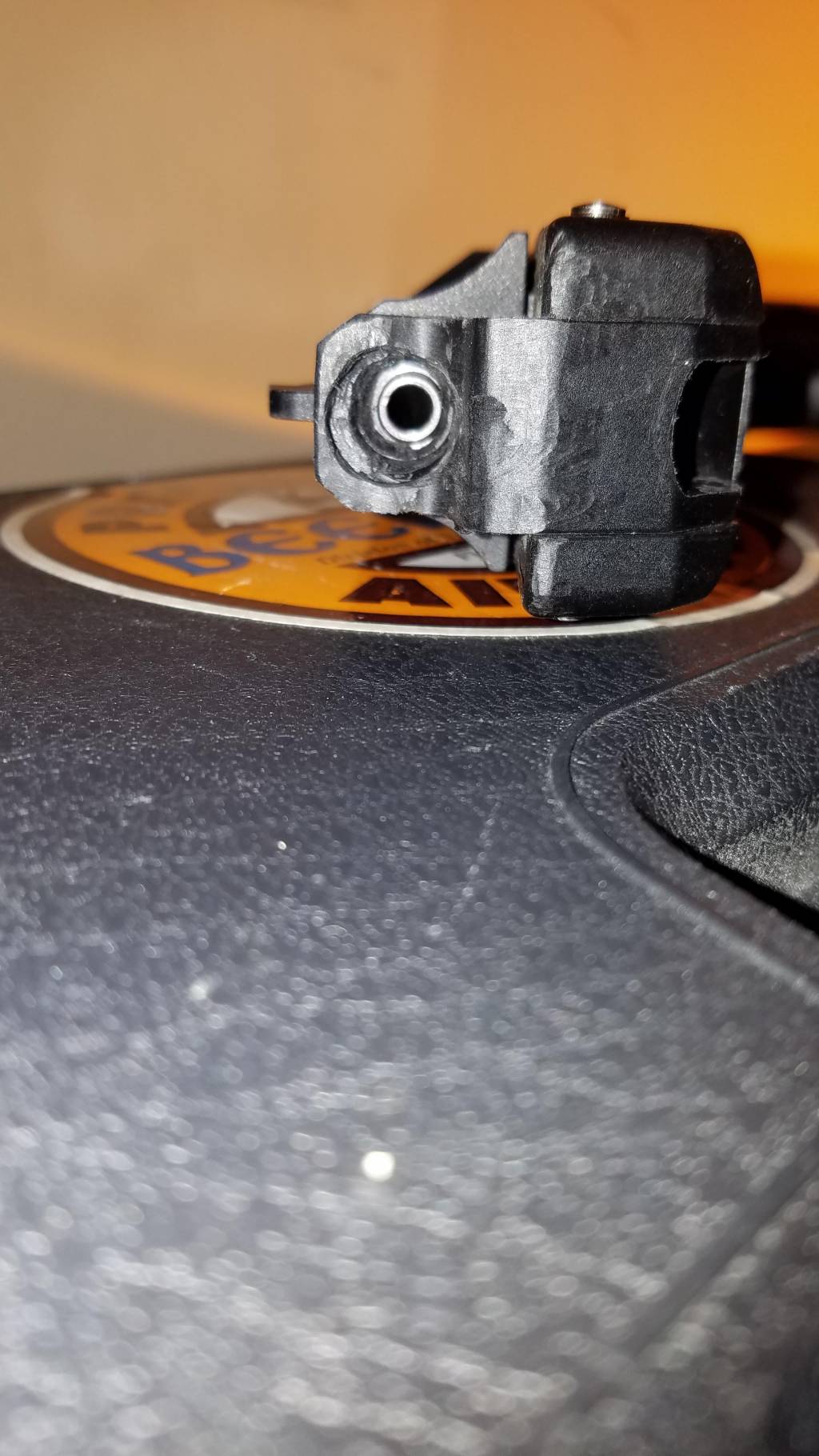

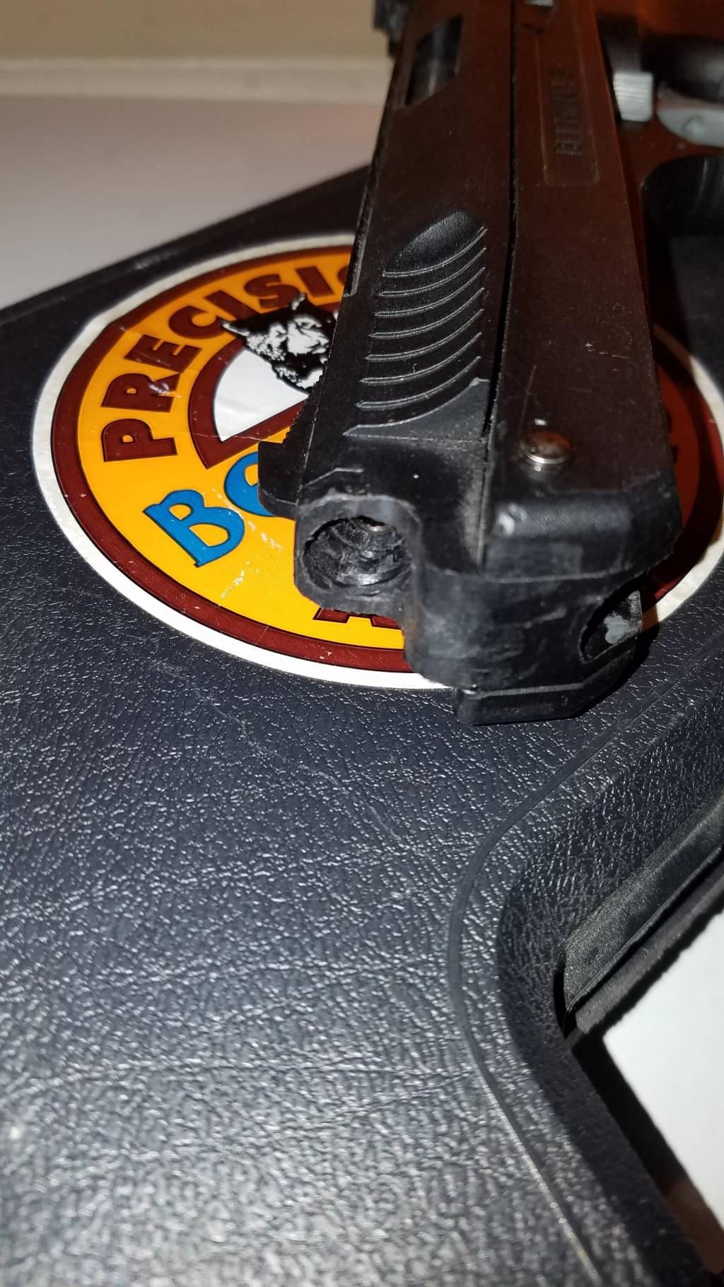

Since a picture is worth a thousand words, here is what I'm working with:
I was a foolish youth. :( At least I was smart enough to remove the barrel so the crown wasn't damaged.

The HW40 cocking lever, as it is called in the diagram, is available from Airgun Spares for $38 and whatever they get to ship it. If you are tired of it, send it to me, I'll tinker with it...;)
:O This is gold. OMG OMG OMG thank you thank you thank you!!! If Rick can't help, I'm going to order a grip of parts from there. I don't even care that shipping is 30 and it will take a while. This is everything.
I even see I can order a .22 barrel! I might just do that since I'm curious to get into .22. Seems like it will fit up fine, since there is only one SKU for the cocking lever.
