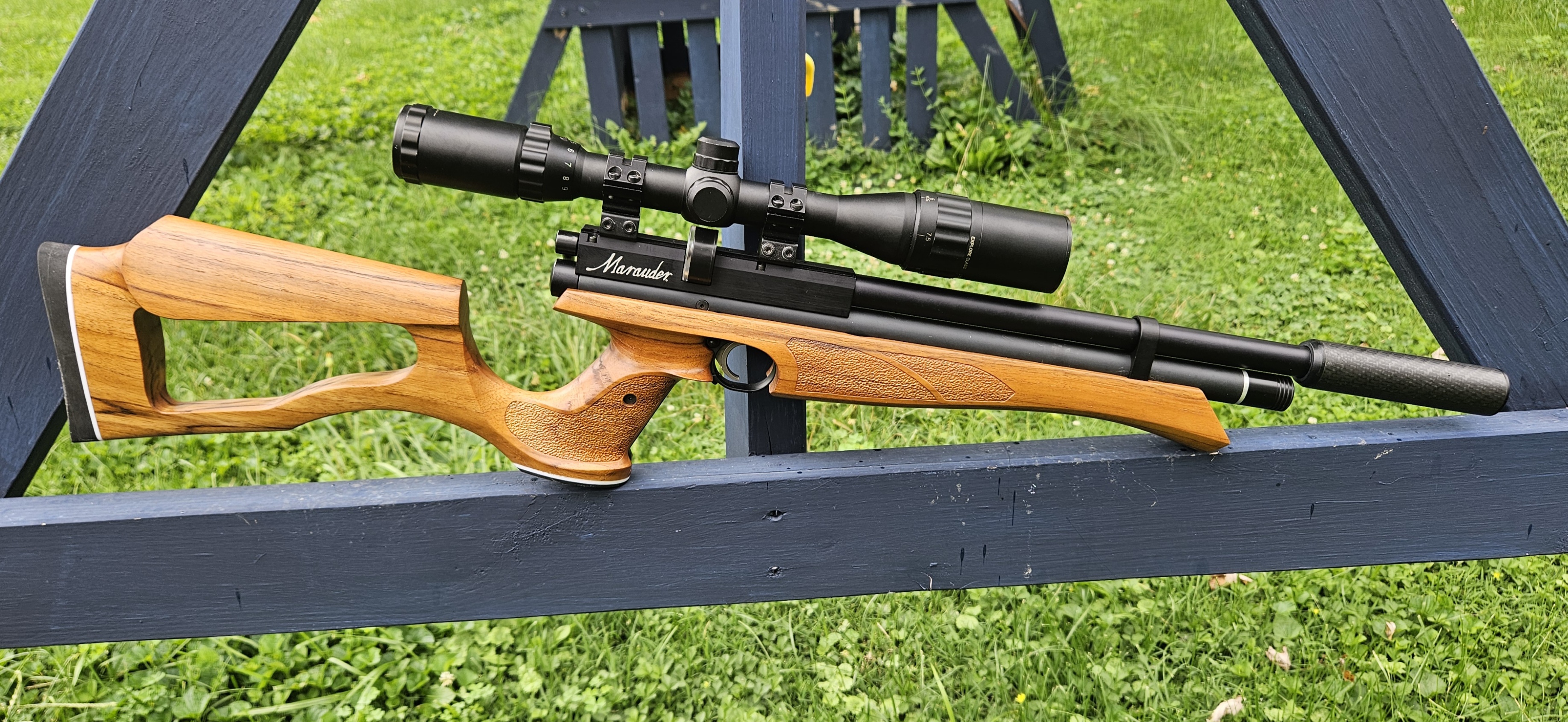

I have four .25 caliber Marauders ranging from 44 to 60+ fpe. I even have a short shroud on two of them. But I use a DFL suppressor sometimes on those two if noise is a concern (which it rarely is for me). Regardless, the loudest noise coming from them is the hammer striking the knock off valve. The muzzle report is very subdued. The .25 rifle with the short shroud at 60 fpe does have a bark which is muted by the DFL. Of course, especially on cool days, if I run the 16 grain alloy pellets there is a supersonic crack ;).

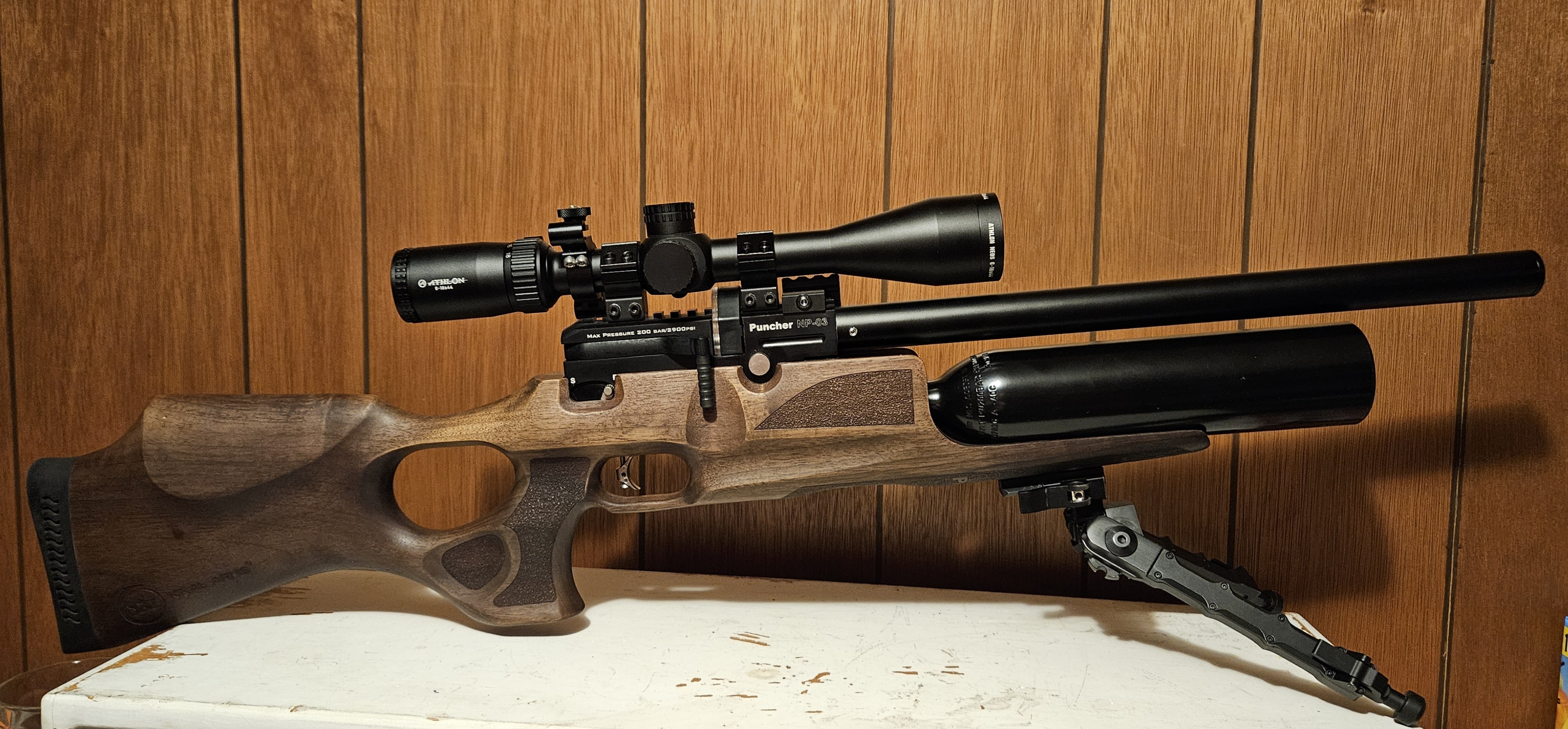

Quietest gun I own currently is my own customized Kral Jumbo 22.
34" long, huma shrouded and doing 850 fps with Hades 15.89 pellets. It has just a little bottle ping noise, but you can't really hear the muzzle report.
Next favorite would be my Prod, which is probably just as quiet but no ping sound.
P Rod's looking good Doc!
