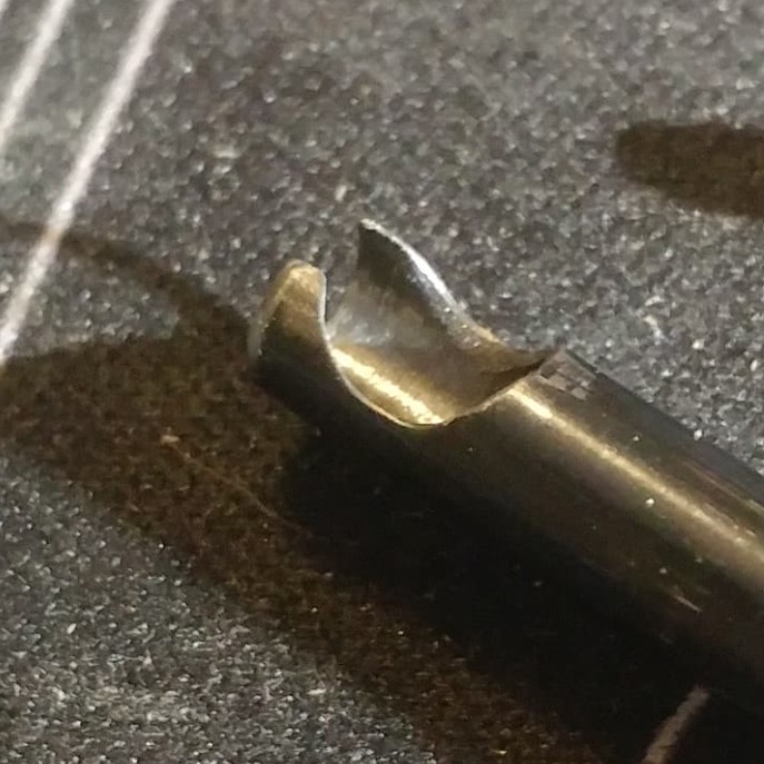

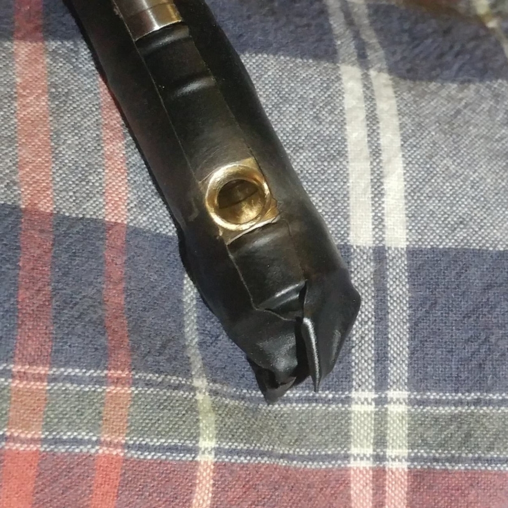

Flare the outside of the port to match the .30 port wheel setting, leave the center bore diameter alone, radius and elongate the inside of the port toward the barrel, and cut the probe to match. Just takes some rotary tool diamond bur bits and some patience. From what I've seen is equally effective, and in a lot of cases more effective than the large "slug" ports.
