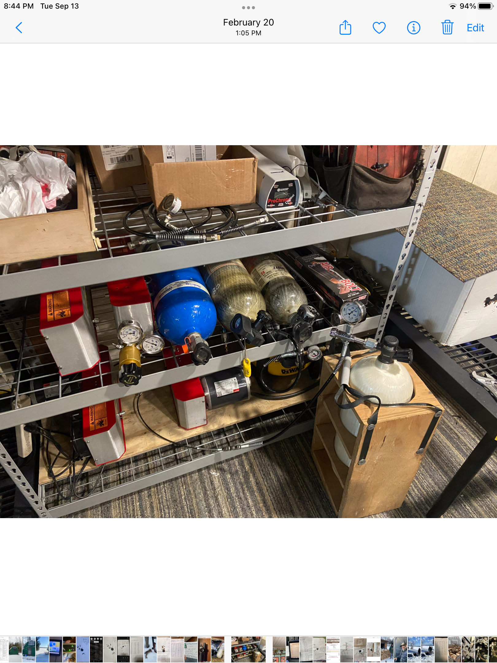

I have 4 working shoeboxes and a few parts ones. Not for sale. I use them all. I have been buying broken ones for $50 to $100 shipped. Throw up a want add for broken or unused ones. There are a lot of shooters who have one in a corner or closet that they have given up on. Maybe only need a rebuild or other easy fix. Quit often you will get spare o rings and other parts included. I fill a couple 60 min and 30 min tanks every week. With a little preventive maintenance, they are workhorses.

2 of the last ones were from here or AGN. Don’t remember with out going through my PMs. Another one was shipped to me without the motor to save on shipping. Haven’t seen a bad motor yet. Besides it’s a common one from McMasters. I drove 2 1/2 hours to pick one up from a priest that just bought a big compressor for his shooting club. The compressor was almost cheeper then the gas to get it! There are deals out there. Not every one lives on the net and wants more money than what it’s worth. eBay ruined a lot of deals. I have had a round aluminum style guide tower break at the brass rod guide. I think some one on here has the same issue. This is when I learned to reset the stroke distance. I happened to have a square C shaped one off a donner box that works fine. As for orings, I get them at McMaster Carr too. Only part that would be hard to produce is the piston spacers. Some one with a 3D could make them easy enough. Never had a bent or worn piston rod. I do buy the burst disk in quantities off eBay. as for rebuilding them. Can’t beat Tom’ videos. I have them saved on my phone for quick reference.
