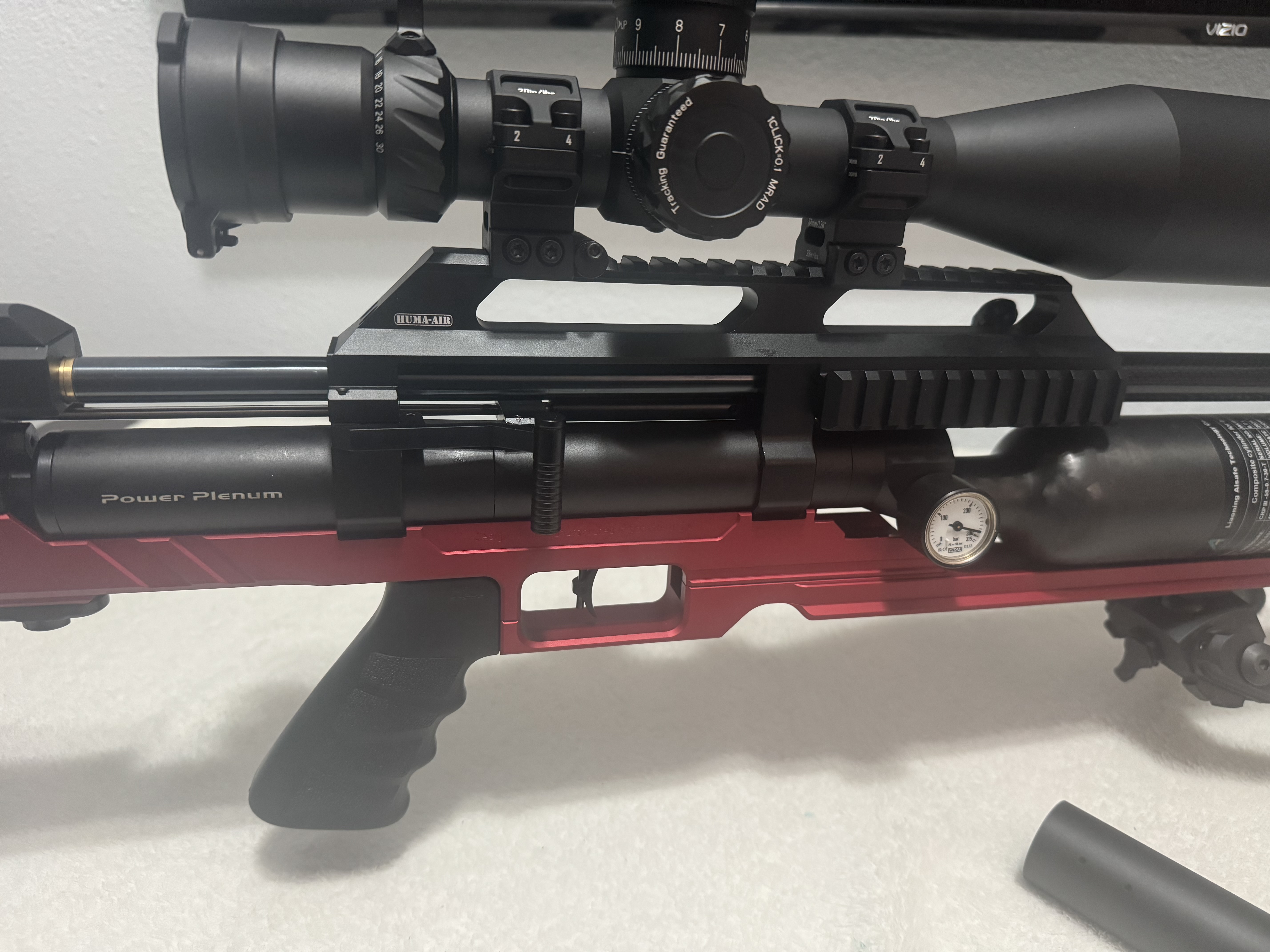

Looks like an old thread but it’s vary possible and possibly the best mod I’ve ever done

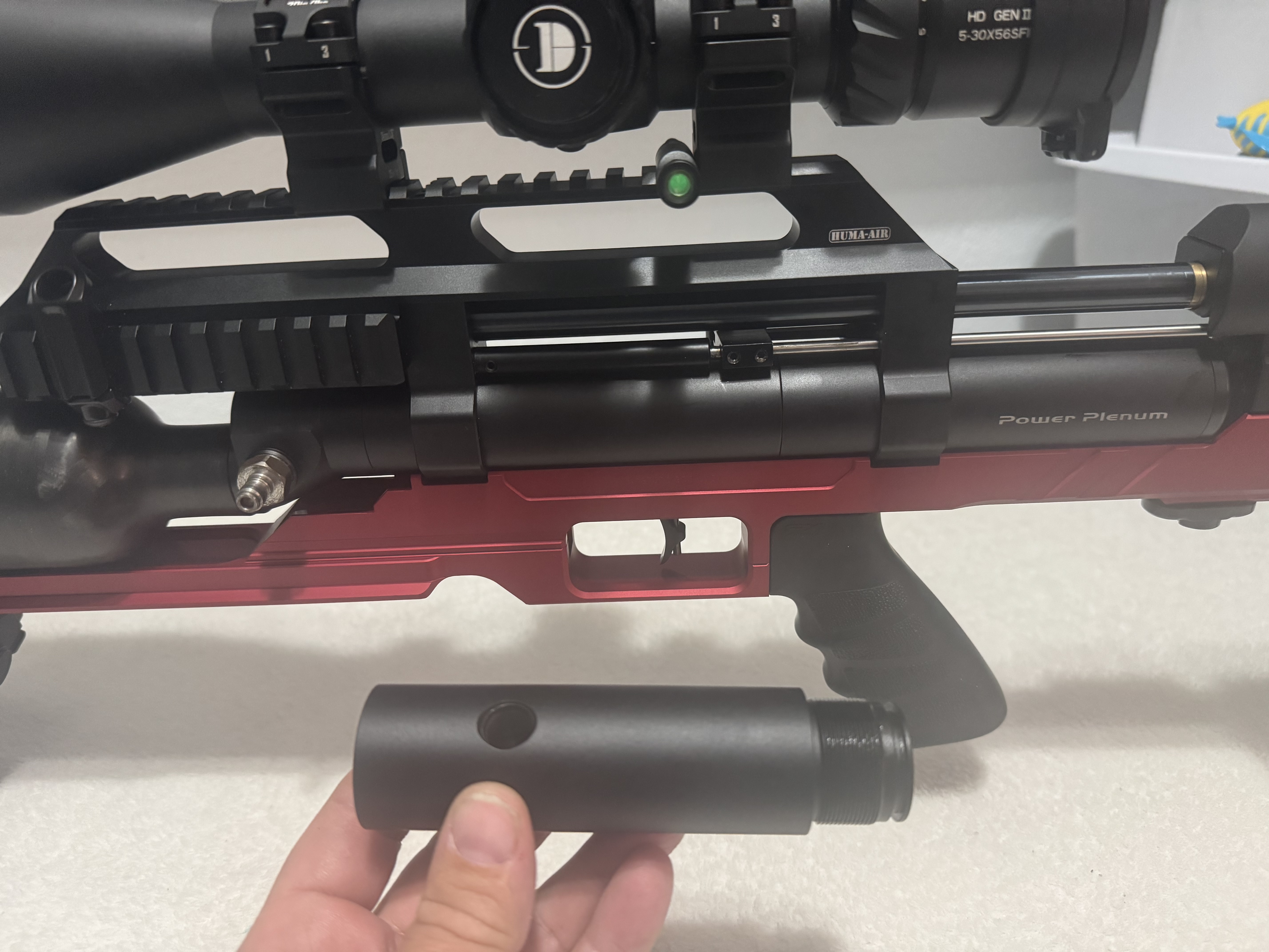

Looks like an old thread but it’s vary possible and possibly the best mod I’ve ever done View attachment 526051View attachment 526052
I ditched the 2nd reg the same way you did -- just replaced the tube section that has the 2nd reg with a stock plenum section. That was about a year and a half ago. I still smile every time I look at where the 2nd reg USED to be :)

So much easier to tune and way more efficient and I was able to get to 100fpe finally without having a 800mm barrel can’t wait to get a 800mm barrel and see what it can do

Hi herryer223. I noticed in the picture of your maverick that you are still using grub screws in the "hand" that holds it to the cocking rod. ALL maverick owners should replace the grub screws with cap-head machine screws. Cap-head screws will use the full length of the threads in the "hand" and will allow you to tighten them with a 3mm allen key so you can get them as tight as possible. Maybe where you live it's easier to find torx head rather than hex head cap screws. Either way, the grub screws don't hold nearly well enough to keep the "hand" from slipping on the cocking rod. The result is often times a bent cocking rod and a bent or broken rod guide. I was warned, but I didn't do it right away. I paid the price when the cocking rod and rod guide bent all to hell -- it sucked. I had the grub screws in as tight as I could get them and, yes -- I did have loctite on them. Ditch the grub screws. Cheers.

Thank you for the heads up I have had so many problems with that dang cocking rod to the point I machined a titanium rod to replace it I’m going to replace them that makes sense to use all the threads.
that was one of my problems with the mav trying to pull heavy springs to achieve over 100fpe I’m trying to design a better foot that will use the barrel to brace the rod thank you again
