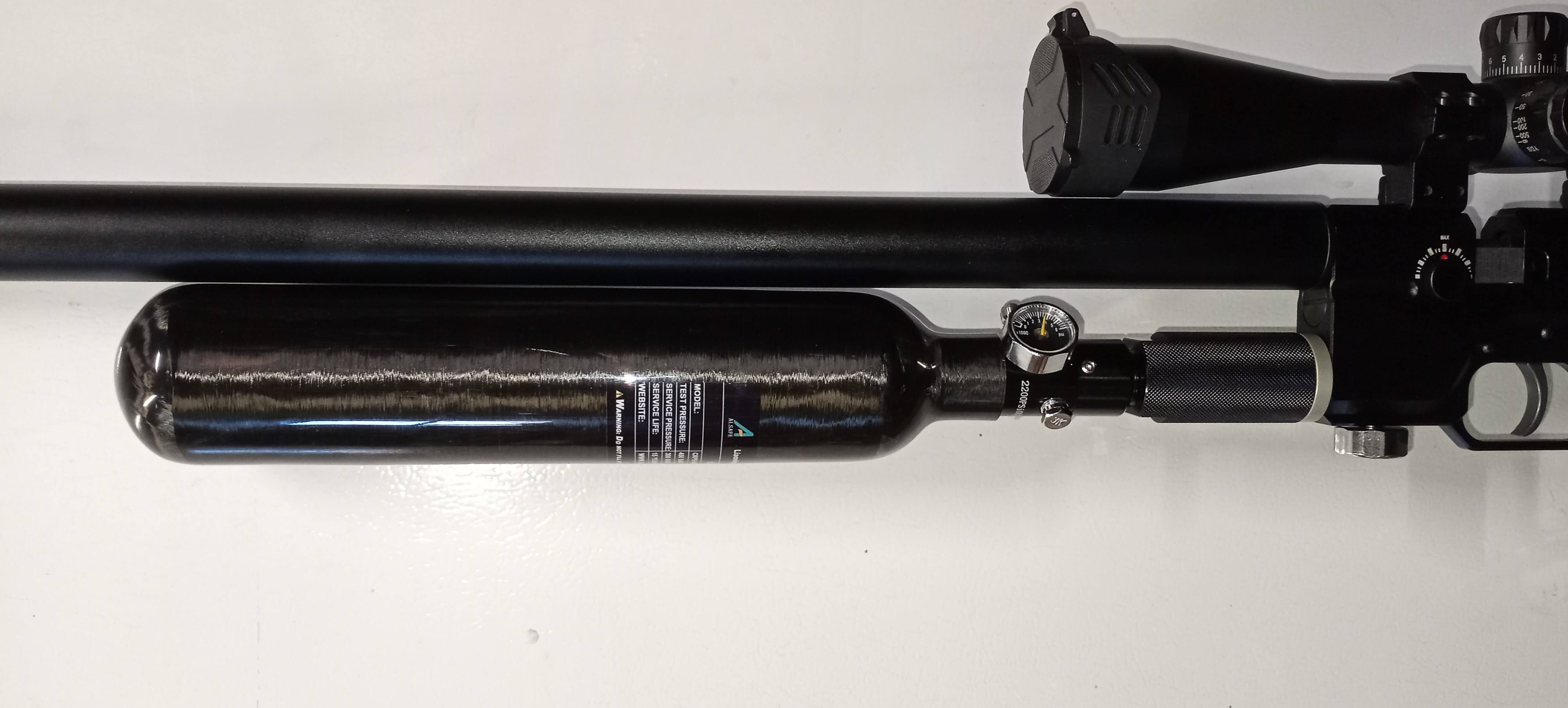

I have two AEA's, a 25 cal Backpacker HP and a 30 cal Terminator. I purchased the BP a year ago and it has been my daily carry rifle ever since. You can consistently hit shotgun shells at 50 yards. Trigger came out of the box at 5.5 lb and is now at 2.75 lb with some spring and polishing work. It is a solid made gun IMO well made.
Terminator is a real cannon. I spaced the hammer spring the other day and my 47.2 gr slugs shot at 1040 fps. Accuracy was so so until I went to a .303 diameter slug. It too is a well made gun but heavy. I have removed the original stock and front bottle and replaced with a 700 ml bottle. Lightened up some but is still much heavier than my Backpacker. Overall build is very good, fit and finish is fine.

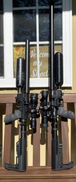

Never had a funner or cheaper gun to shoot! The Carbine on the left just loves CPHP's, 2 MOA at 50y with the short barrel, semi auto, 12 shots per magazine, the perfect critter-getter!
The Varmint on the right now wears a cheap-o chi-com plenum and regulator and eats JSB 33.9gr .25 pellets and easily does 1MOA at 50y and once I get a warm day with no wind (a man can dream, right?) Ill see if it holds 1MOA at 100y as well.
I also have a 9mm Challanger, its ugly, used and scarred but it delivers 300 fpe and will cloverleaf groups at 50y.
Bottom line: I had to work on all three of my AEA guns, if you dont tinker or get all indignant about having to tweak a gun out of the box, these are not the guns for you. If you are like me and the journey is the thrill, not the destination, these are a fantastic value for what you get.
