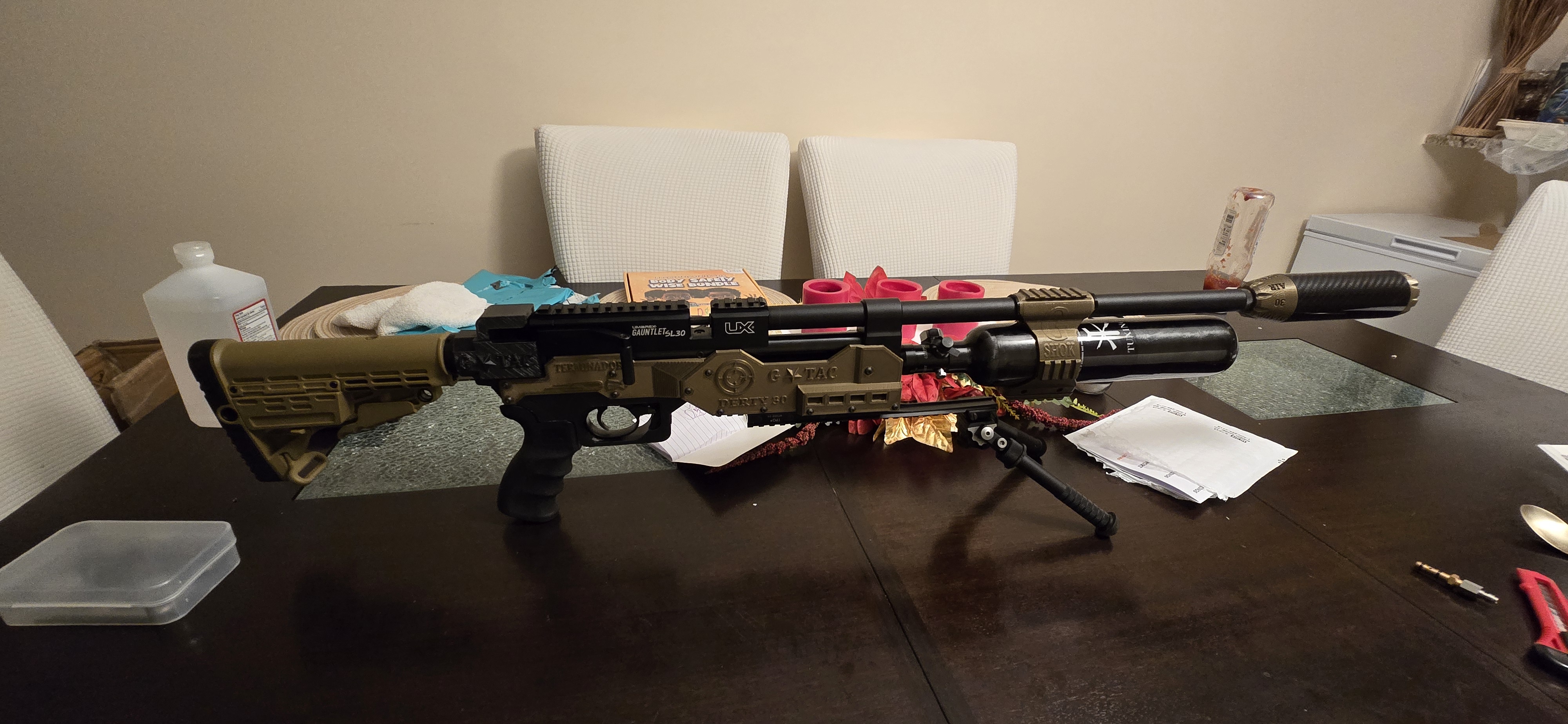

My gauntlet 30 at 92 is quieter than my both of my Uragan 2's

I hear you. This was working okay for a 115fpe it was putting out before the barrel chop, but at the 92 foot-pounds that it's currently shooting. It's working extremely well.
