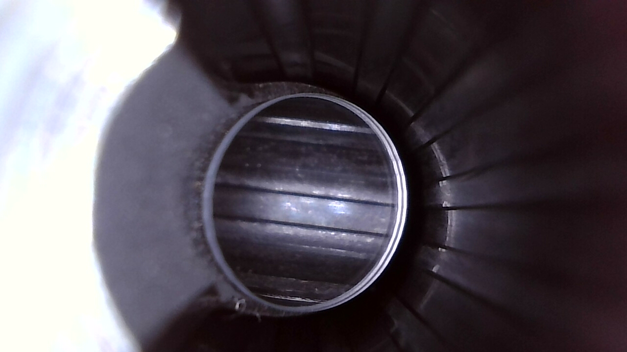

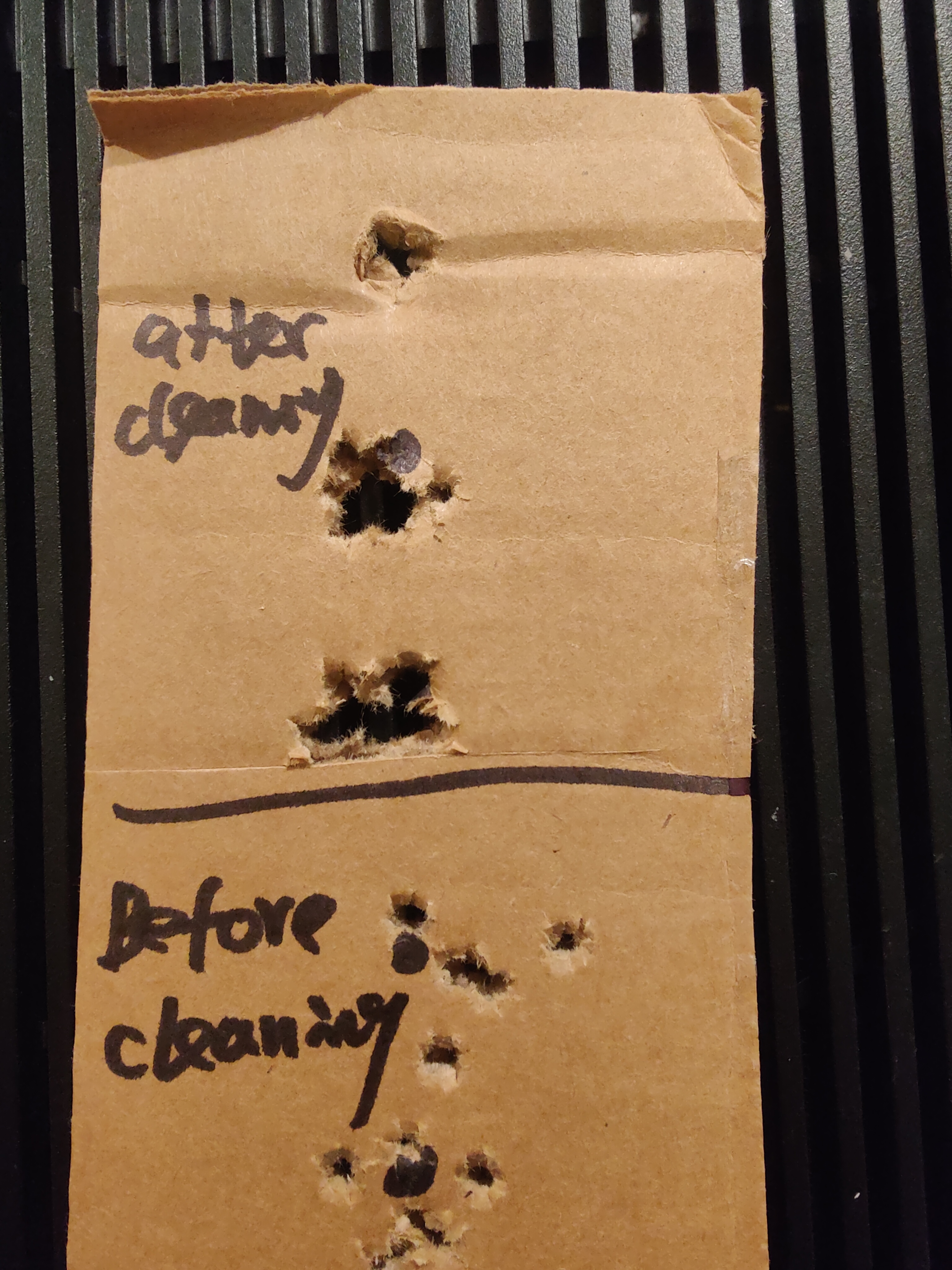

Is barrel cleaning overrated? I'd say no! My Notos is tuned to shoot just shy of 22 fpe after a tin and half of pellets my group went south. After a through cleaning accuracy came back.
The bore looks ok but it does have some rough spots. A lapping and polishing job next?
Not sure I buy that dramatic a result after a tin and a half of pellets. Any chance your focus and confidence improved as a result of doing something you believe would have a positive effect?
Not at all! I practiced 10 meters air pistol for several years, recent days I'll send at least 60 shots downrange every day I know when the barrel is acting up.

A tin and a half is not many pellets, but there could be a rough crown, or "chamber", or transfer port edge that might account for the degradation in performance. So, it may not have been caused by what looks like a pretty good barrel in that bore scope view, that caused the trouble.
A bore lap/polish may also improve the crown or TP, but it might be a good idea to take a look at those areas to see if they need specific intervention, first. If the crown is bad, polishing just the bore is not likely to help. Not that I am advocating for "polishing" the crown in any way that would cause it to bell or flare towards the front. But, if there is a burr, that should be removed first. Even with a round headed brass screw in a drill, using and lapping compound.
If the lands are heavily scored from a poor crowning job, lopping of the damaged section at the muzzle and re-crowning might be indicated. See this thread for details:
