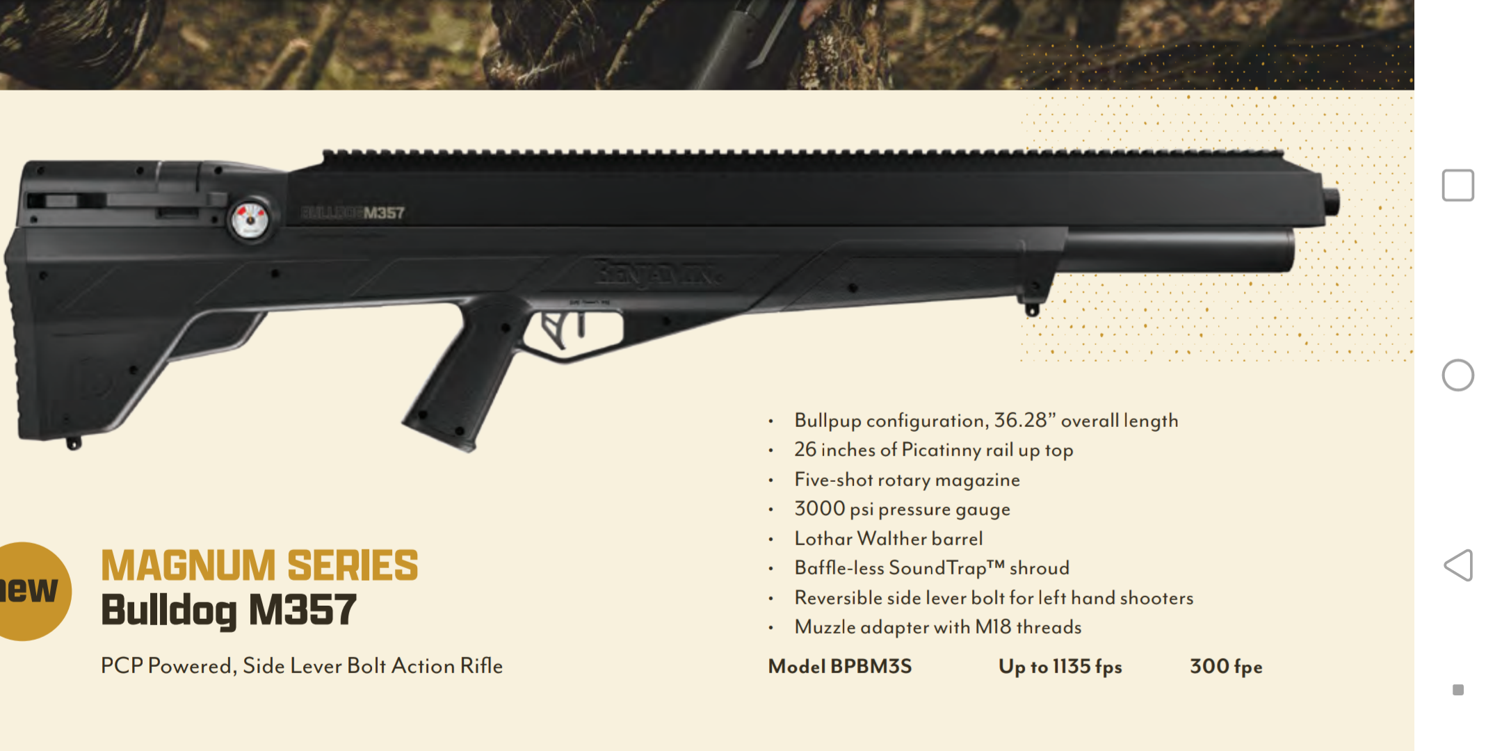

They also updated the .357 model... saying that it will now produce "300fpe" and shoot 1135fps! Which in my opinion will be too fast to be shooting the 81 grain JSB (which the current Bulldog loves around 950fps).
So the new .357 will have enough power to meet 215fpe Texas hunting Minimum power requirement, and now that it makes 300fpe from the factory and has a larger air tube... just like the Tuners have been adding, ie Pitbull airguns, Veradium, etc.
Crosman knows what they are doing... they let the Tuners R&D all these years, then just copied what they where doing, basically making those people obsolete. Airforce did the same thing with their Condor SS rifle and Talon SS silencer kit, just copied what the aftermarket was doing. Smart

I just hope that they .. Benjamin brand . have been reading all long this years about the 257 .. and design the gun around the 257-420 and make the lathe accordingly..and not end with a lathe to shoot 120gr that will make the rifle useless.. is not a miracle that the 357 bulldog performance is better in the 145gr and up . Is because the lathe is to deep.. making most light and short bullets inaccurate..
@WarriorPoet I thought something similar. See posts #7 & #8 here. https://www.airgunnation.com/threads/magnum-m357-bulldog.1285973/
