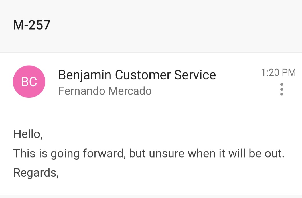

Is Benjamin too late to the party coming out with a .257 Bulldog?
