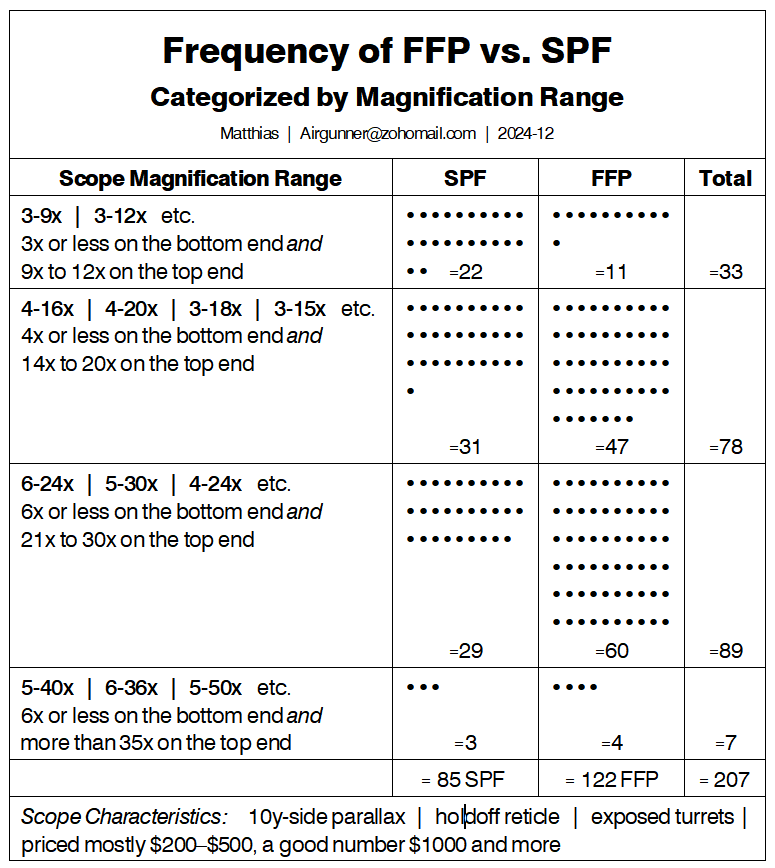

Another thread noted a trend toward FFP — so I started wondering — and ended up counting.... 😆
I used my 3 Scope Specs Tables, with the specs of 200+ scopes particularly suitable for airgunning:
I found about 40% are SFP and 60% are FFP.
However, between the magnification ranges there are large differences:
🔸 In lower magnification ranges (3-12x / 3-9x) there are twice as many SFP.
🔸 In the higher ranges (6-24x / 5-30x) it's the other way around!
🔸 In the middle magnification range (4-16x / 3-18x / 4-20x) it's 40% SFP, 60% FFP.
Cf. the table below for details! 😊
❓Your comments?
❓Is that a good development or not — for airgunning?
❓What would you like to see manufacturers offer?
Matthias
Characteristics of the surveyed scopes:
▪10y side parallax
▪exposed turrets
▪holdoff reticle
▪cost between $200 and $500 with a few for $1000+
Scope Survey of FFP + SFP. Frequency of FFP vs. SPF – Categorized by Magnification Range.png
