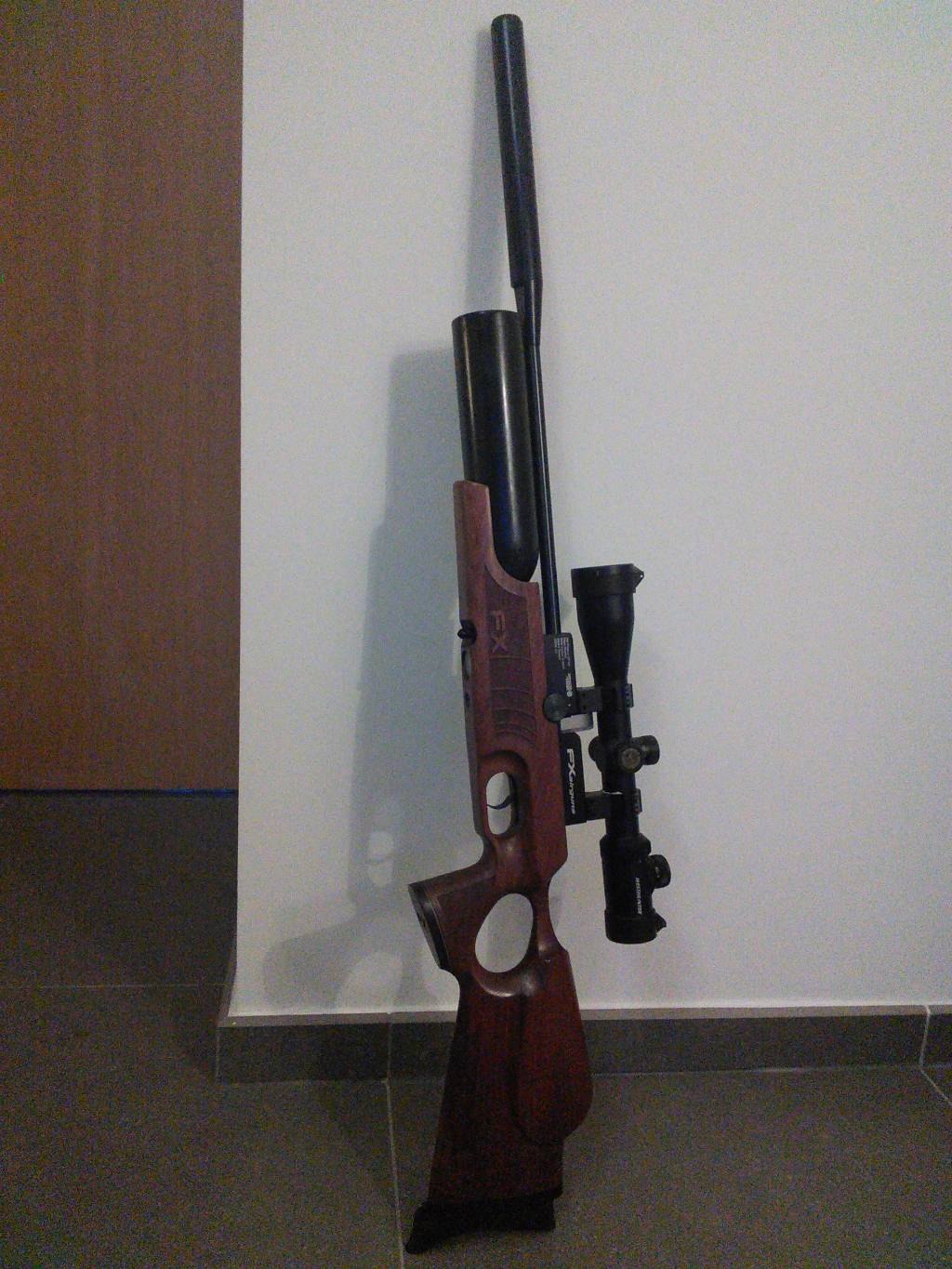

Also have this in mind: some guns manufactures have designed a barrel around specific pellet, and the gun is pretty accurate for that pellet, I'm talking about the JSBs.
Then comes the Iguana Hunter and tries a hunting pellet on one of those guns, and bahh, not accurate enough!
I've found that the CZ and LW barrels to be really good at shooting well a good variety of pellets (and slugs), for my application that's what is working right now.
