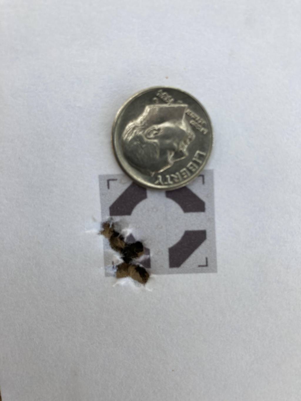

I’d say they are very accurate guns but then so are many other brands. The CA State FT was my second FT match, and I shot a .177 FX Crown with an older solid FX ST barrel. Of course I wasn’t in contention, but in no way was it the fault of the gun. Shooting 13.43 gr. JSB RD Monsters at 820 FPS, the below is a typical 6 shot group at 50 yards.
