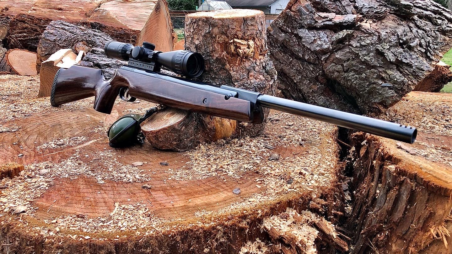

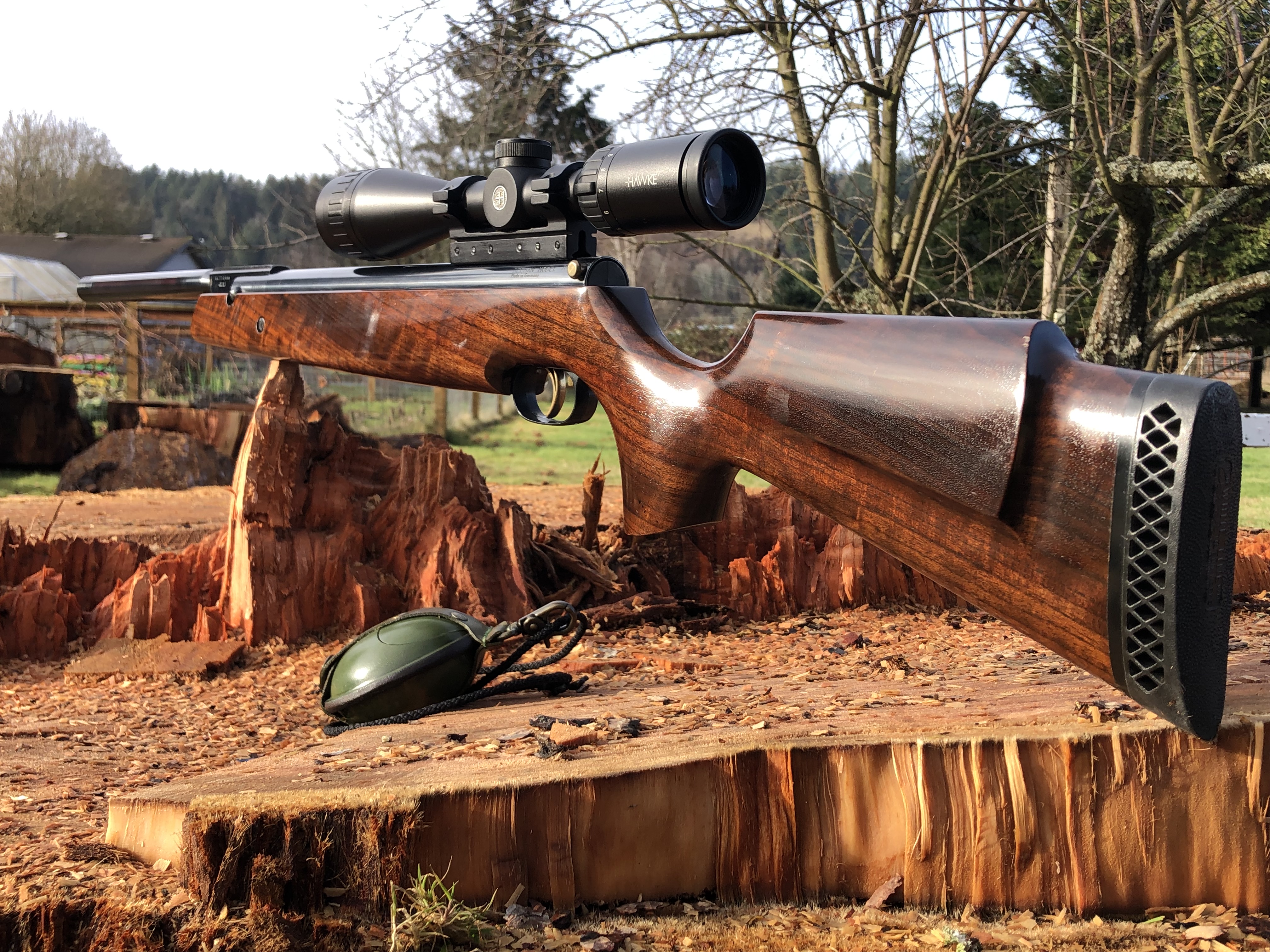

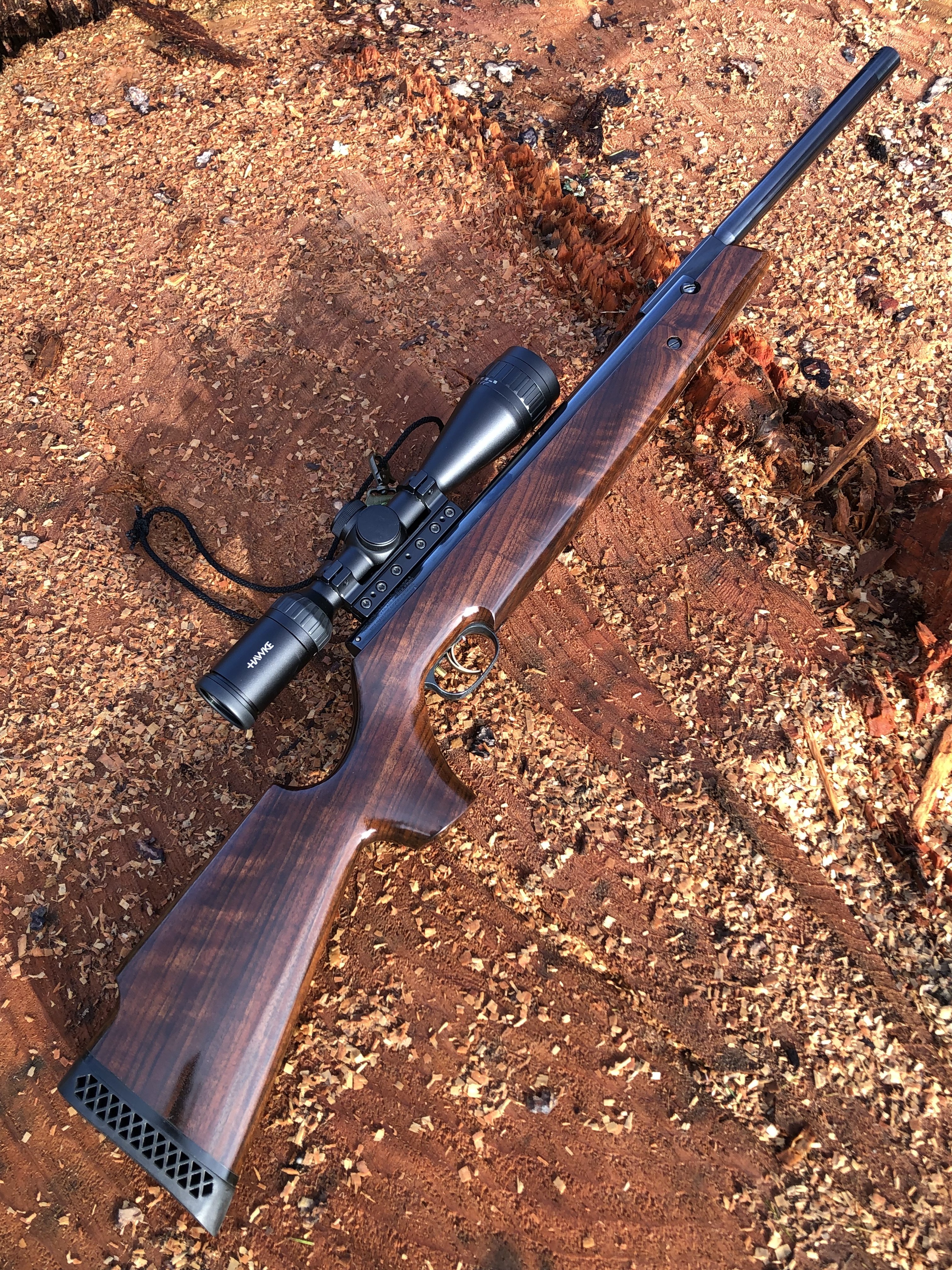

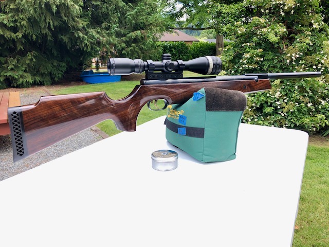

View attachment 490439View attachment 490440View attachment 490441View attachment 490438

Well, the R9 pictured above has the chopped barrel on it. It’s only slightly increased cocking pressure compared to the “long” barreled version. The 30s are so easy to cock already that the pressure needed is not really an issue for me. It may be a real issue for some to consider so there is that…
