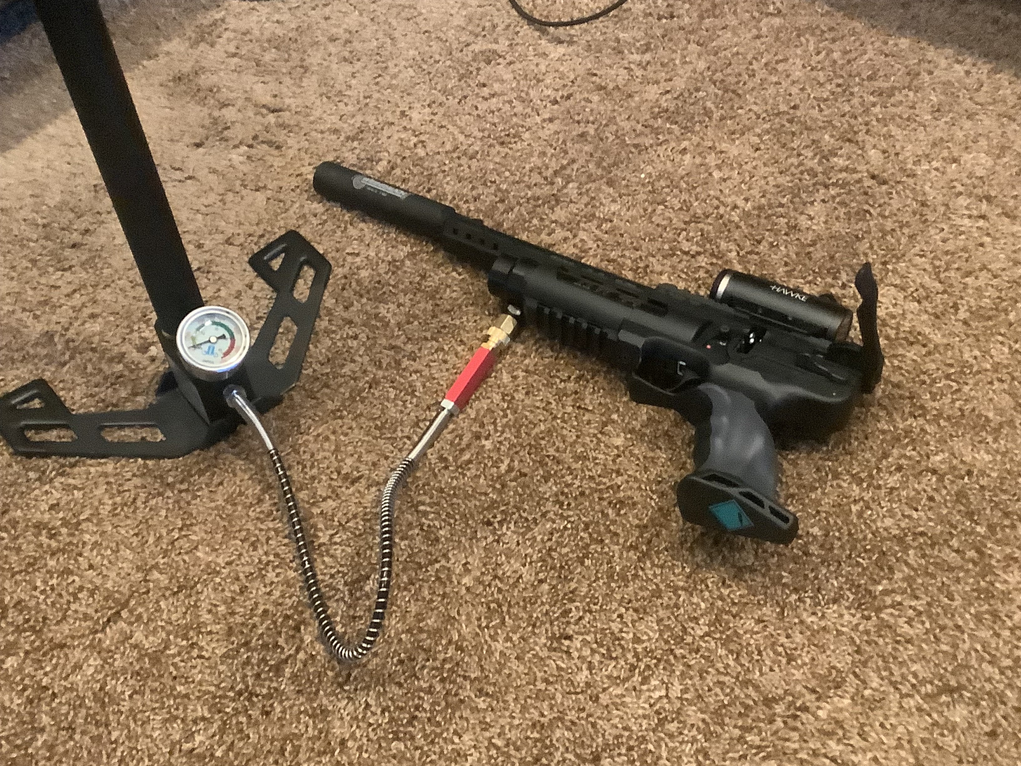

Is it me? Or does it not work?
Just got this Vevor pump.
shot the pistol into the yellow zone to test the pump.
After 100 pumps nothing changes on the gun or pump gauge.
Pump looks to be undamaged and In perfect condition.
Am I missing something?

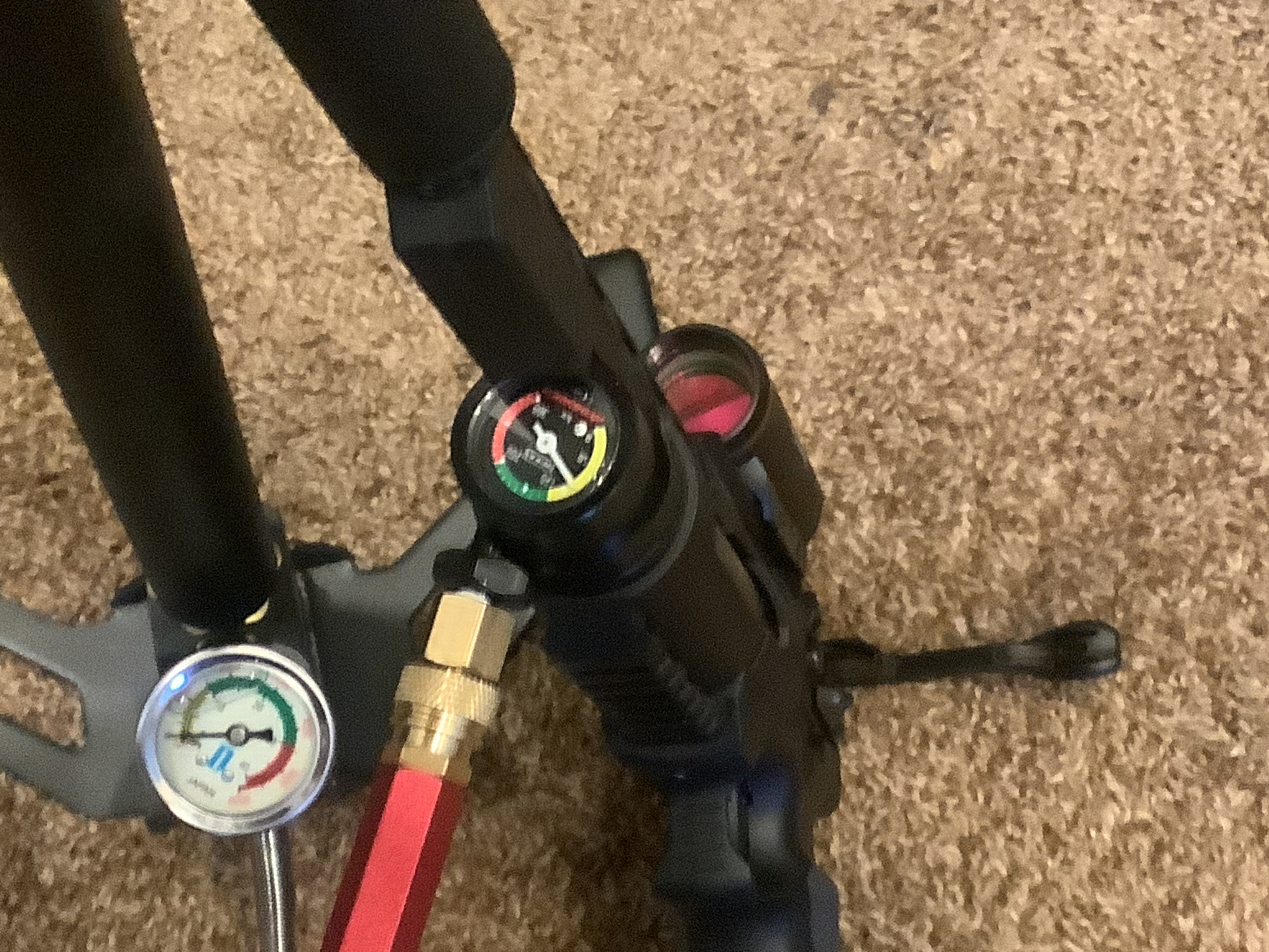

Are you talking about the pressure difference between the pump and the gun ?
Yes, they can...be correct as shown !
1 - If you just plugged in the pump, without doing any pumping.
2 - If you pumped a little pressure and released the pressure in the pump.
Air is NOT supposed to escape the guns air cylinder to equalize the two gauges...unless you are "currently" pumping pressure...right ?

UPDATE!
I see 3 connections.
The gauge
Ths hose
The pump connection to the base
I put Teflon tape on all.
The gauge on the pump now moves while pumping but slowly drifts to zero when I stop pumping.
The gauge on the gun actually DID show a little pressure increase however. Shouldn't the pump gauge remain steady until pressure is released?
The 3 connections can’t be any tighter.
Thanks
No, test plug, as pictured. Check in spare parts box that came with pump, hopefully you got one. If so, plug female end of fill whip and pressurize pump. If all works well, problem is in connection or airgun. WM
BINGO!!
YES? found the test plug in the box of parts.
Pressure held which (like you said) pointed away from the pump.
Turn out I needed Teflon on the quick connect/probe fitting.
