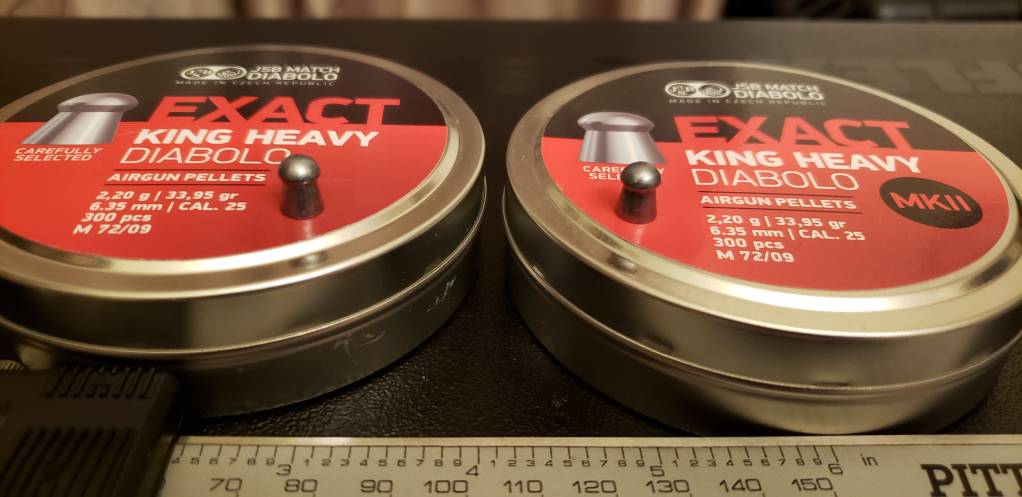

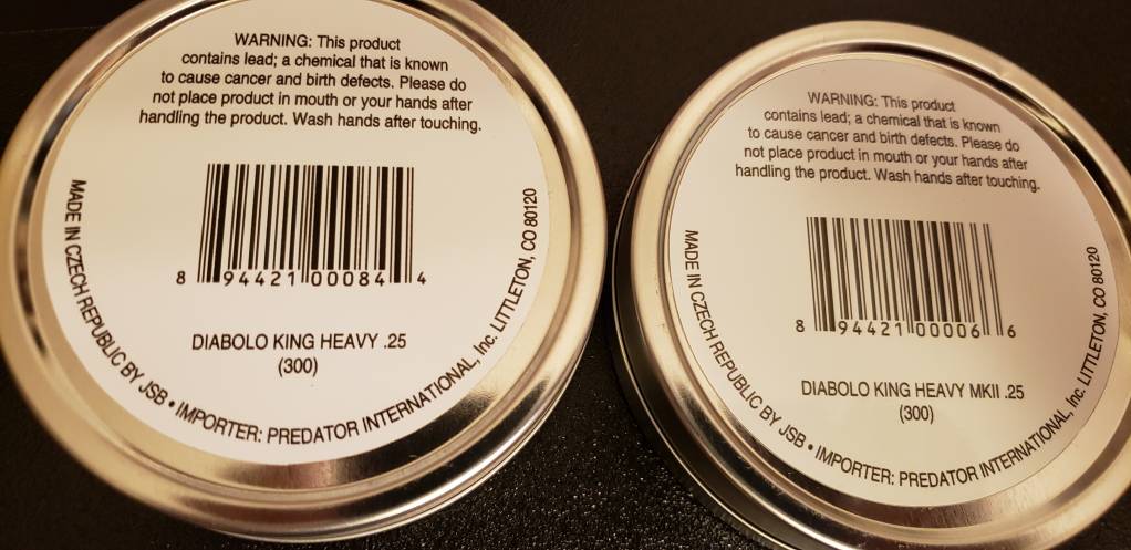

Centercut. This post originated in 2020 so they can’t keep making the same innocent mistake. They are selling MK2 in the MK1 tin
I’m returning my 10 tins. And I shot this today.

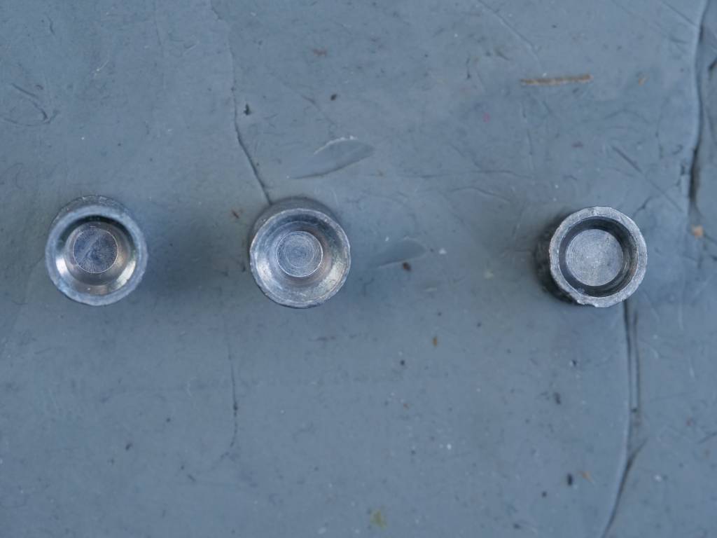

L to R: MK1 (circa 2019), MK1 (2020 after sending back order to get the “right” pellets); and last week’s MK1. Sure looks different from the other two, no?

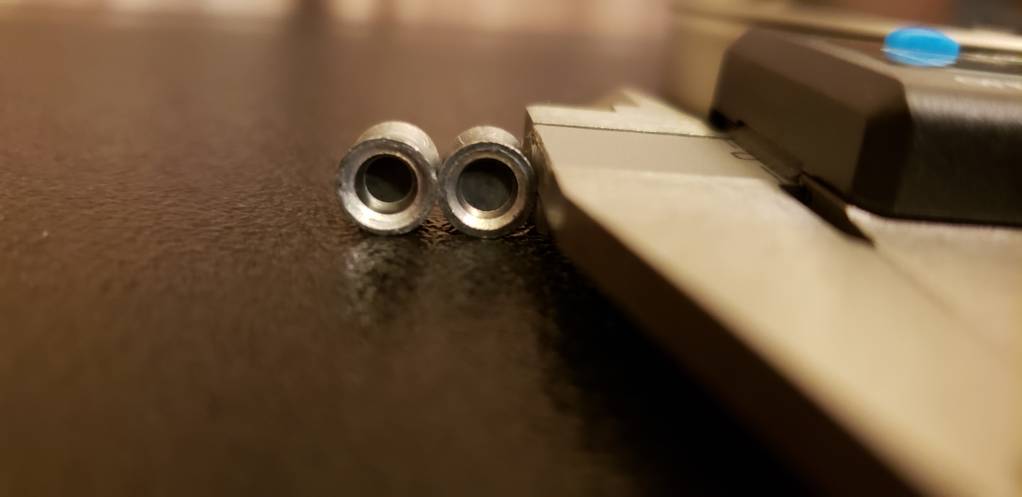

The note from JSB is part of the Big Lie. The “Mk1” I got had the EXACT same skirt OD as the Mk2s. I bought 4 tins of each. Returned the fake Mk1s to PA. I encourage everyone that receives Mk2 in a Mk1 tin to return them. But first measure the skirt OD. They will be 6.60 vice the 6.68 that they should be.
The lie continues. Keep returning your pellets. The accuracy difference in polygonal barrels is night and day.
