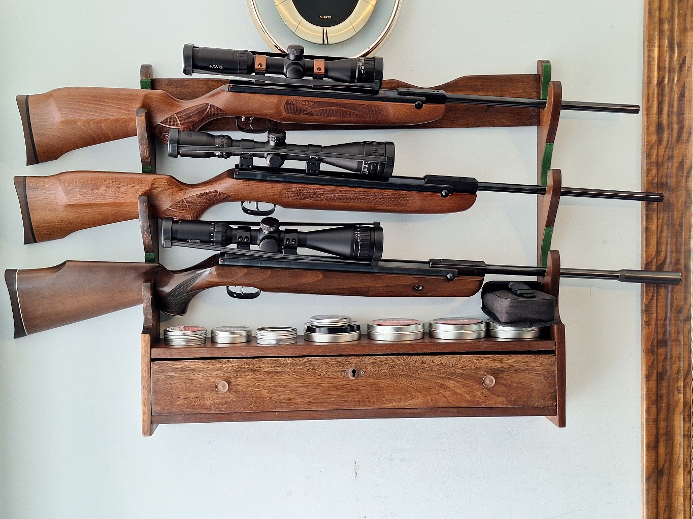

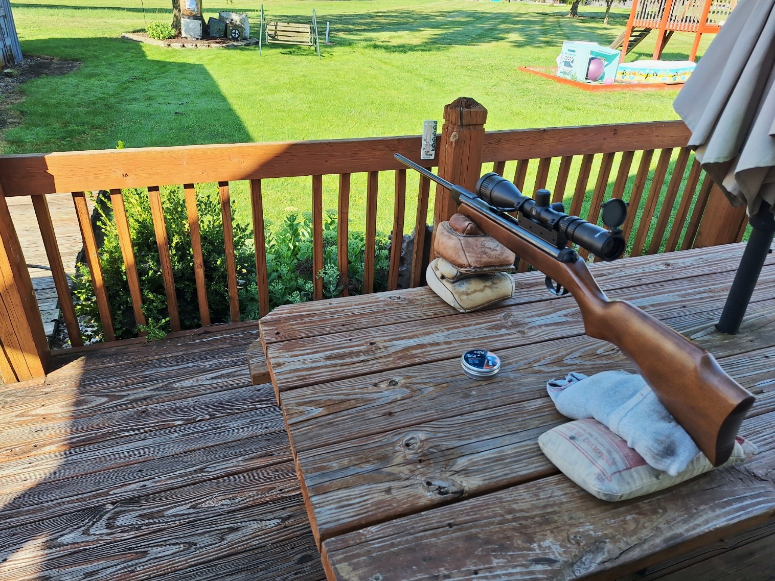

Diana Is my Diana 34 worthy of a scope?

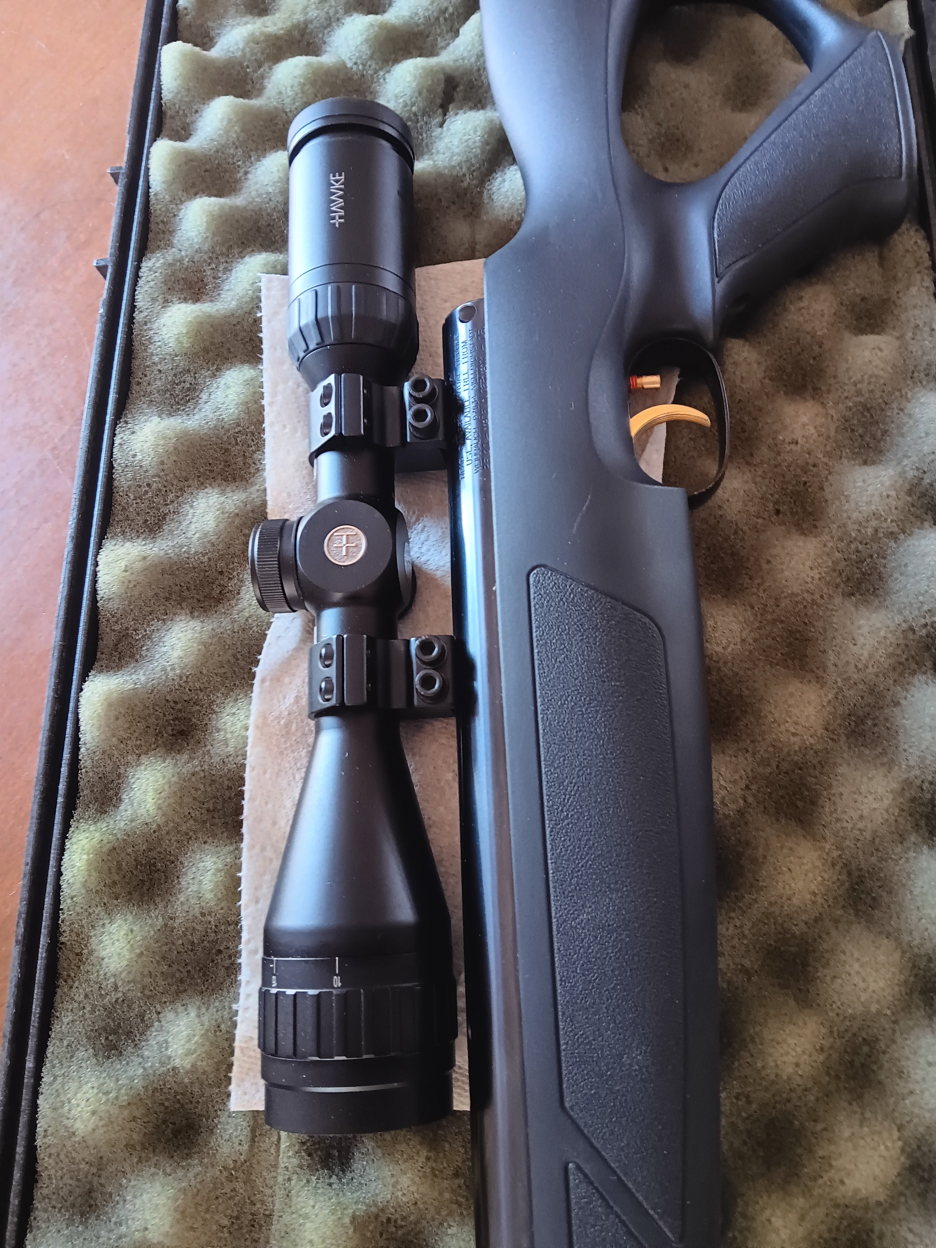

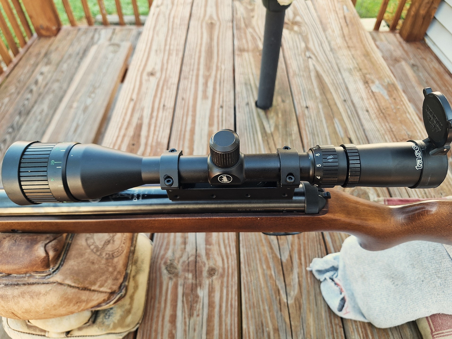

Here is how I mount mine.
HW97k. 40mm Hawke Airmax. Medium Sportsmatch 4 screw rings. Rock solid. Never a slip in 5k shots. Wicked accurate.
HW95. 32mm Hawke Vantage fixed 4x. Low Sportsmatch rings. I had to cut the lens covers to get them on the objective bell. Never an issue with scope slip. 6-8 k shots.
Low is how we're rollin'.
Notice I get the rings as far apart as practical.
The 95 has perfect cheek weld. The 97 is just a fraction too high but still very nice. Anything over a 40 mm objective on these rifles would benefit from a cheek rest.

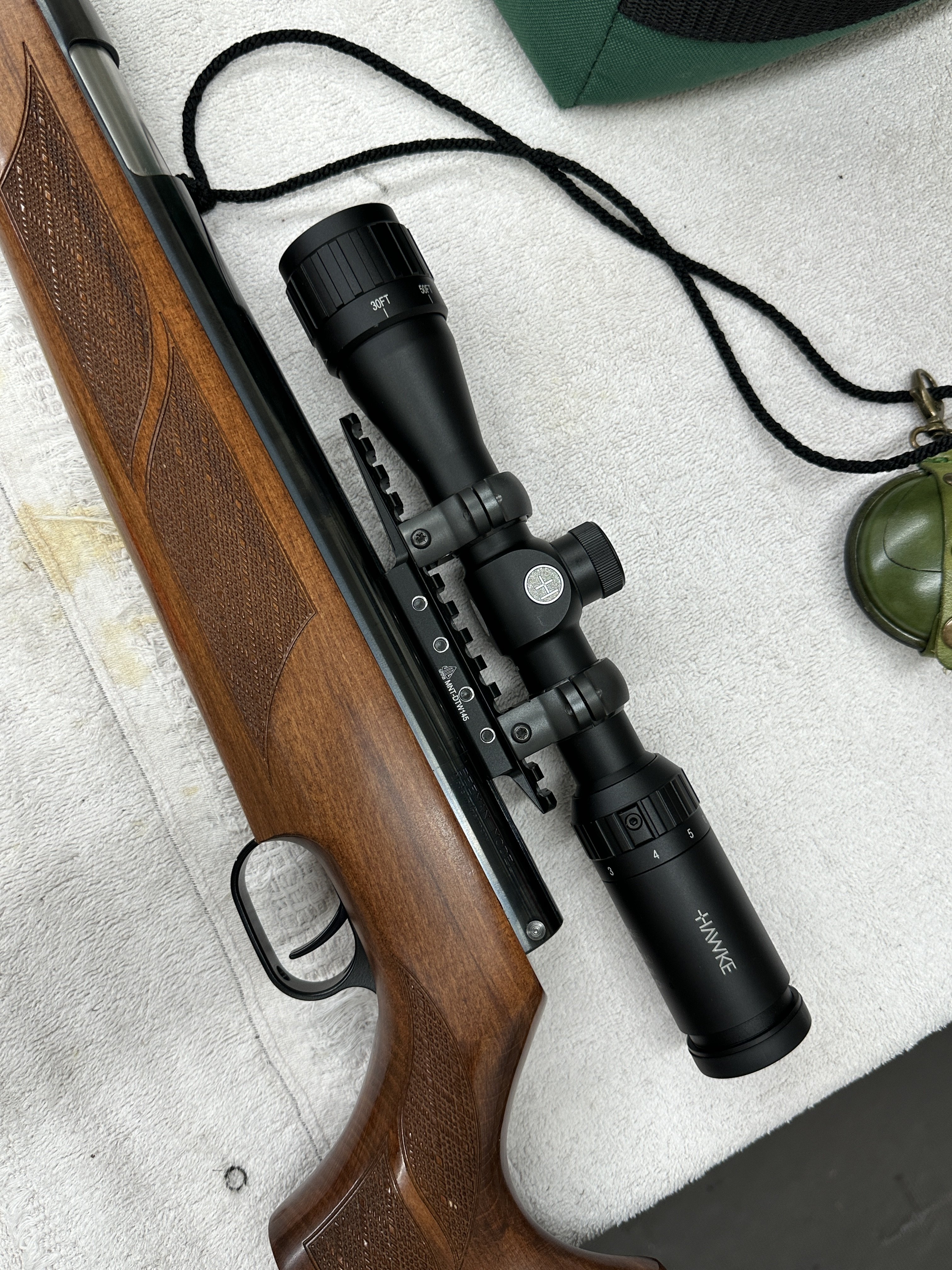

I used to mount mine like that as low as possible, and I also had to cut the bottom of the front scope cap. The sports match rings are top notch.
I switched to the pic rail which is like .560 high with low rings. I think the added height helps my long shots in my mind, at least I do hit better at longer distances, or it seems easier to hit longer distances than the low mount for me.
Low mount does look better though.

As long as it's comfortable to shoot and holds tight I guess it's just personal preference.
The Pic rails are a great system. I sure like them better than a dovetail mount. I have them on all my high power rifles. And as we discussed the Hatsans....
I used to use those pic adapter to dovetail things,
and they did work, but not ideal set up. With the pic rail I have the stop pin in a bushing that fits the receiver hole with a snug slip fit, so it isn't going anywhere. Then of course the pic rings have that cross bar that lock into the rail.
I don't get a cheek weld like when shooting a PB,
I get real close but never really touching the stock, and if I do it's feather light. I tend to throw wild shots if I put my cheek on the stock..lol..

I'm the opposite! When I mount the gun I push it down into place with my cheek. I get it on my shoulder by registering the rifle with cheek pressure. Then pull it hard into my shoulder. Then relax.
If I don't take all the slack out of the butt it runs into my shoulder and the gun jumps. I use my cheek to push it in place. I like a good solid cheek weld and a light butt pressure.

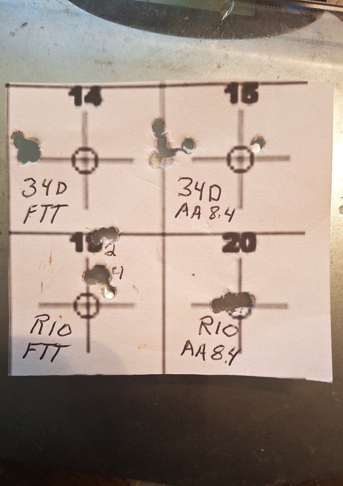

At 25 yards before I sighted it in, compared to my Tuned Beeman R10 makes a statement, the AA target with the shot to the right was me, not ready to shoot. But the targets tell the story, mounted properly, it should make you smile. All stock factory with a Votek PG4-HO spring I installed!
My weihraucks don't need the droop compensating mounts, and all are direct ring to dovetail mounted..
But all my Diana's do to keep the zero in the center of my adjustment zone, which is the best setup for any scope. Diana's are different when it comes to scope mounting. I have never bent a barrel, and mine as accurate as any gun I own, in fact the 54 is the most accurate and hardest hitting air rifle I have, fixed barrel, and needed the droop compensating mount!

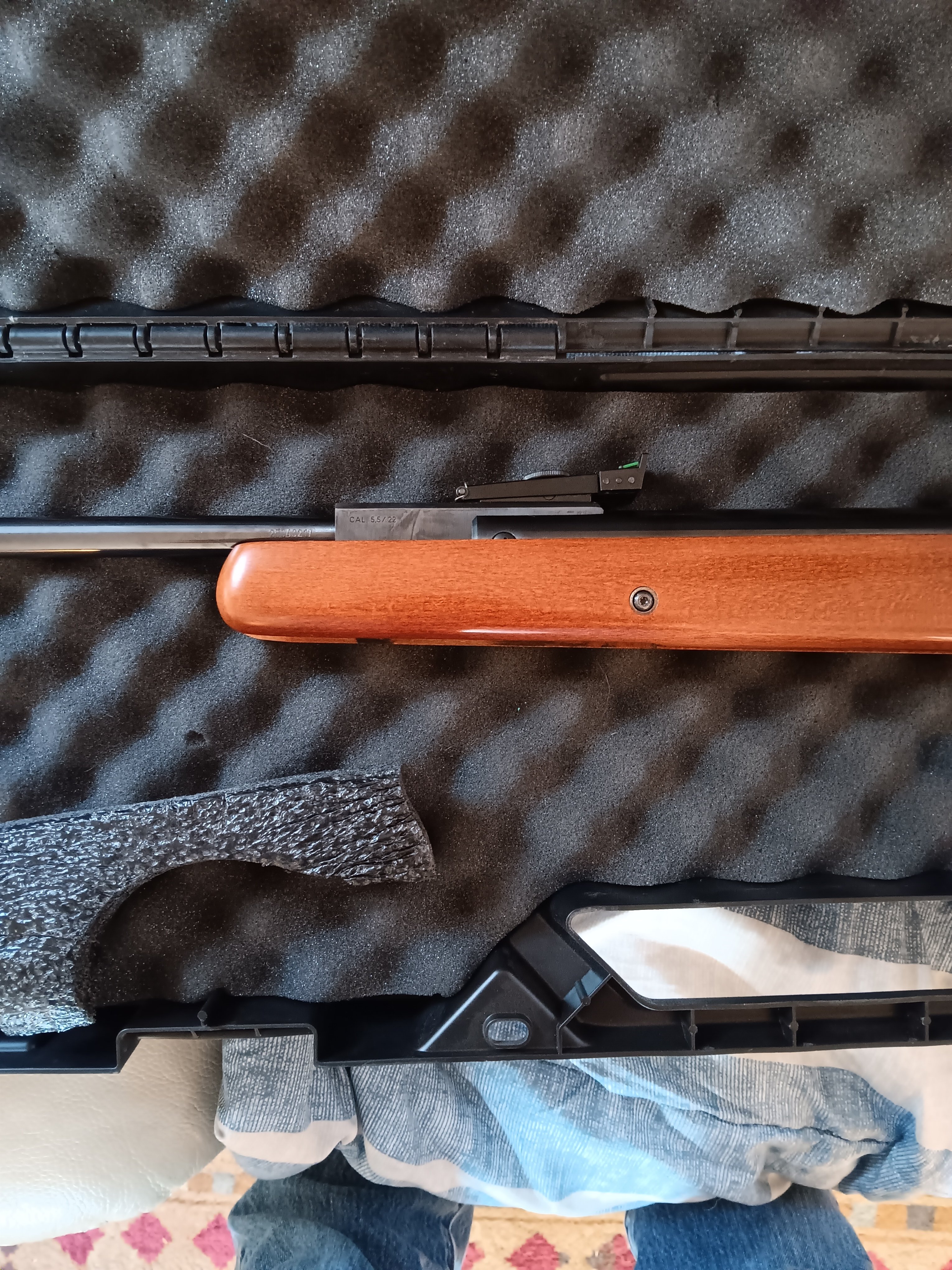

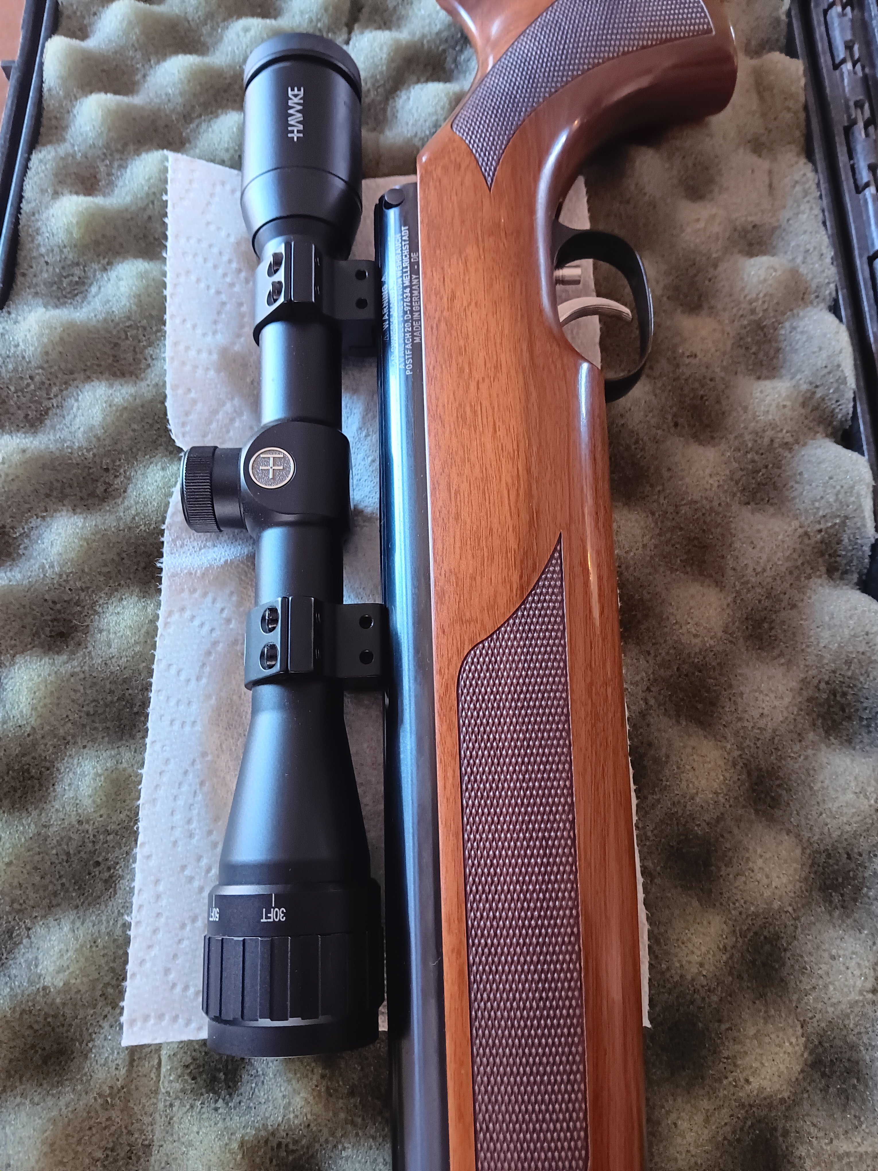

I noticed on @Wildcatter D34 rifle as well as the OP's that the forestocks have been shortened. Chopped off in front of the pivot.
That's a pretty popular mod for a D34. I'm seriously considering it with mine. It's a finger pincher for sure having that wood out in front of the pivot.
I also notice how far rearward @Wildcatter scopes are mounted. Especially on the D54. It is inches farther rearward than anything ive ever seen. Compare it to @beerthief rifle as well as the two I posted.
I'm wondering about eye relief. Either those scopes have an incredibly close eye relief or the owners hold is WAY different. Or both.
Check out where the eyepiece is in relation to the trigger. It seems to vary considerably on the guns on the rack. And the D54 is pretty extreme. It's WAY back there.
Most scopes are mounted more or less where the first knuckle on the thumb of the trigger hand rests. These are all way behind that point.
Just wondering about it and why...
I believe the shorter forestocks were part of the earlier design. My D34 has definitely not been modified…it’s just the stock design from 1998.

At 25 yards before I sighted it in, compared to my Tuned Beeman R10 makes a statement, the AA target with the shot to the right was me, not ready to shoot. But the targets tell the story, mounted properly, it should make you smile. All stock factory with a Votek PG4-HO spring I installed! View attachment 491432
That may be. It sure looks like it was cut down. I honestly don't know.
Check out @Wildcatter 's forend. Definitely cut back.
Mine was manufactured in 2017. Look at the difference!

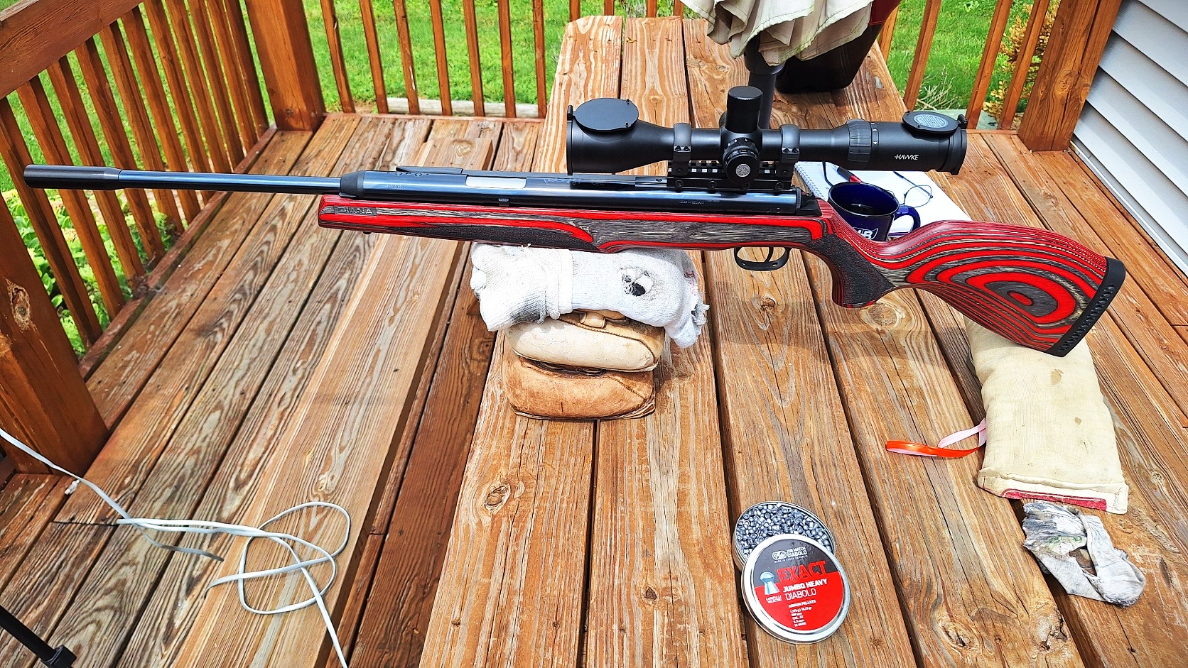

Like I have said in several posts, Unlike Many Here, I don't make statements I have no hands on wit. It is exactly what I stated it was, and my stock is definitely not cut back, nor did it ever come with a but plate! This is exactly how it came from the German factory, it is an early T05 trigger version of the model 34, nothing special, bone stock except for the PG4-HO spring and Vortek seal.
I will also state that the stock has absolutely nothing to do with the fact that most diana rifles have barrel droop, directly from the factory. I will say some with the later version stock, or many, were from CHINA, and those I have no history with. Not certain but I believe the 2017 models were being made in China? I make no uncertain claim to that being fact, but it is from the era when Diana was cheapening some of their lower tier rifles to compete with the lower tier priced rifles.
I also stand by my statement about them delivering exceptional accuracy, maybe only from the era before being made overseas, again, I have no experience with these newer rifles other than my 54 AKP, their premier model. But today I think they are now being made by new ownership, this could be good, but we've seen many instances of new owners of well established products, being all about making money off of an established name, while they strive to cut more cost and more corners with only short term profits as their goal! Hopefully we don't see this with the Diana name. Only time will tell!
