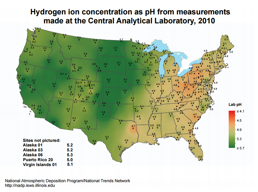

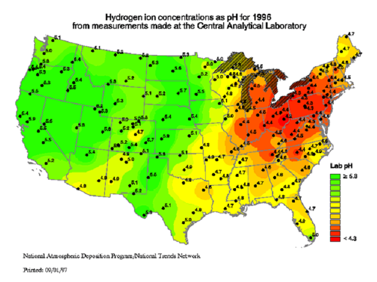

Thanks to the environ-mentalists we have reduced acid rain tremendously, obviously it is still not eliminated. Sadly I can't find more update to date map but I'm hoping it's even less yellow and red. The map shows rain water acidity level across the country.
A map from 1996 for comparison:

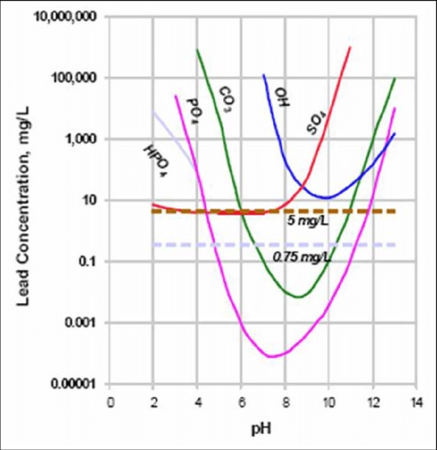

Here is how acid level affects lead and lead oxide:
Lead/lead oxide/PO(pink line) is basically insoluble at PH of 6-9 or close to dark green area. But PO will become exponentially more water soluble at PH of 5 and lower or tan to red on the map. Obviously a few pellets here and there won't do much, a few pounds of small lead pieces(large contact area) over the years could be a problem. Everyone can order a kit to measure lead and other heavy metals in your drinking water, I recommend everyone test their water for just for a piece of mind especially if you are drinking ground water near any sort of industrial activities. We have the technology, what you do with it is up to you.
