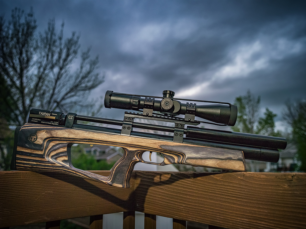

Taipan Veteran Standard .22. Between the EXTREMELY adjustable, perfect trigger and the superior accuracy, whisper quiet and history of reliability, don't know what more you'd need.
It is a little heavy, but other than that, pure excellence.
I might eventually get an RTI Prophet, just because, but I don't think it will be any more accurate or fun to shoot than the Veteran.
