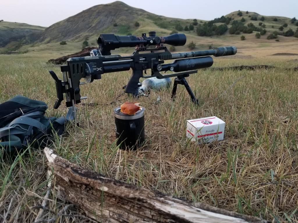

My M3 had its first hunting trip this weekend to a friend’s orchard that is overrun with ground squirrels. First time hunting with the M3 and also the first time I’ve hunted with slugs out of a PCP. Both were great. The M3 shot fine all day going from 68F early in the morning to 105F in the afternoon, no issues at all with velocity changes or zero shift over the day—it just kept delivering hit after hit. Connected with several squirrels at 110-125Y and lots in the 80-100Y range. Slugs felt like an “easy button” in the breeze on the long shots compared to my previous R5M using JSB .25 34 grain pellets, and the slugs hit the squirrels hard. I’m sold on slugs for longer range hunting use even if they did take a lot more tuning for accuracy compared to pellets. The M3 was comfy to shoot all day, ergonomics were good. I ended up changing to a Magpul K2 grip as I wanted a more vertical grip angle than the stock FX grip; had to slightly sand the back of the tang on the K2 grip so it would clear the plenum and the grip could seat all the way but now it fits perfect. The M3 balanced quite well clamped onto the tripod with the K&L extended arca rail.
Only glitch was that near the end of the day the trigger started to lose the second stage on about 50% of the shots; sometimes it would fire before stopping on the second stage “wall.” A bit surprising the first time it happened. Easy fix though, adjusted the second stage ball detent screw in about ¼ turn and back to a reliable second stage.
Didn’t want to go home as there were still squirrels running everywhere, but ran out of slugs by about 4pm. Crap! Nielsen is ready to go after their move but is waiting on shipments of lead wire, but I need more slugs for this coming weekend. The only place with the slugs I needed was Krale in the Netherlands so I ordered 4 boxes and paid the $30 UPS international express shipping to keep me going a couple more weekends until Nielsen is back up and running. I have the R5M and JSB 33.4’s to fall back on… but after shooting the M3 with slugs yesterday I want to keep shooting it!
At this point I’m willing to put aside my concerns about parts count, o-rings, and durability because it shoots so well… It appears to be a keeper. I may revise that statement if and when something goes wrong (or until I knock the barrel into a tree branch accidentally and tweak something) but I’m hoping it will be a reliable rifle because it shoots great.

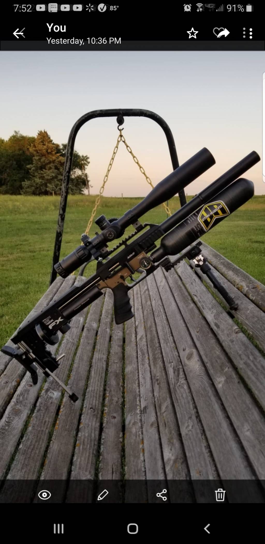

This .22 with a 580 cc tank and a 500mm superior liner. It stacks 20.2 grain slugs with such precision and repeated consistency, I cannot say enough good about it. View attachment 166619
Once you shoot 15 shot in a row at 100 yards and your still just a tiny touch over moa you know you have a winner.

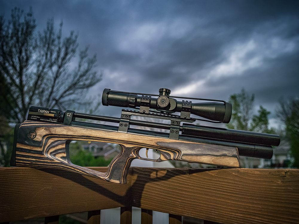

Taipan Veteran Standard .22. Between the EXTREMELY adjustable, perfect trigger and the superior accuracy, whisper quiet and history of reliability, don't know what more you'd need.
It is a little heavy, but other than that, pure excellence.
I might eventually get an RTI Prophet, just because, but I don't think it will be any more accurate or fun to shoot than the Veteran.
I have never handled the Veteran, so no informed opinion there, but that is one very well done photograph of yours! And that is something I do know a thing or two about!
