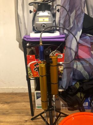

Is the way I have my molecular sieve positioned the correct way for optimal moisture removal? Photo attached
As you can see my tuxing gold runs verticle but unlike most I see run air from bottom to top I run from the top to bottom, I cant see anyone running it like me from top to bottom so I was wondering If I should change out the oriantation an run it from bottom to the top as I see most running thairs, It wouldnt take anything I already got the fill whips an adapters. Should I tip the sieve the other way around as I see everyone has it that way, Should the moisture in theory pool up at the bottom due to gravity I really have to ask I cant see anyone running it like me, Also my tuxing gold is filled with molecular sieve.

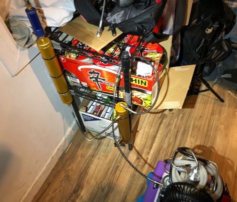

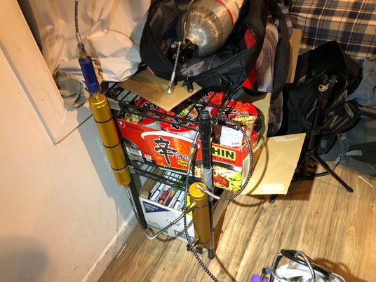

Biohazardman, a Yong Heng and air fill station expert, laid out some basic ground rules. 1) Items to be filled (tank or gun) should be higher than everything else, make any moisture work uphill. 2) Filters vertical, air entering lowest point, heading uphill to tank or gun. Water will pool at lowest point. 3) Cooling water as level to compressor as possible, water pump will be most efficient. I tried to follow his suggestions as closely as possible, like many others, so far has been successful. My M50 gold filter has a designated entrance and exit, which aligns with correct orientation of internal three-media plastic container, your Tuxing Owner's Manual should cover any information on that. WM

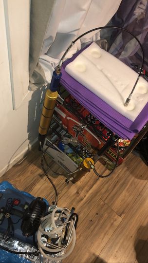

The plumbing looks good, but just as WM suggests, raise the two filters or lower the compressor below them. The first hose coming off the compressor will likely carry the most solid moisture so pay attention to where and how it sits. My setup is the same as both pictured above, except for my filters are well above the compressor. When I release pressure from the block to start the shutdown procedure it spits out the water vapor that settled in that first hose.
2) Filters vertical, air entering lowest point, heading uphill to tank or gun, Makes sense. 1. Items to be filled (tank or gun) should be higher than everything else, make any moisture work uphill.? What that doesent make sense I though you can run a long fill whip say from your blue one an say you had your tank at yong heng level would that be fine?. I will also re arrange my setup with what I have in mind.

It is the first hose coming off the compressor block that seems to build/collect the most solid moisture. That is why it was advised to put the filter system up higher. It seems that that hose matters most with initial condensation and water pooling. Right now your first hose runs directly downhill to the separation filter. Orienting it uphill makes the water stay close to the compressor block, where, when you open that pressure release knob to begin the shutdown procedure, it will blow the solid water out of that line (onto your fingers and into the atmosphere). It will be a dry line at the next start-up doing it this way as well.

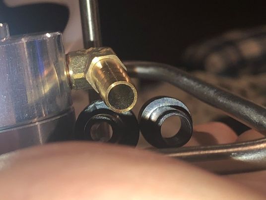

I recommend everyone open up the original nossle with a drill or upgrade the pump that supplies better nossles that dont limit inner diameter so much I got this one https://www.amazon.com/dp/B07Z2QY9S1?psc=1&ref=ppx_yo2ov_dt_b_product_details, Look at the size of the stock on bottom left corner and the one I got with my pump, My pump works really well it will still provide a steady stream half an inch or so even if bucket is lower 220 gph perfect middle ground IMO. Yea what didnt make sense to me was whatever filled should be higher than everything else shouldnt the sieve catch all the mositure? I dont know the logic behind it as the air already traveled say thru from bottom to top passed the tuxing sieve so I dont know why you would need to keep whatever you are filling higher as the air already works from bottom to top in the tuxing filter.
You are correct that once the air has passed through the molecular sieve desiccant filter then the location of the tank really does not matter - at that point your air will have a dew point well below the actual air charge temperature, so there will be no more condensation to manage. Of course before the desiccant, it is best to have things "working up hill," but there is nothing wrong with having the compressor higher than your coalescing filter, but it should definitely be at the low point of the string of filters and lines with the desiccant above it.
