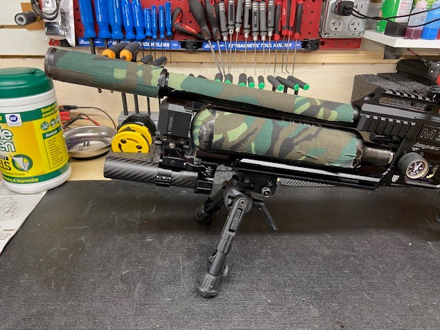

My FX Pocket Chronograph v2 doesn't read nor register any shots. When I turned it on the chrony started reading some "high speed" over 1100 fts. shots without me even using a gun. I turned it off, then, back on and it doesn't read any shoots at all ever since. I've tried placing it in a different location on the barrel, but it didn't help.

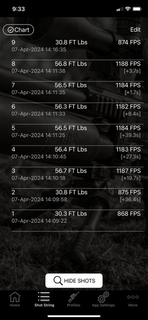

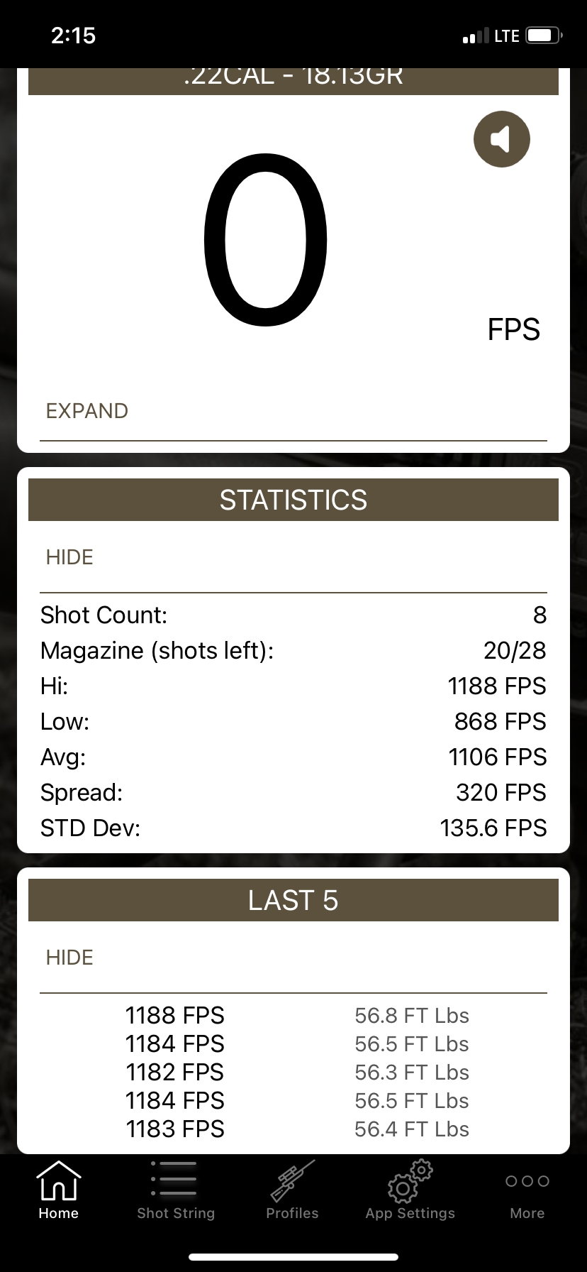

Yes, I have. I deleted old and downloaded a new app. It turns to be the same version I deleted before (v.2.7.123), However, the chrony started working (kind of). I've attached some pics with the shots string. Note that #3,4,5,6,7,8 these are not real shots, the reading was created by the chrony on its own. Definitely there is an issue either with the device or with this version of the app.
