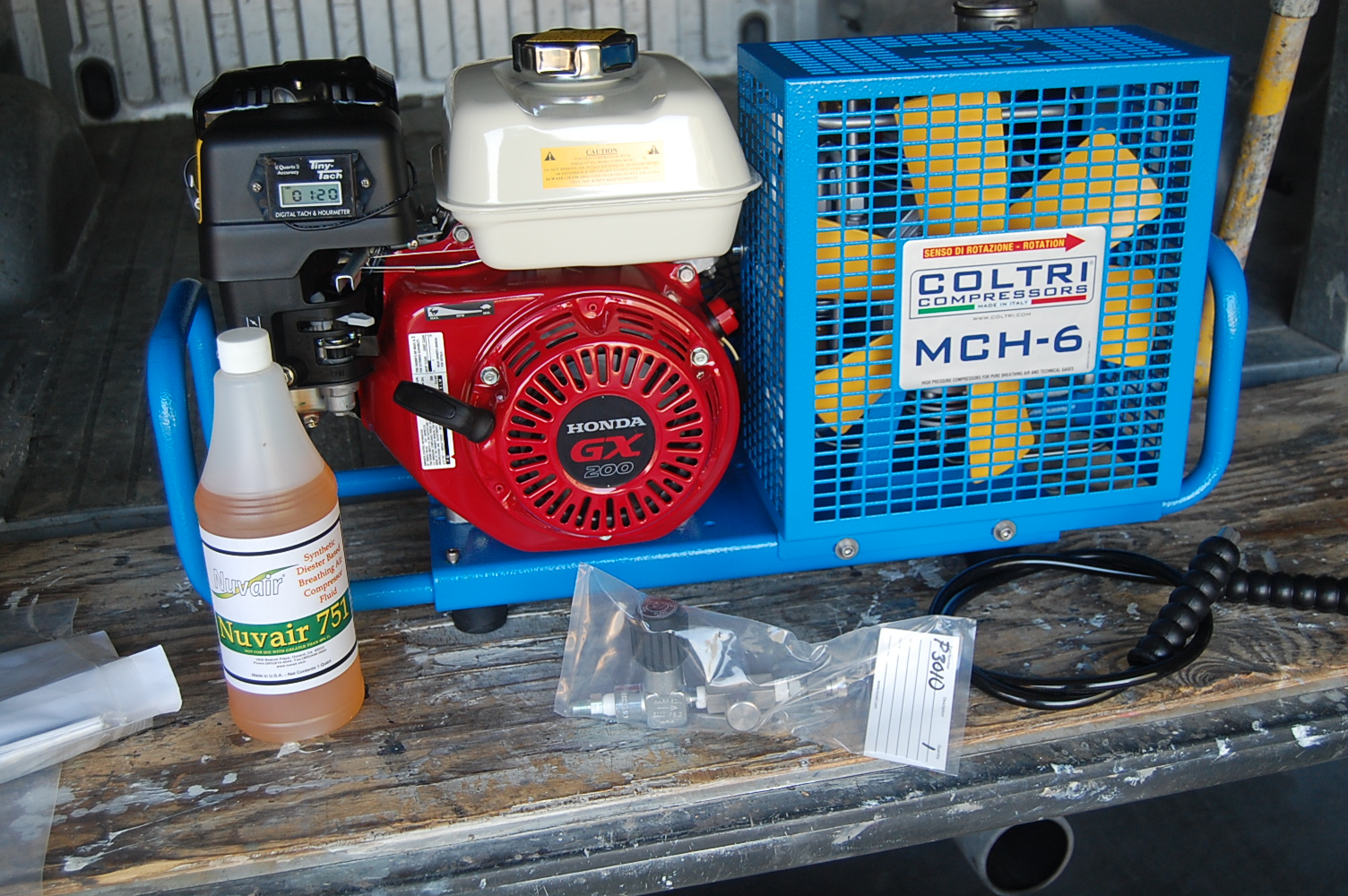

Nuair, Coltri ,Bauer, Alkin these all start at around $3000us. Bauer I would rate as #1 Alkin #2
