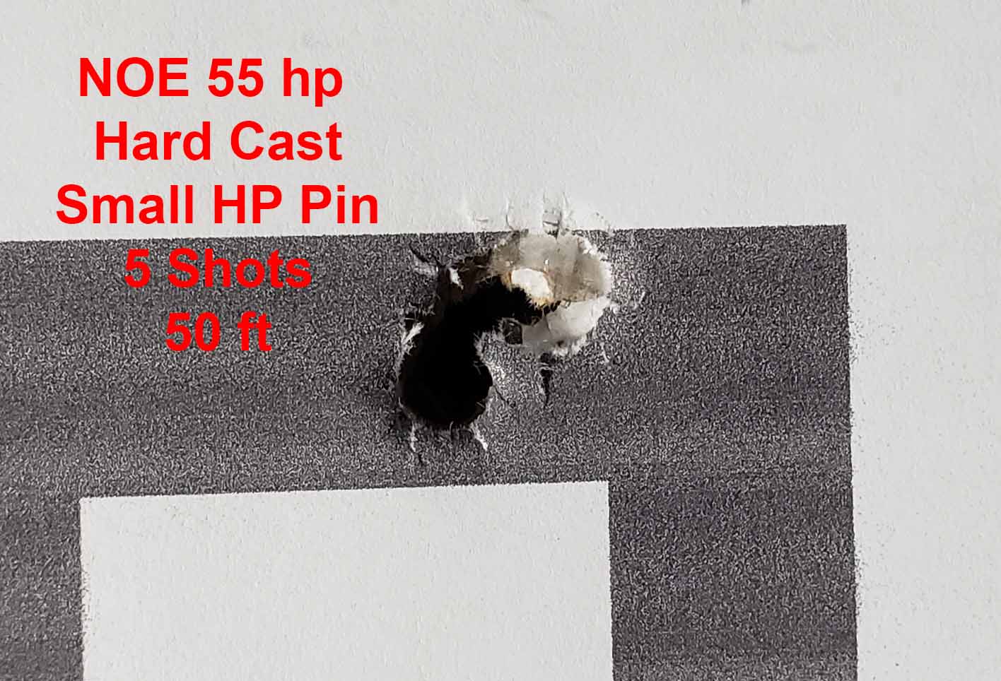

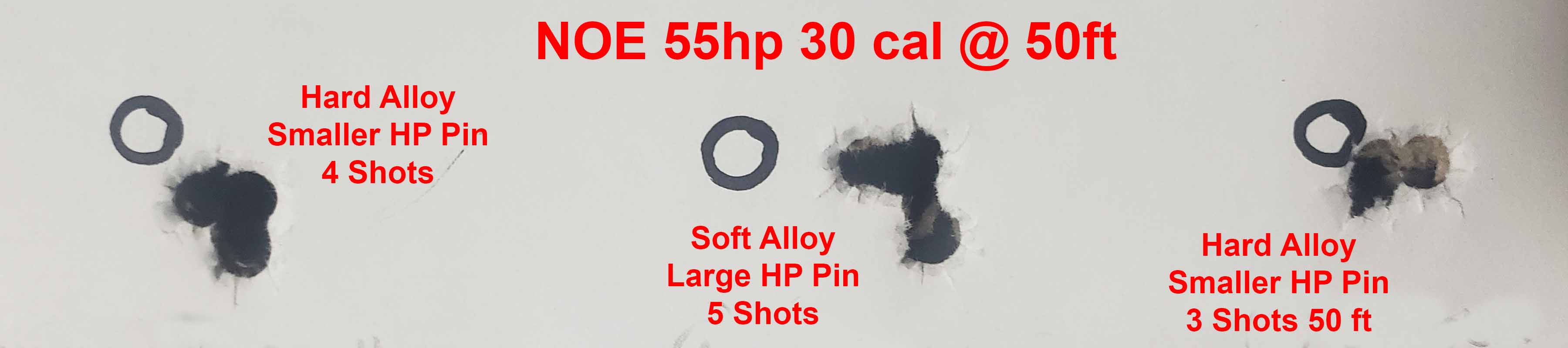

I was able to test the soft lead and the WW/Lino blend hard cast NOE 55 / 60 grain HP slugs in a borrowed FX Impact M3 Sniper in 30 cal. The soft lead slugs chambered very smoothly, no more resistance than a JSB 43gr pellet. The hard cast had noticeably more resistance chambering, but nothing to worry about pressure wise. The one soft alloy group is pretty typical with the FX and my own Gauntlet. I had some NOE 68 gr boat tails that someone else cast in soft lead, un-sized and they were very difficult to chamber. I only shot one for fear of damaging the very thin walls on the FX 30 cal probe. I forgot to measure the OD of the 68 BTs but might post it later.
I was surprised to see that the hard cast NOE 55gr HPs shot better than the soft lead in this FX, but it did well with both alloys. In the Gauntlet the soft lead was significantly more accurate. The full depth hollow point pin slugs shot better than the more shallow HP pin and the worst of the three for all guns tested was the flat nose pin by a fairly large margin. The ones below are the NOE "55gr" (dropping out at 60.5gr) HP with the shallow HP pin, cast with the hard alloy. The bottom photo is the best group and is actually 6 shots with the one at the top right called as pulled. The FX trigger was sticking when starting to move through the first stage. Not sure why. Everything is at 50 ft from a rest and a scope, as I am stuck at home. Will be trying longer distances soon. I will probably post this same stuff with more details in a new thread dealing just with the NOE 55gr 30 cal mold.

I am thinking .309 diameter bullets / slugs wouldn't chamber even with a hammer on the bolt handle with this gauntlet. The .301 soft lead is a real chore to close the bolt on and the .302 hard lead is spooky tight.
