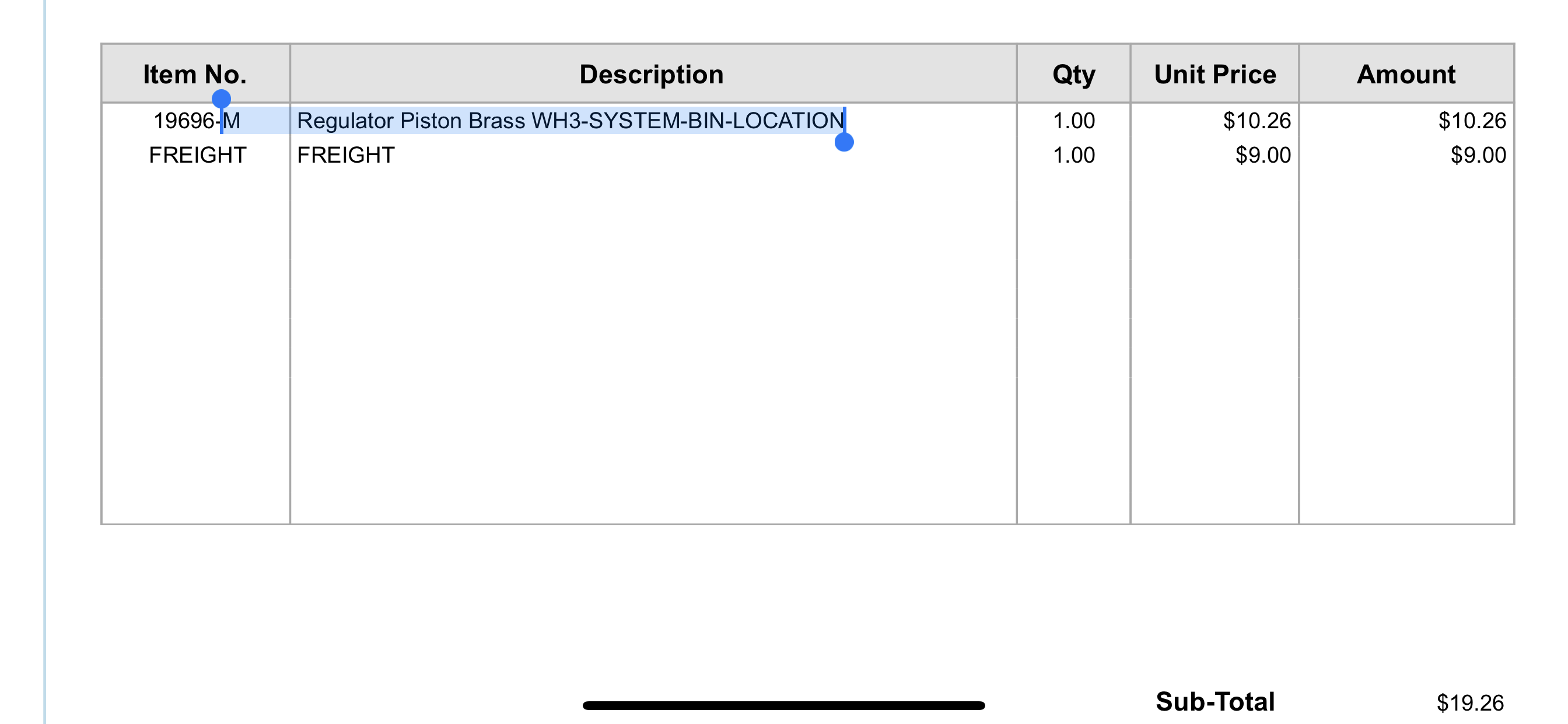

The reason FX recommends 170 max for regulator the delrin piston and if you order the brass piston you can safely to up to 200 bars to my understanding. Call FX and order the new brass pistons for FX regs and you should be good to go, cheaper than huma reg.

30 dollars for 2 pistons with shipping plus 50 dollars for the tool totally less than 1 huma reg and retain factory warranty and can just dry fire once to degass thanks to the venting feature of FX reg, that’s having your cake and eat it too IMHO.
