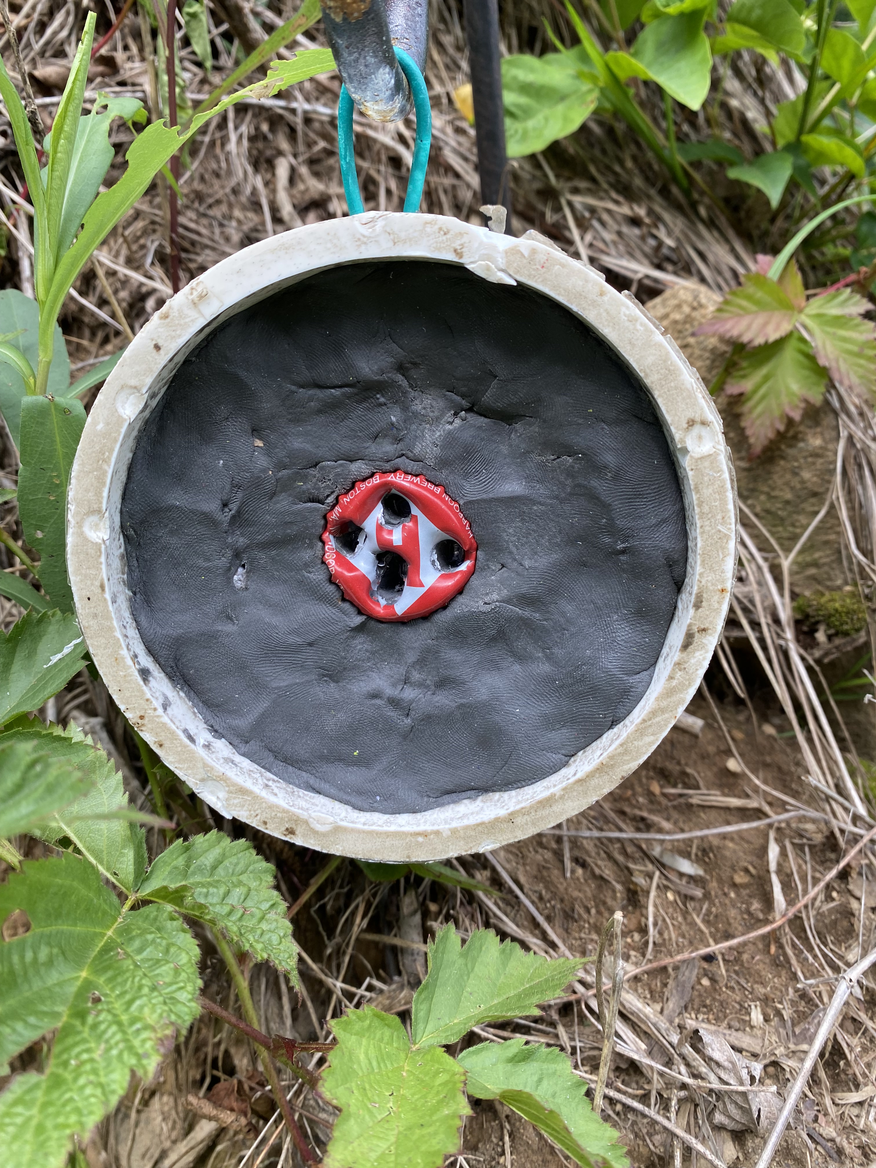

I like a short section of 4" PVC (maybe 2-3" long) packed with 1lb of duct seal. I tape some carboard onto the back to keep the duct seal from coming out. I've got a few and hang them at various ranges. I can stick paper targets on them or (as I prefer) bottle caps.

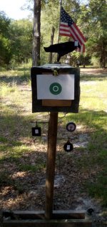

I was using an old crossbow brick(packed with black trash bags as I learned) , depending on power level a bail of straw might work. When I first started I filled a #10 can with plumbers putty,which also allows you to inspect projectile deformation for fun and is reusable. The rimfire bullet trap has always been loud, even welded together with rubber mat put on it. It's the nicest to use but won't meet your needs.
That looks pretty good, but do any pellets go completely through ? I'm thinking I might use one indoors.

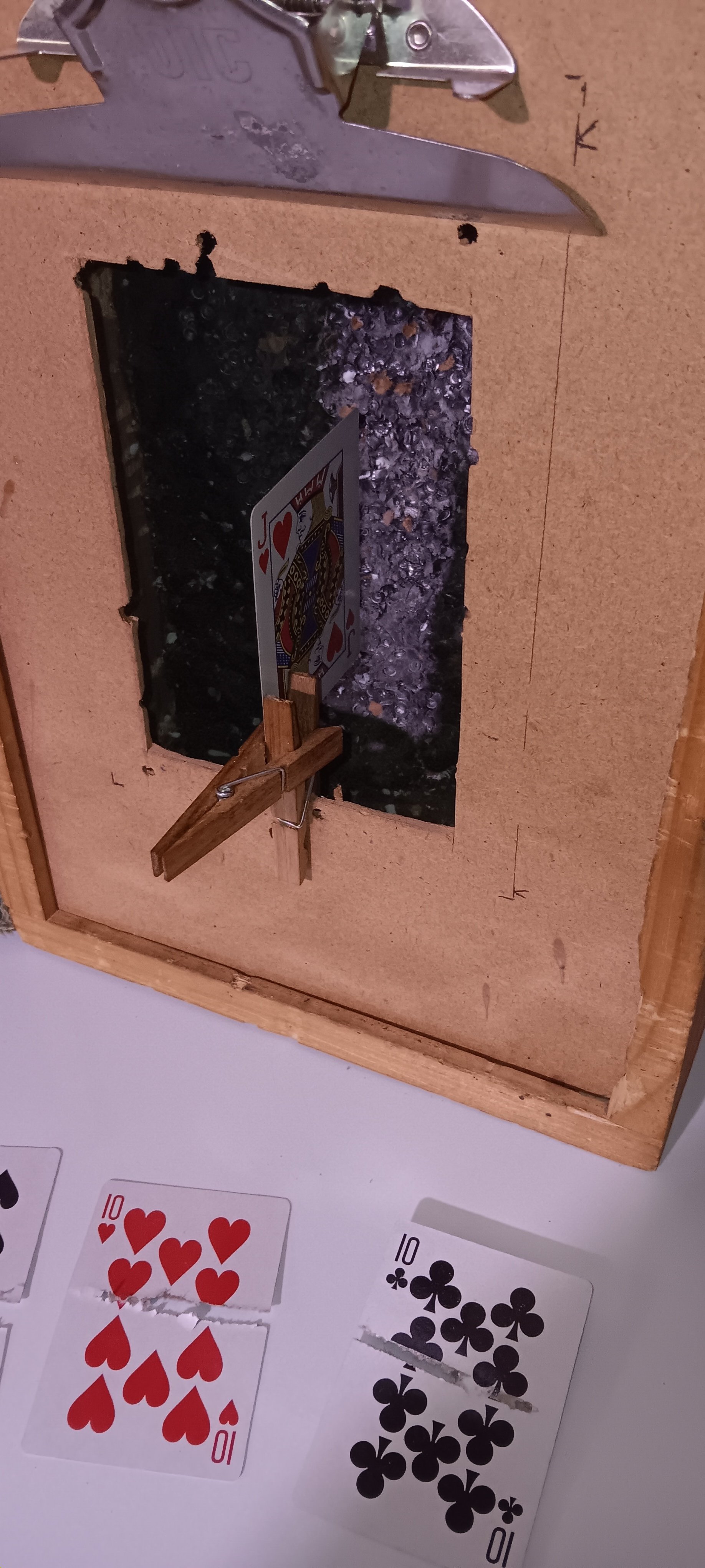

I would consider a box like this for indoor shooting. The box is 5/8" plywood with grooves for the clipboard to slide in and hold your targets. A few blocks of duct seal *(plumbers putty)* and you have a quiet safe pellet trap. I've been shooting this for 10 years. Occasionally after long shooting sessions you'll have to dig some lead out of invasion pellets will stack up on each other. But I've never had a pass through with 10meter or HW 30 power. I did shoot a few 22's out of a Taipan shorty but you'd have to check more often with high power.
If you shoot the same spot with higher powered guns, you will go through. But I'm shooting .177 and I usually shoot 5-10 shots before changing targets. I just kneed the duct seal over to fill in any holes and stick on my next target. If you're shooting larger calibers, you'd want to go deeper and use more duct seal. If you don't tend your targets often, the rubber mulch is probably the better option.
Edited to add: I use one in my basement for pistol shooting. My 1701P shooting 7.3gr pellets at about 450fps doesn't penetrate very far into the duct seal, making the pellets easy to remove. I'd wager you'd need to hit about 100 overlapping shots to get through the duct seal at that power level.
