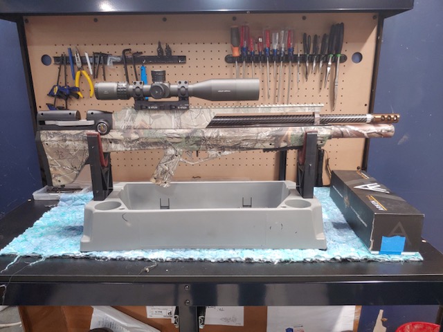

Or perhaps, upgrade your Bulldog. Have a Taurus build coming my way in a week or two. Veradium Air. Contact Brian Thurman.
