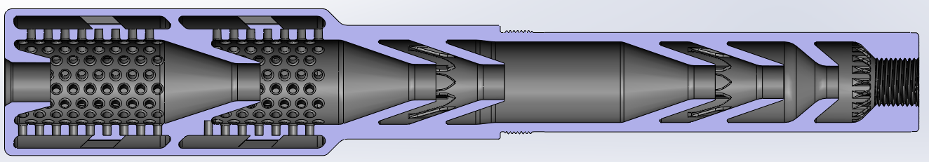

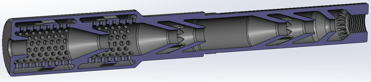

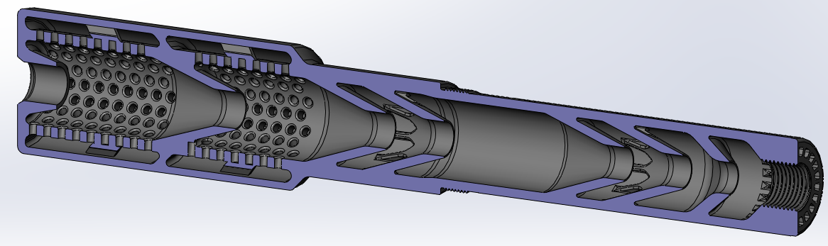

Thanks for the feedback, Mr.H
The design with the 50 mm nose OD exists, if you wanted to try it. The one you have has the 40 mm nose OD.
That said, if one gets the same dB readings for different systems, one needs to consider the possibility that your meter is so close, that it is maxed out to the same reading. Perhaps you can try again at twice the distance from the meter? Ensure that the meter is not so close to the trap that the trap's noise is louder than the report, or that would measure the same for both configurations.
