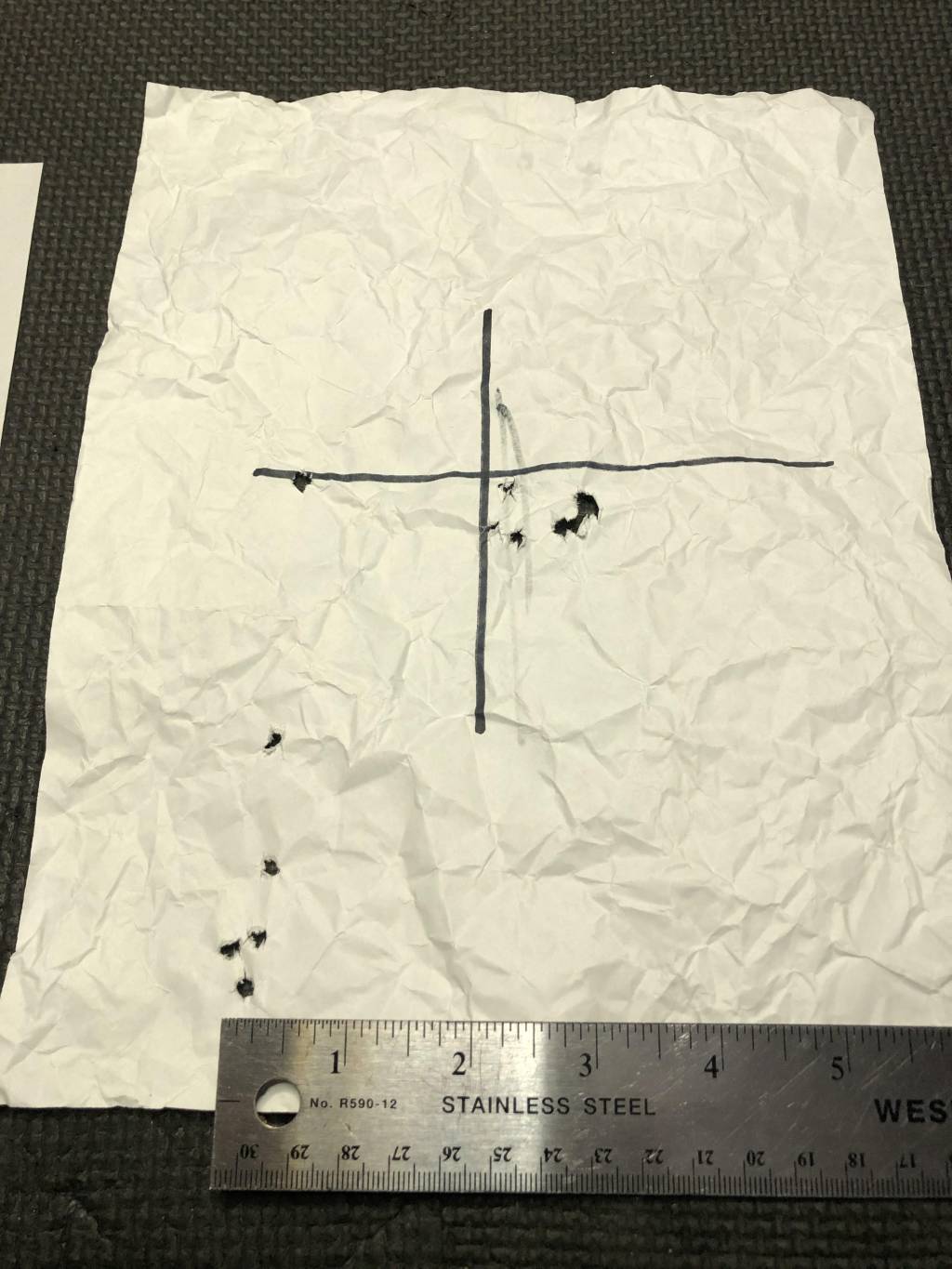

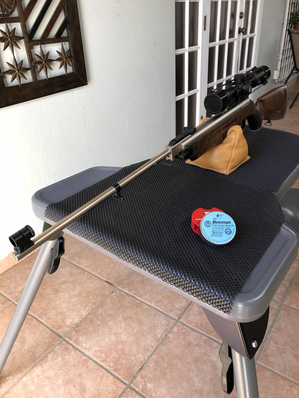

Today I scoped the new HW35e. I'm using two piece sport match mounts and a Athlon Talos scope. My first group at 10 yards is about 2 inches to the left and 5 inches low. I understand the barrel droop. But I'm worried about the left grouping. For several weeks I could swear that I'm seeing a slight curve of the barrel to the left. I tell my wife to check it and she tells me that it is in my brain. I put the gun flat on a table and with a bubble level check the stock and check the barrel and they seem leveled. I'm honestly lost here and don't know if this is normal or is it something that I need address in a warranty claim.
The thing that got me worried was that when I got the gun, the original Weihrauch box had a damage at the end barrel. The outer box is fine but who knows when or how that end took a whack.

Then something is likely wrong. That is six or seven inches low and two inches left at ten yards. It equates to about 20 MOA left and 40 MOA low (assuming you need a 2" hold over at that range to compensate for scope height above bore).
If all of the above is true and you can adjust it out, and you don't mind doing that, no worries. That is a lot of adjustment from center though. You might look at your mounts to make sure they are properly installed.
Last question I suppose. Is that a vertical string on the left or were you changing aiming points? You have all those pellet holes lined up left to right and strung out vertically. That ain't good unless you know why.
If you want to check the bore for a bend, put a bright light at one end of the tube and look through the bore. If there is a significant bend you will be able to see it in the bore.
I did use a small bubble level to the level the gun while in the gun vise. Then I leveled the scope placing the level at the top of the elevation turret. That vertical string to the left is the progress while I was adjusting the Vertical turret. Then I adjusted the windage to the right and that is the group far right. I used the Cris-cross pattern to tighten the mount tops. It was getting dark so I will recheck all with good daylight.

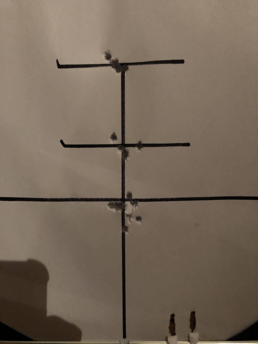

Its been 15 years since I scoped a gun. That was my SLR98 and Its been untouched since. So bear with me here. Finally I had the time to work on this with plenty of daylight. Here is what I did and what I found.
I took everything off the gun, re-centered the scope to optical center and took the BKL medium mounts from my TX200HC and mounted the scope on the HW35e. The vertical placement was even further away from my aiming point. The horizontal was the same 2 inches to the left. Adjusted the turrets and shoot several times with very nice results.

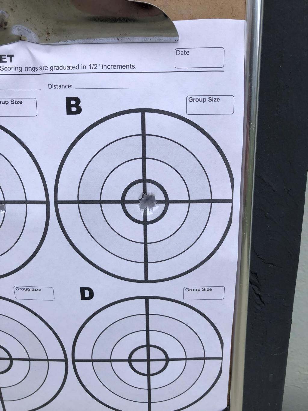

Then took everything off again from the HW35e. Re-centered the scope and put it back together with the Sportswatch mounts. The same exact pellet placement as before. So I adjusted for windage and elevation and let it be. Here is a 5 shoot group for 11 yards.
