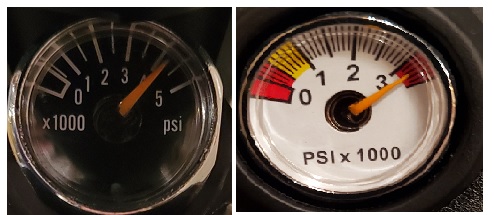

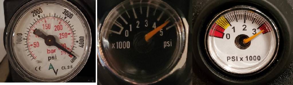

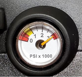

When I got it, it showed this for a regulated pressure after filling to 4500 PSI.
I've read these gauges can be off by as much as 400 psi (looks like off by 450 psi based on 3150 psi and 2700 PSI setting from pitbull factory).

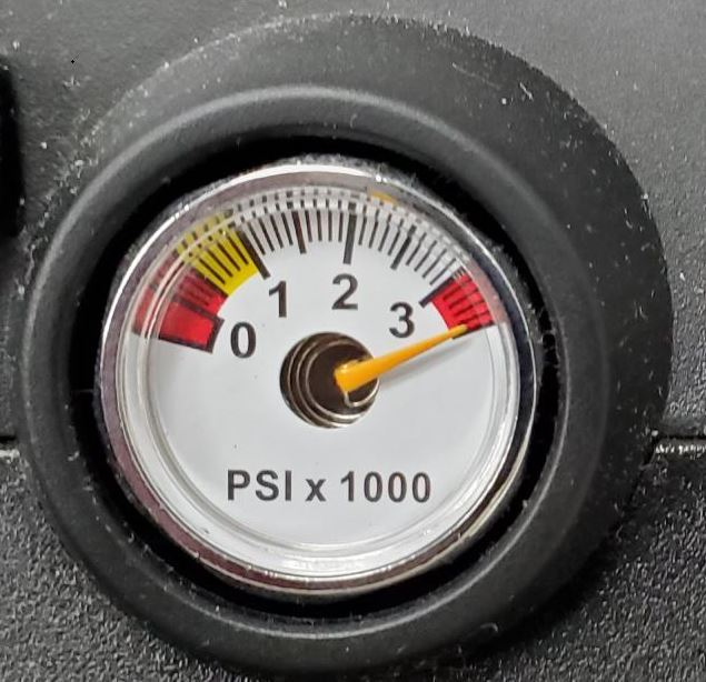

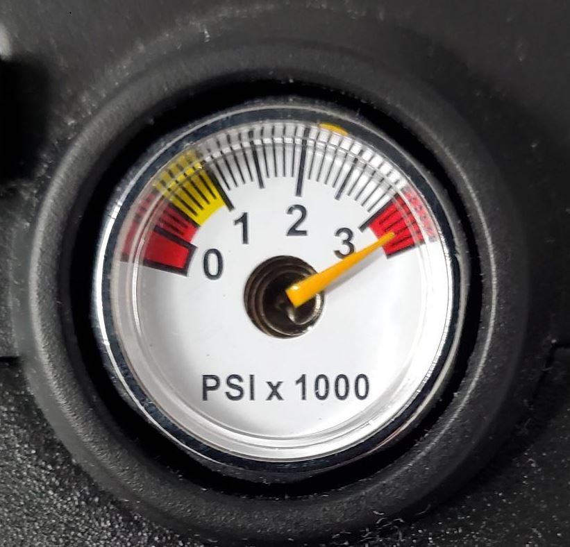

Anyway, today, I take the gun to shoot, and this is what I have (3450 psi):
I take a shot, and then the gauge has this (3300 psi or so):
All together I have about 30-50 shots through the gun. Pitbull had told me long ago that I need to get about 100 shots total before I know if I have an issue. I hand pump and have other stuff going on in my life hence the reason I am only at about 30-50 shots so far. It's a good workout hand pumping to 4500 psi.:)

If it's reading at the plenum, then it will never read higher than the reg set point, regardless of the the cylinder/bottle pressure. But, it should not vary from that reading at rest. In this case, it seems to be creeping up.

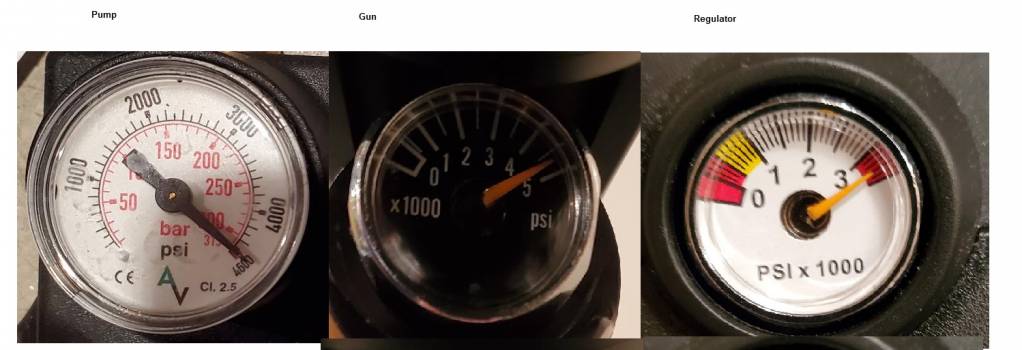

The behavior I am seeing today is about the same as when I first got the gun, except I have more shots and it seems to be getting worse. It looks like the advertisement on the site claims 6 regulated shots (it had something different before--I'll have too find the screenshot I took when I bought it). Even if the gauge is inaccurate, unless it is also random, it looks like I get about 4 regulated shots, with the regulated pressure reported by the gauge being mostly consistent after the first 3. At least that is how I am interpreting the gauge readings below. Let me know if I have a misunderstanding.
So I am trying to put more slugs through in any event. I have a pellet trap from shreadded rubber and am doing it without the benefit of a chronograph.
This phenomenon is the same as when I first got the gun. I described it to Paul at Airgun, but he responded that I need to get 100 shots through the gun. Being a newb, I took his advice and waited. I'm still not at 100, but I just counted my pellets and I am at 80 at least 80. I have made no adjustments to the hammer or regulator.
But this doesn't seem right even if I am a newb.

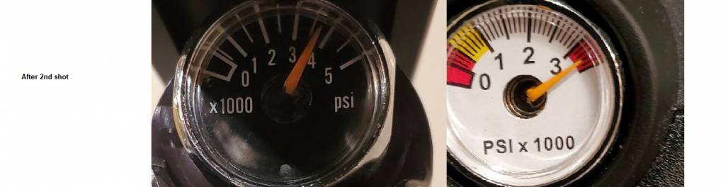

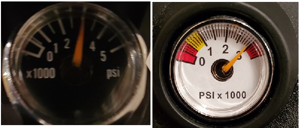

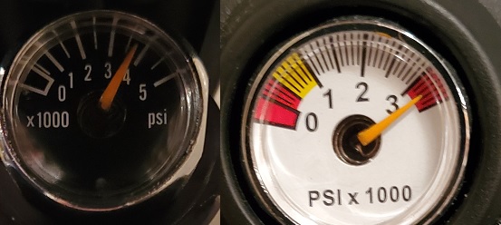

So after pumping:

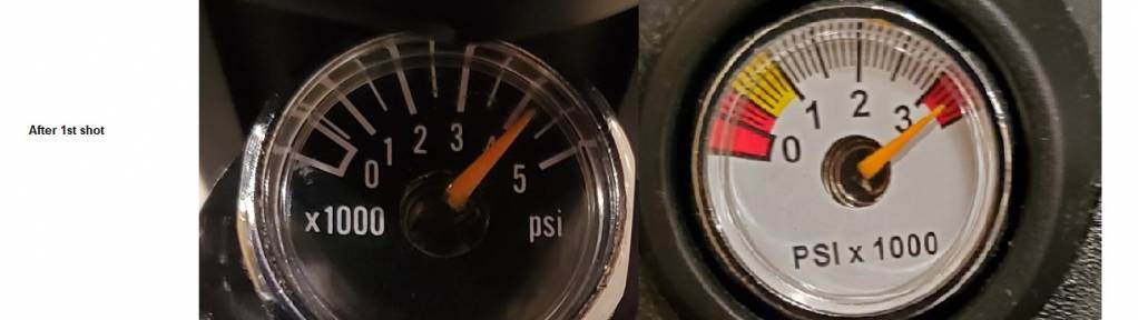

after first shot

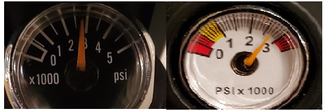

After second shot

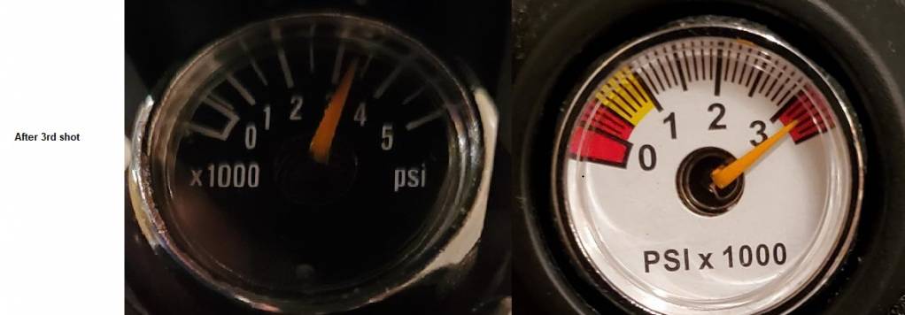

After third shot

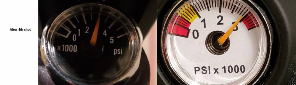

After fourth shot

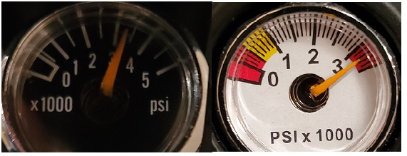

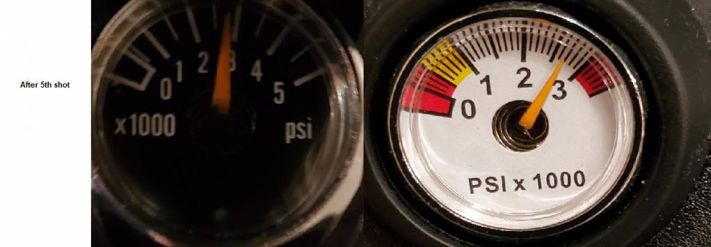

After 5th shot

It looks like the gun and regulator gauge are fairly close after the fourth shot where it has fallen off the regulator. Being a new gun and with a Huma installed that regulator pressure may actually be that high. It's possible that it was originally set at 2700psi but has settled at 3300psi. As mentioned a chronograph is really needed to find out how it's tuned. If the velocity goes up when increasing the hammer spring tension there is a good chance that the regulator is set higher than 2700. I didn't know a thing about the Bulldog/Pitbull conversion until I watched this video. I use a high quality digital test gauge to check the accuracy of these guns gauges. Some are close and some are not. The regulator gauge is the one that really needs to be.

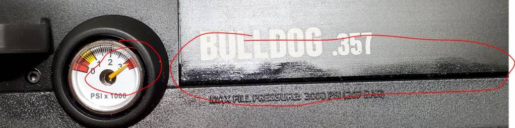

But first, when I first got the gun, I contacted them because out of the box it looked like this:
And this:
To which I got this:
>the regulator requires a break I'm period of at least 100 rounds. if you are not satisfied with your purchase please return it for a full refund.
Which seemed nuclear, since I wasn't looking for an all or nothing solution. In fact I was just providing feedback, seeking guidance, and hoping they had a less drastic remedy.
By the way, the gun was very well boxed and protected in foam, and the box did not have undue damage--certainly none in the area where the scuff was, which made me conclude that the scuff was there when they packaged it. As far as I was concerned, and I admit I did not specify what remedy I was asking for, was they would offer to send me a new part to replace the scuffed part, and give me reasonable guidance on the gauge.
After I clarified I wasn't looking for a nuclear option, pitbull air responded with:
>the 2600 psi indicated on the gauge on the side of the rifle is the regulator pressure of 2700. they are very close, but not 100 % accurate until its broken in.

>But it is over 3000 (see original photo at bottom)

Gun is tested by FACTORY to be safe when filled to 3000 PSI and with that spec a % of safety margin is established.
Filling to 5000 psi is BEYOND STUPID and very similar to a thread months ago ( may be the same folks ) doing so is IRRESPONSIBLE at an epic level !!!

Now as to Q ... Plenum pressure stays put until at such time HP storage side drop below regs set pressure & gauge moves lower. NORMAL
