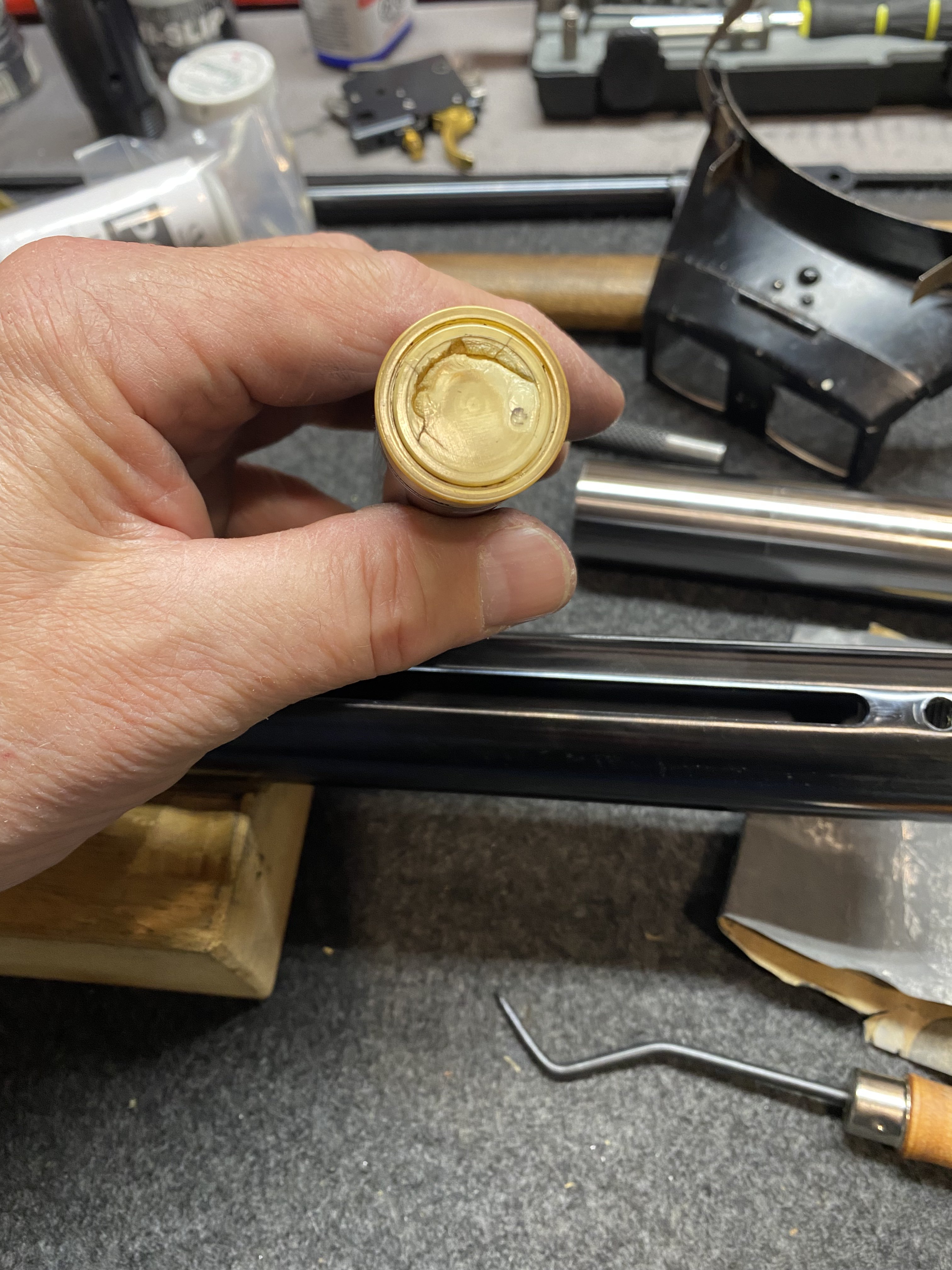

Yesterday I disassembled a HW97. This rifle has had maybe 1500 rounds through it. The piston seal has cracks in it.
I’m putting a Vortek spring kit in it. Unfortunately I don’t have a piston seal, but they’re on the way. When they arrive I’ll change it then.
Is this normal?

You can see where the transfer port hole slammed its mark in it? Somthing like the seal was too loose a fit or breach seal or too lite loose pellets can caise that by not holding enugh back pressure to stop/ cushion the piston and it slams hard.. i dont see heat being that cause cause ot looks kinda clean on its face not bad discolored fro burning so to say ... Anyway thats just my observation opinion ..

A heavier pellet isn't going to help here. Most of my .177s are sub 12ftlbs and shoot the JSB 8.44s exclusively and all of them still looked like that and quickly. I'm at the point now where when I get a new HW, I take a few shots to get a feel for it and then it immediately gets disassembled, cleaned up, and relubed. After that I'm worry free for 10k shots. I usually just like to do a clean and relube at that point.
Something in Weihrauchs assembly procedure is amiss. Whether its they had to hire new guys through Covid or that they're rushing them through assembly to keep up demand I have no idea. Either way, many are leaving the factory with entirely too much lube, and a lot of it is sitting between the piston face and transfer port by the time you get it. If I had to guess I would say they're lubing the compression tube walls heavily and then when they install the piston, the seal drags most of the lube forward.
Next time you buy one, immediately take it apart and shine a light down there. You'll see the issue before it even starts.
I personally think there using crap material to begin with! HW used to use a thin lip parachute seal that never did that. They would dry up and get hard after a few years but didn't burn up like the newer style!
A well fitted ARH seal or a Vortek won't do that even with a little dieseling!

Crow, -> It seems like you should have gotten more than 1,500 shots before the piston seal "looked" that bad.
However, yes ... this is what they look like after they have failed or are about to.
Have you noticed a significant change is velocity in the last couple of months as its likely been failing for some time now :unsure: ?
Yeah completely normal…often referred to by UK tuners as the cheese seal …
Vortex seal better …clean out your compression tube to get rid of the crap grease (Said to be LM2 grease which doesnt have the highest flash point, if ok on cocking arms) used by HW OEM which probably caused most of the issue ….re-lube with hint of High flash point moly for reassembly …forget worrying about highest moly content …go with highest flash point….
Reactions: crowski
Very common on newer Weihrauchs It's caused by excessive dieseling from over lubrication and or damaged sealing surfaces.
‘You’re probably right, when I opened it up I thought I was in Texas. Crow
I would have thought premature.
No change, it was shooting great. It’s just over year old. It just won the draw for next change. Crow
