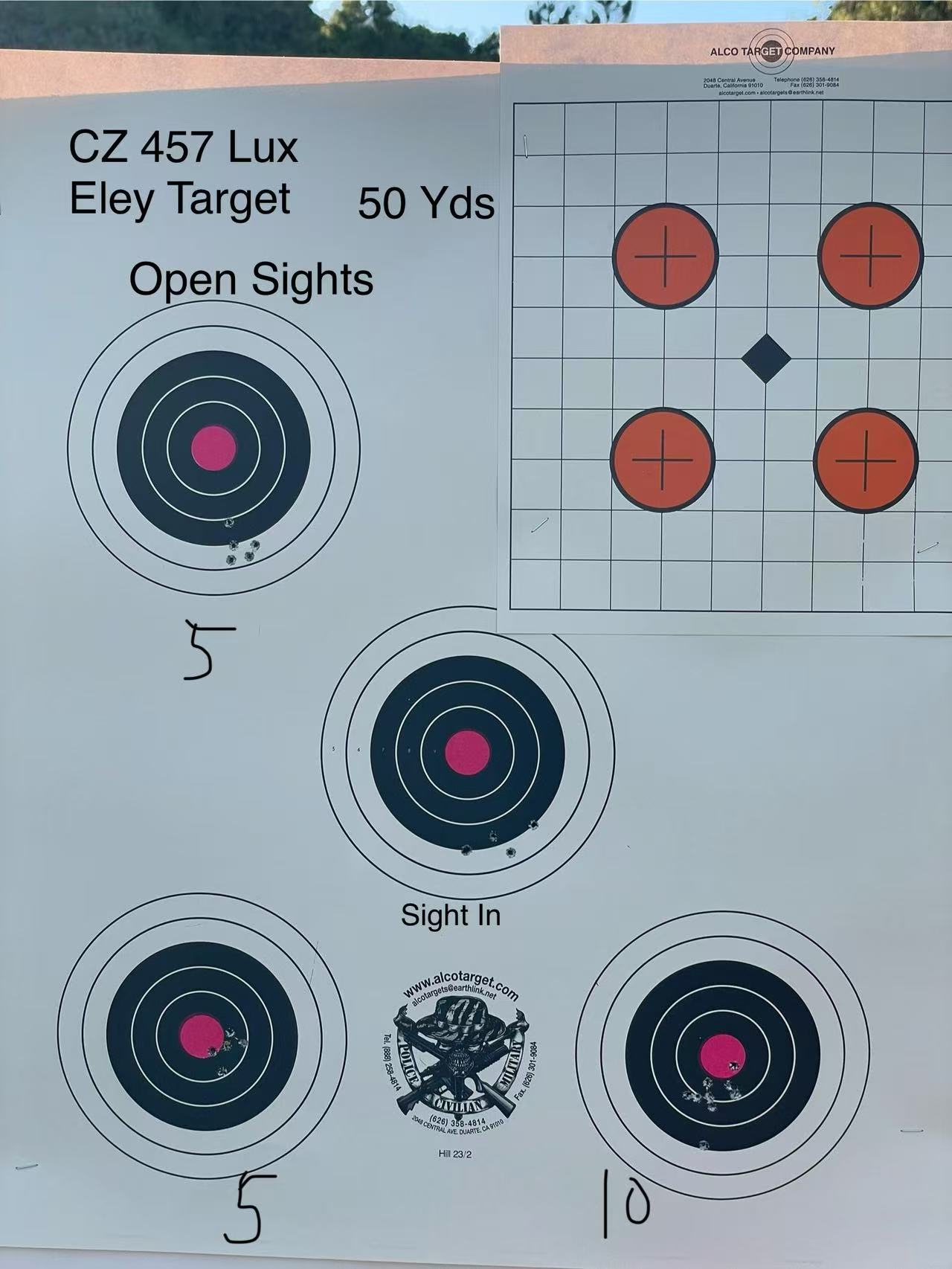

As for how much this play actually matters — I agree it’s not a huge deal, but I don’t think it’s completely negligible either, if you’re serious about shooting with opens. In my case, there are three areas where play is present, creating around 0.2–0.3 mm of total movement (though it’s hard to measure precisely). To put it into perspective, the amount of play is roughly equivalent to two or three clicks of windage adjustment on the rear sight. These parts may “reset” to a relatively consistent position after each shot, but it’s hard to verify how consistently or to what extent that actually happens.
Given the HW30s’s sight radius of 39 cm, a 0.2 mm shift at the rear sight translates to roughly 1.8 MOA of potential point of impact shift. That’s not catastrophic, but still significant if you’re trying to squeeze the most out of open sights.
For example, here’s what I got with a rimfire — about 1-inch groups at 50 yards, which is about 2 MOA. A possible 1.8 MOA sight shift would noticeably open up a group like that.
For reference, the rifle was a CZ 457 Lux, which is known for its accuracy and comes with nice iron sights. Interestingly, it doesn’t have interchangeable front sights or a rotary rear notch like the HW, which is why I feel pity that the weihrauch sights are so awesome but having the play.
Of course, if you’re not particularly into open sights, or not too focused on squeezing the last bit of precision out of them — that’s totally fine too! I get that most people scope these rifles anyway, and this level of detail might not matter at all in regular use.
