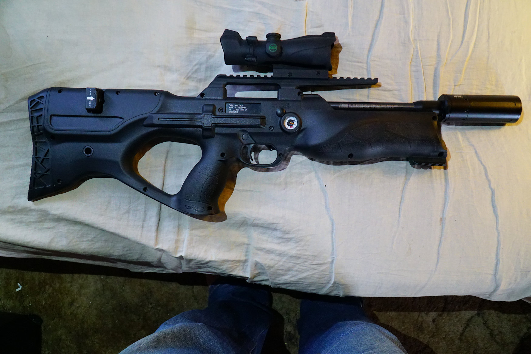

I'd measure mine for you, but...I cut any possible choke area off !

So...I assume that you are wondering about losing accuracy ?
While I shoot at shorter distances than most (under 25 yards), After my handy work, I lost no...accuracy. The same point of impact according to my "dot" sight, using the same 18gr JSB pellets. As I recall, no difference with the 14.3gr. JSB's .
Mike
Like you say, the new crown is the most important thing to do well.
90° chamfer, 30° chamfer, radius, deep, shallow...in my time (have cut a couple), it seems to make no difference, as long as it's clean and at a 90° angle to the barrel centerline.
The Reign isn't really a long distance shooter to begin with. Like I said, in the "trimming" of my Reign's barrel, I lost nothing but maybe a few fps of pellet speed. I didn't have a chronograph at the time that I cut the barrel to check it, before and after.
