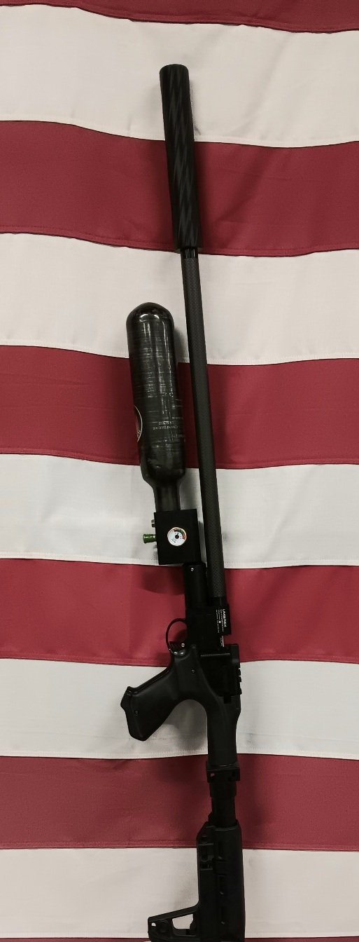

Being one of the posters mentioned above, my story about spending a bunch of money on my notos was actually one of proving parts that I would eventually install for others. Everything I offered to others, needed to be proven in a working gun, items like inline regulators, then drop blocks, Z-blocks and now Dream Valves.
I've gone through lots of o-rings of all sizes, drill bits, reamers, carbide inserts for the lathe, the list goes on.
All of those dollars spent on barrels, carbon fiber bottles and shrouds, liners, moderators etc and thousands of pellets slugs and hand cast projectiles were just to test all of these parts for others and in the end, all of those parts will just be sold off one by one to those that are ok with lightly used.
