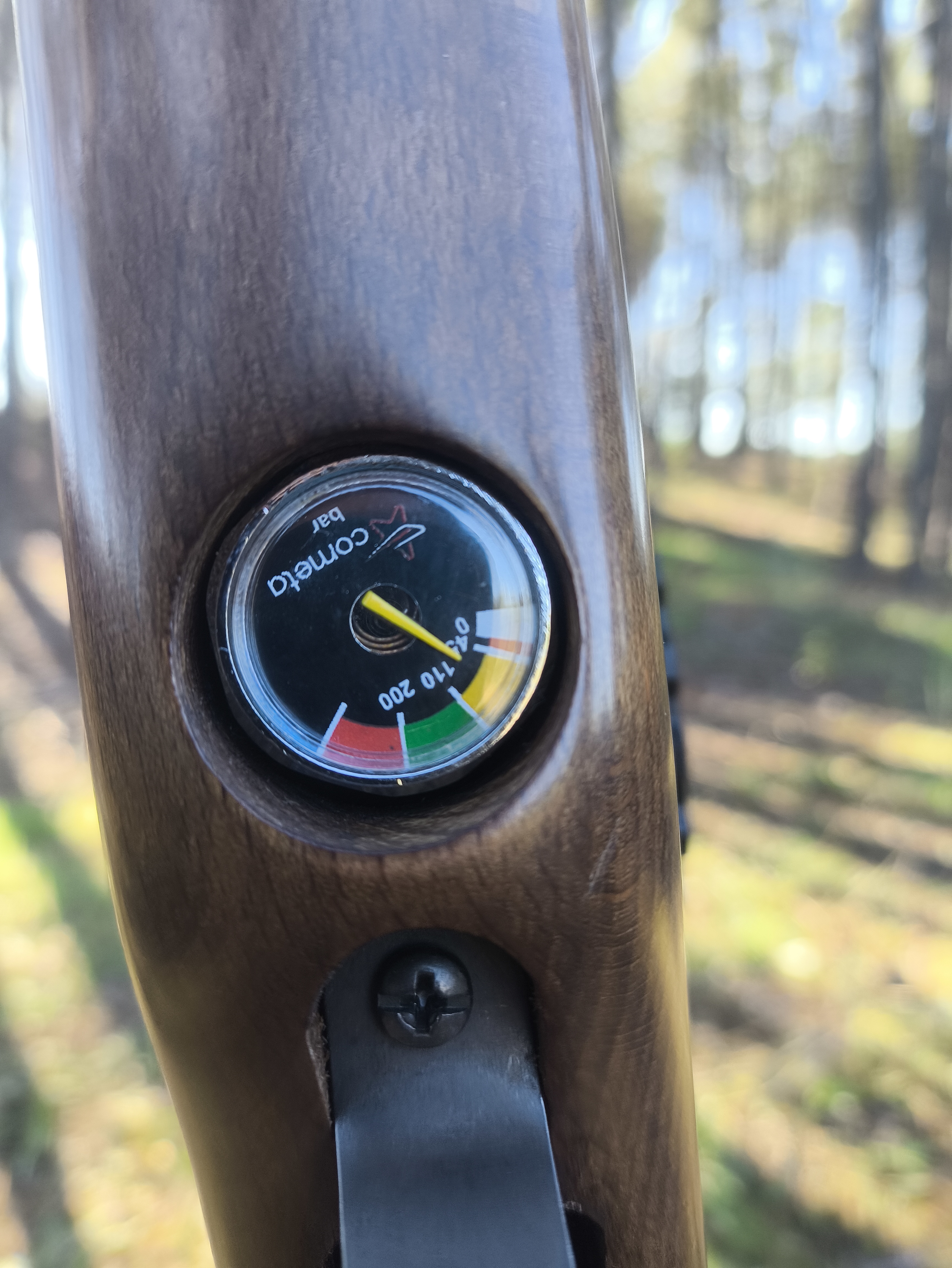

Recently I installed an Altaros regulator in a Cometa Orion SH Long. I installed it following their instructions. When I filled the tank, the tank gauge read 200bar:
The regulator gauge read approximately 150bar as expected. But after 10 initial shots the reg pressure dropped dramatically, way below 100bar:
The issue is that it did not replenish the pressure. I could not fire the gun for 2h, which is how long it took to get back to the ~150bar.
After, I took another 10shots and the same happened again. This time, it was even weirder because after 2h or so, the reg pressure raised to 200bar.

My best guess is the valve seat is compromised in some way. Something like a bit of debris pinched in the seat or a hairline scratch, causing a scenario where the seat attempts to pinch closed in the normal fashion, but cannot seal 100% so air continues to weep very slowly past/through this imperfection.
I couldn't find a good picture or exploded view of an Altaros regulator but if you can post one, I can direct you more precisely where to look.
Yeah I understand what you are saying. Sadly I don't think I can find or get any image of an exploded altaros regulator.
