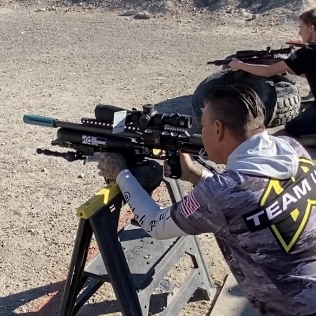

Running a barricade is much easier with a well balanced rifle. As you’ll see in the pic my gun is placed very far forward on the bag with my grip nearly touching the bag. This is the balance point currently and not ideal. That’s the struggle with these particular Airguns. Moral of the story get as much weight as far forward as you can on an impact to help balance the rifle. With an approach like this the gun requires less input at the rear from me and is easier to minimize my wobble zone and stay on target
Running a barricade is much easier with a well balanced rifle. As you’ll see in the pic my gun is placed very far forward on the bag with my grip nearly touching the bag. This is the balance point currently and not ideal. That’s the struggle with these particular Airguns. Moral of the story get as much weight as far forward as you can on an impact to help balance the rifle. With an approach like this the gun requires less input at the rear from me and is easier to minimize my wobble zone and stay on target View attachment 304322
I've noticed alot of the big heavy pcp air gunners use large tripods and camera-like equipment. I always thought that was very smart because allot of tech and design goes into balancing those cameras for a good shot if you know what I mean!
