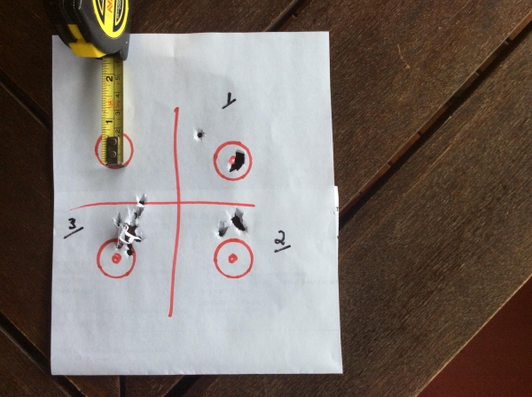

It's doing my head in.
No1- Walther LGV Challenger Ultra, 22 cal, 5 shots, 30 meters. The flyer was the first shot and my fault. Scope is a UTG Leapers 3-9*40, has held zero for last 10 months.
No 2- Benjamin Trail NP, 22 cal, 5 shots ,30 meters. Scope is a Nikko Stirling Gold Crown Air King 4-12*42 AO. Scope holds zero most of the time, only needs 1 or 2 clicks up or left or right once a week or so. Half inch above target as is my go to heavy hitter and sighted in at 40 meters.
No 3- Benjamin Trail NP, 177 cal, 10 shots, 30 meters. Scope is a brand new Bushnell Trophy XLT 6-18*50. This rifle has just killed the previous Bushnell, lucky for me the scope has a lifetime warranty, no questions asked.
Yesterday it was zeroed in at 30 meters and shot exceptionally well if I did my part. I've had several problems with this rifle, which by the way I have enjoyed fixing. This was a very accurate rifle but several issues has seen it relegated to the back of the safe. I wanted to order a Diana Bullseye ZR mount but the only importer in Australia advises that they won't arrive until December.
You might not be able to tell but it started high and slowly worked down. If you have looked at the 10 dimes challenge you will see that is is capable of being very accurate for a cheaper air rifle.
Very frustrating, am I expecting too much from this relatively cheap airrifle or not. I really enjoy fixing problems with it but some times it just does my head in.
First off GOOD SHOOTING !!!! Dude you may be asking too much from the gun ....That being said. You for sure know how to get the best out of a break barrel . The Benjamin/ crosman rifles ive owned strungpellets a little .
My best guess ,ands its JUST a guess is the barrel to breech wasn't locking up properly. But I honestly couldn't feel any wiggle or anything . If the barrel itself was bad it wouldn't even string it would just shoot all over the place .
If you don't mind , what all have you done to it ?

I seem to think it may be the new scope. As I said I maybe asking too much from it but any help would be greatly appreciated.

G'day SendinSlugs, I'm using JSB Exact Heavies at 10.34 grains at the moment. Last year I borrowed one of those scientificy thingies that tells you how fast the pellet is going from a mate, then it was sending the Heavies down the road at 850 fps, there was only about 9 fps varience in 10 shots I recall so I didn't think that was the problem. By the way Joe needs one of them scientificy thingies for his next air gun review.
But seriously the breach seal has passed the paper tissue test, another scientificy breakthrough and as as far as I can tell not impeding the lock up, and I made the jam spring 2 mill longer then the original to lock up the barrel tightly. And prior to each shot as part of my preparation I tap the barrel up to ensure lock up. I also rest it lightly down before shooting. I should borrow it again to see if there is now significant variance between shots but I'm pretty sure if there was that much variance the gas ram would have failed by now, but I could be wrong.
Thanks for your input.

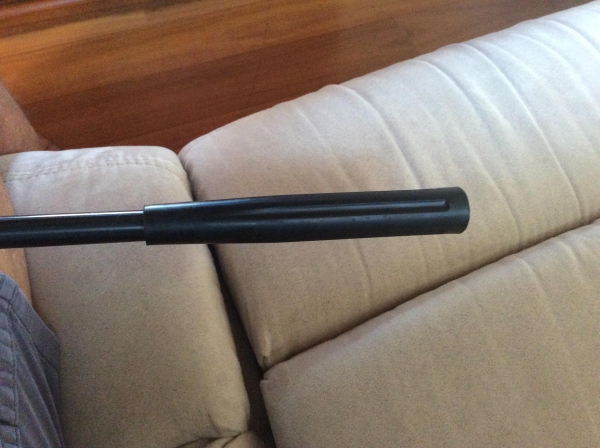

How does the crown of the barrel look? Might need to take 2000 grit wet or dry and just LIGHTLY TOUCH IT UP if it looks anything but flawless. JSB pellets have also been on a downhill slope lately,I've had non stop bad tin after tin,different skirts,AA pellets mixed with exacts,3 different dies in the same tin,,I'm starting to think JSB pellets aren't worth the price anymore..
