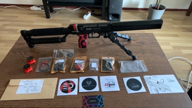

Okay I got another surprise today my EdGun Leshiy 2 arrived 4 weeks and two days early ordered from Francisco. It is absolutely beautiful. Everything that came with the gun other than the 300 cc bottle is there....

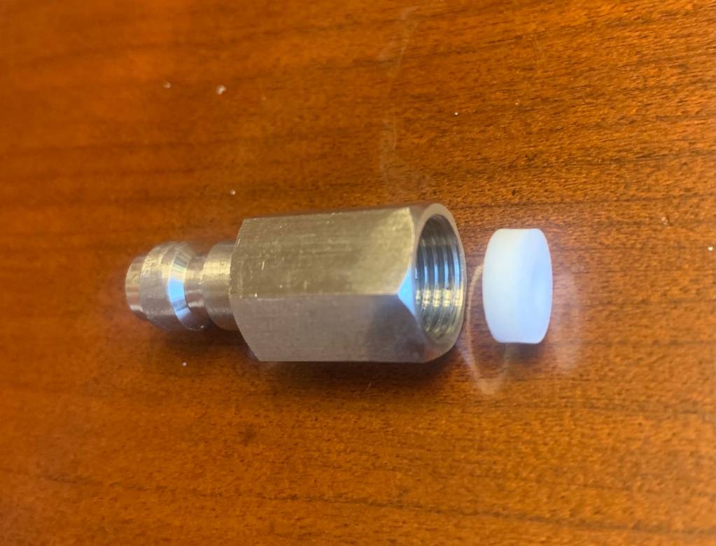

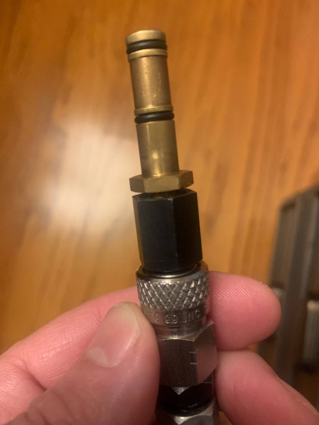

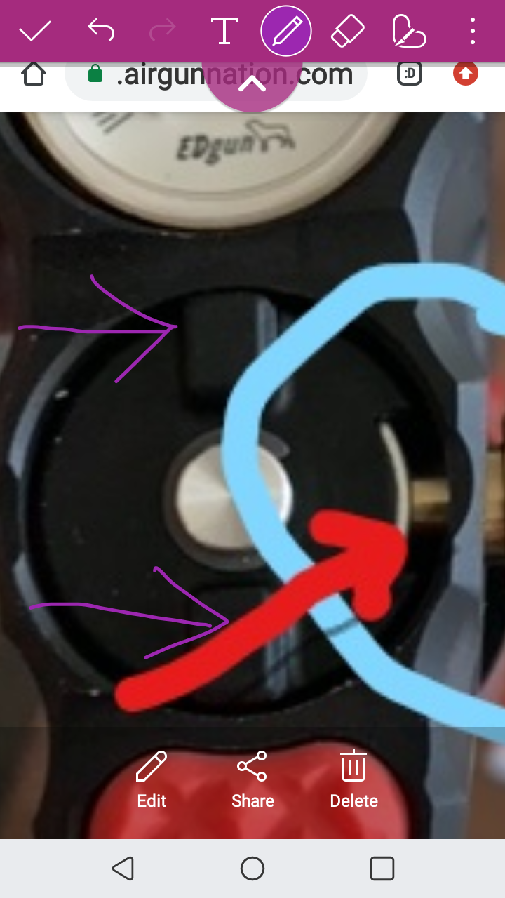

First, I went through the basics of the instructions took the fill probe installed a foster quick connect adaptor on the probe, then connected to my tank, and now the BUT, the probe to air was rushing out of the fill port, the gun filling and probably 4 times as much air bleeding as going into the gun. I contacted Francisco and he said he sent me an extra probe with gun, but I can't find it so no alternative. We thought maybe the foster fitting, well changed them, seals I changed everything I could think of even the tank.

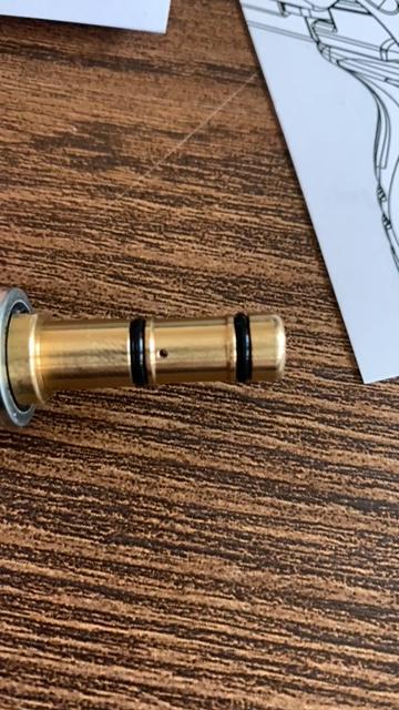

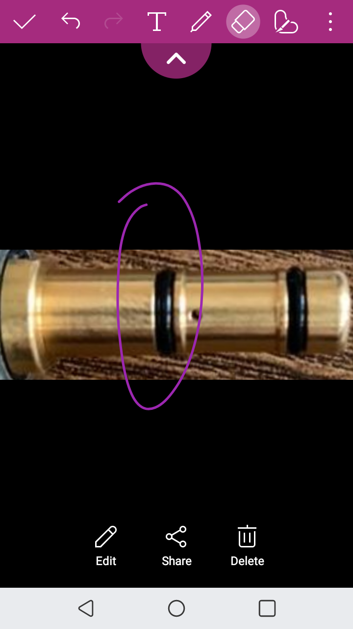

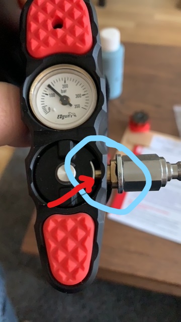

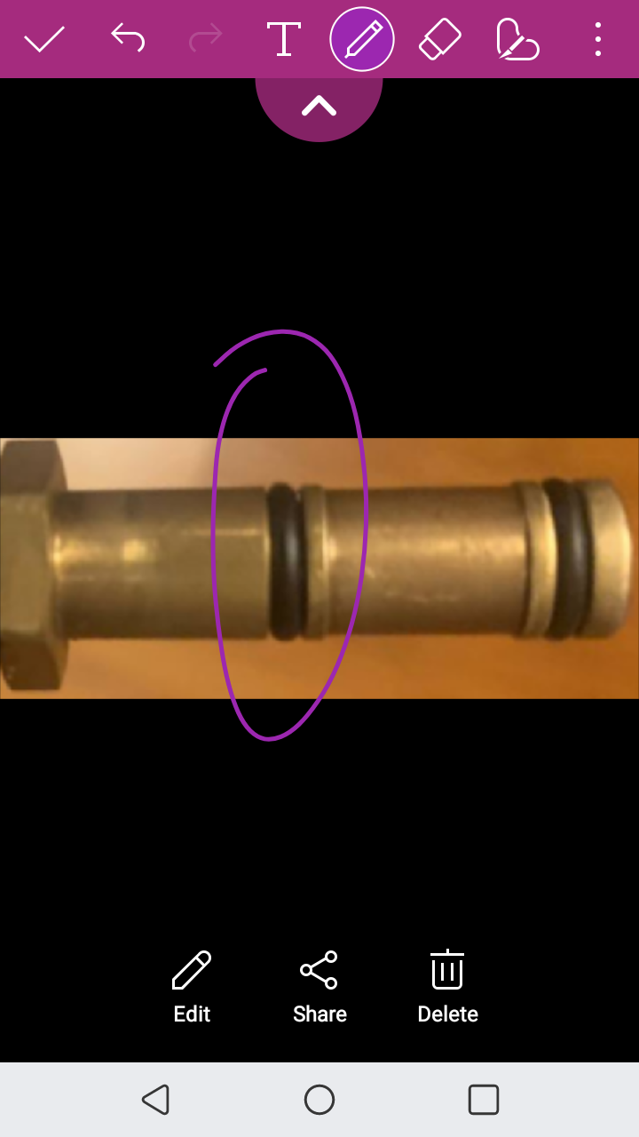

I have already sent Francisco the picture of the probe. Is it me or should the exit hole of the probe be more in the middle? Also, where it is bleeding from is the gap between where the spacer is to rotate the gap. I know you need the gap to rotate the cover, it is what it is. and just to comment ahead of time the leak is NOT coming from the probe forster fitting union.
Experts please help and have already reached out to Francisco, maybe I need a new probe.
