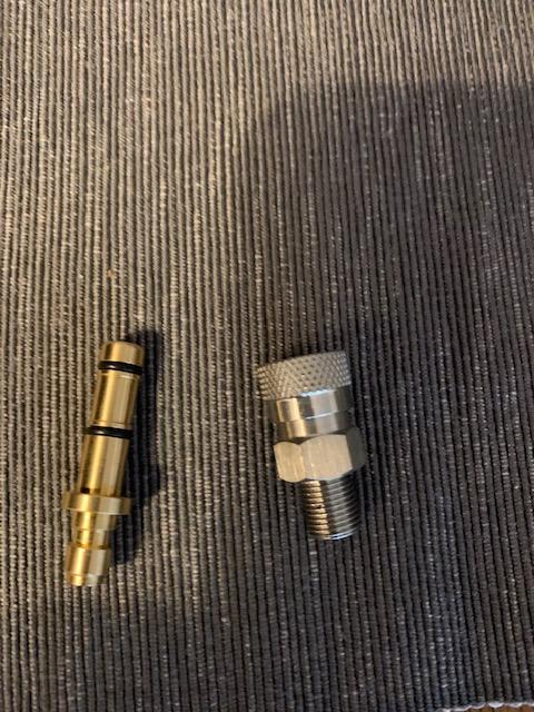

@Jwilson OKAY ... I DO NOT have that part! I only got the probe itself and not the Foster quick release fitting and the white thing. I will send this photo to Francisco so we have a clear picture of what I don’t have. I checked EVERYTHING and don’t have that part, I even looked under my sofa, and the only thing I discovered was I need to vacuum under there, no fittings just dust balls.
@coolhand thanks for the input and I kind of think that might be a possible issue. I did speak over the phone today with Francisco who I bought the gun from and with @edgun ‘s input too we think it is the fill probe might be an issue. Ed said fill probe I have is for the Hill pump not for a scuba tank, or at least that is how I took it and Francisco is sending me a new probe, which he sent today. Hopefully, this fixes the issue.
I will post an update after I get the new probe.

Francisco says it doesn’t have to be aligned and isn’t meant to be. The hole port is off set on the probe to mitigate the pressure on the valve, increases the life of the valve, which makes sense.

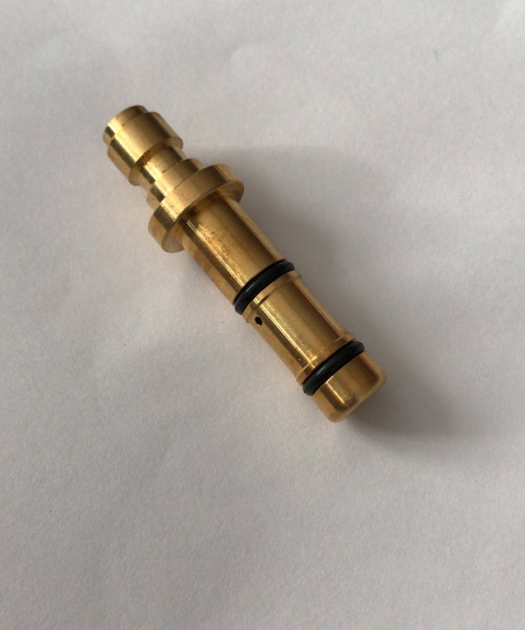

Francisco is sending me this probe below and hopefully this fixes the issue and he says this is what you have, looks like the DonnyFL one.
Houston....the problem is solved. Today I received the new filling probe from Francisco of Edgun.shop (free of charge) and he included a quick connect, now I have 2 spares.
The filling issue is SOLVED!!! now to get the air tank filled to 280-300 bar, so I can get a full charge in the gun and actually see how many shots I can get out of the OEM configuration.
And yes, it is nice to now hear air rushing out as you are trying to fill it.
