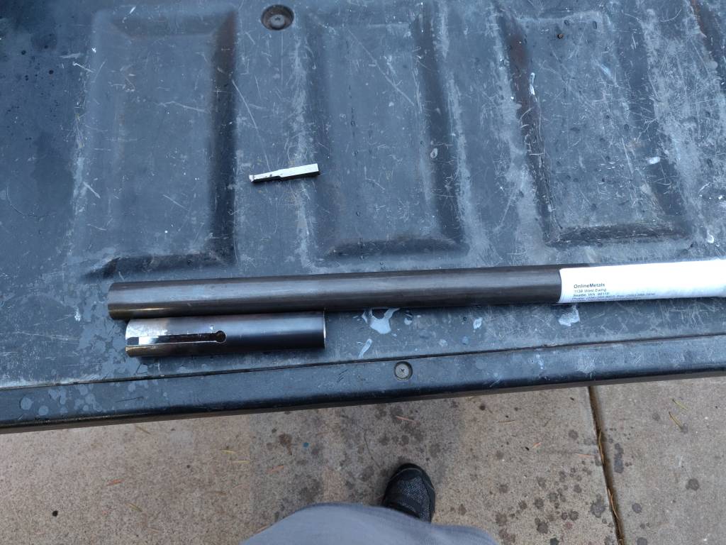

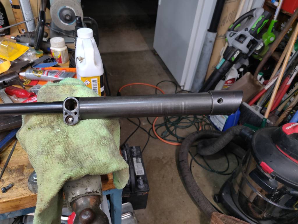

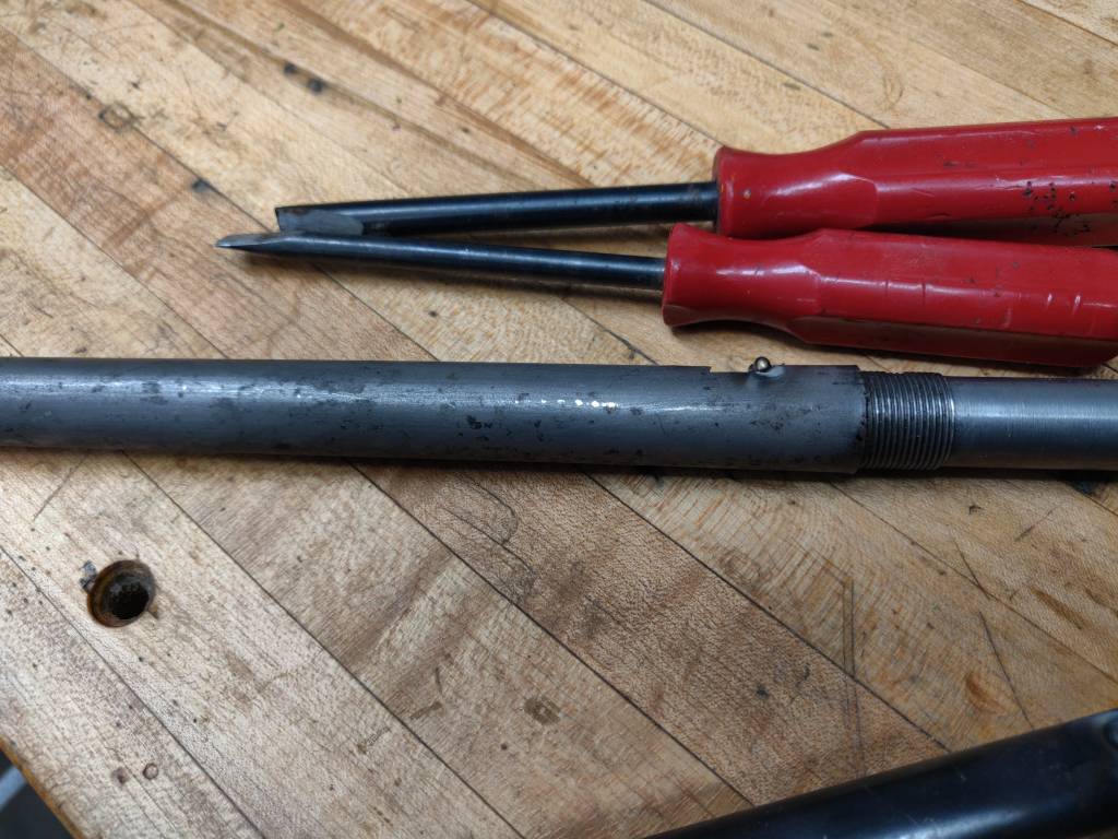

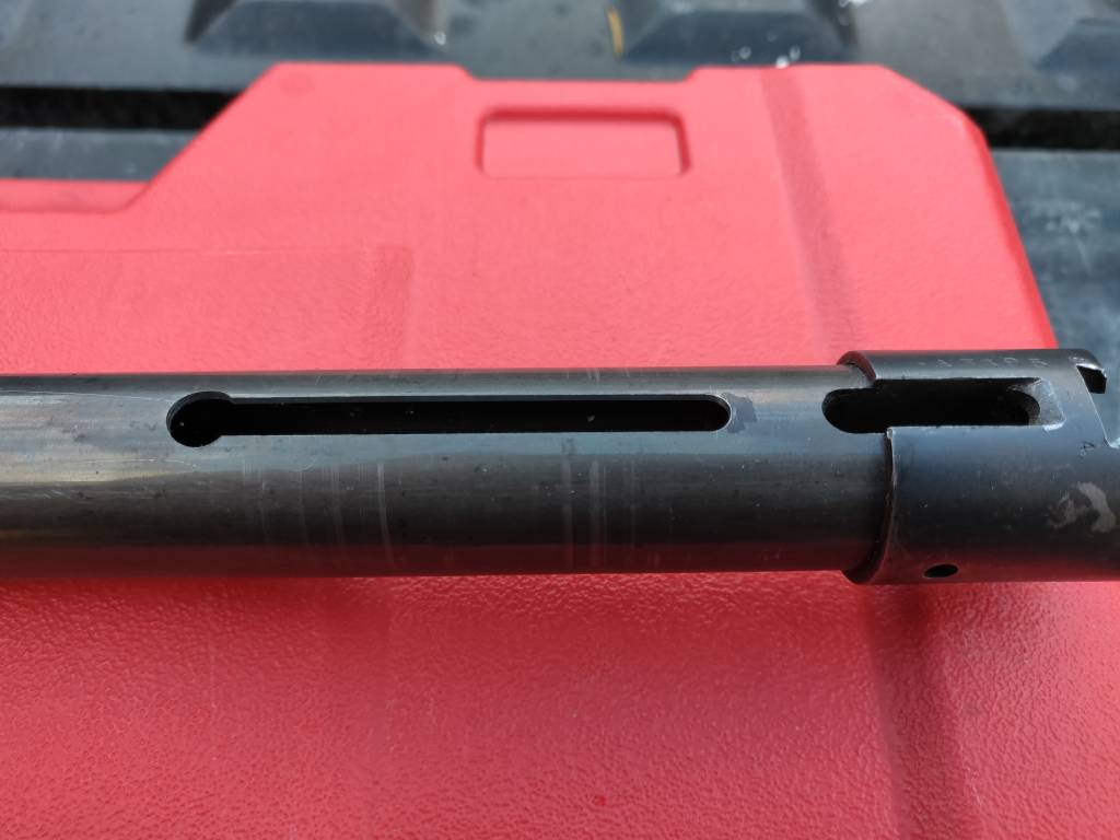

Exact diameter internal and external, 4130 normalized alloy steel. It rings beautifully just like the original. Verifying my internal threading tool is up to the task along with being nice and sharp. Let the cutting begin!
Tomorrow that is, I'm calling it an early night and I have a couple of other projects cooking right now. So I'll start fresh in the morning. If the wife doesn't nail me with any honey-do's.🙄
Mark
Augie,
I was in my groove. I had industrial metal jammin' in my headphones and next thing I know, the chips are flying. No hiccups, mistakes, nothing. It was so smooth, I did all that in about 35 minutes from start to finish. The milling will need me to be a bit more careful so that I keep everything indexed correctly. However, it won't take long to do the actual cutting. I'm thinking that I will set the piston up to accept a modern polyurethane seal. It's inside, out of sight and won't offend the delicate sensitivity of purists. That 4130 tube has a beautiful surface finish inside. Smooth, but not a mirror finish and I would guess it at the equivalent of 1000-1200 grit.
I already purchased a set of vintage sights and I have a trigger guard with the adjuster screw and a set of mounting screws on their way. The only thing left to make is the lever latch, release plunger and spring.
Definitely not a project for most tinkers unless you have the equipment for threading, but everything else could be done with a file and some patience.
Mark

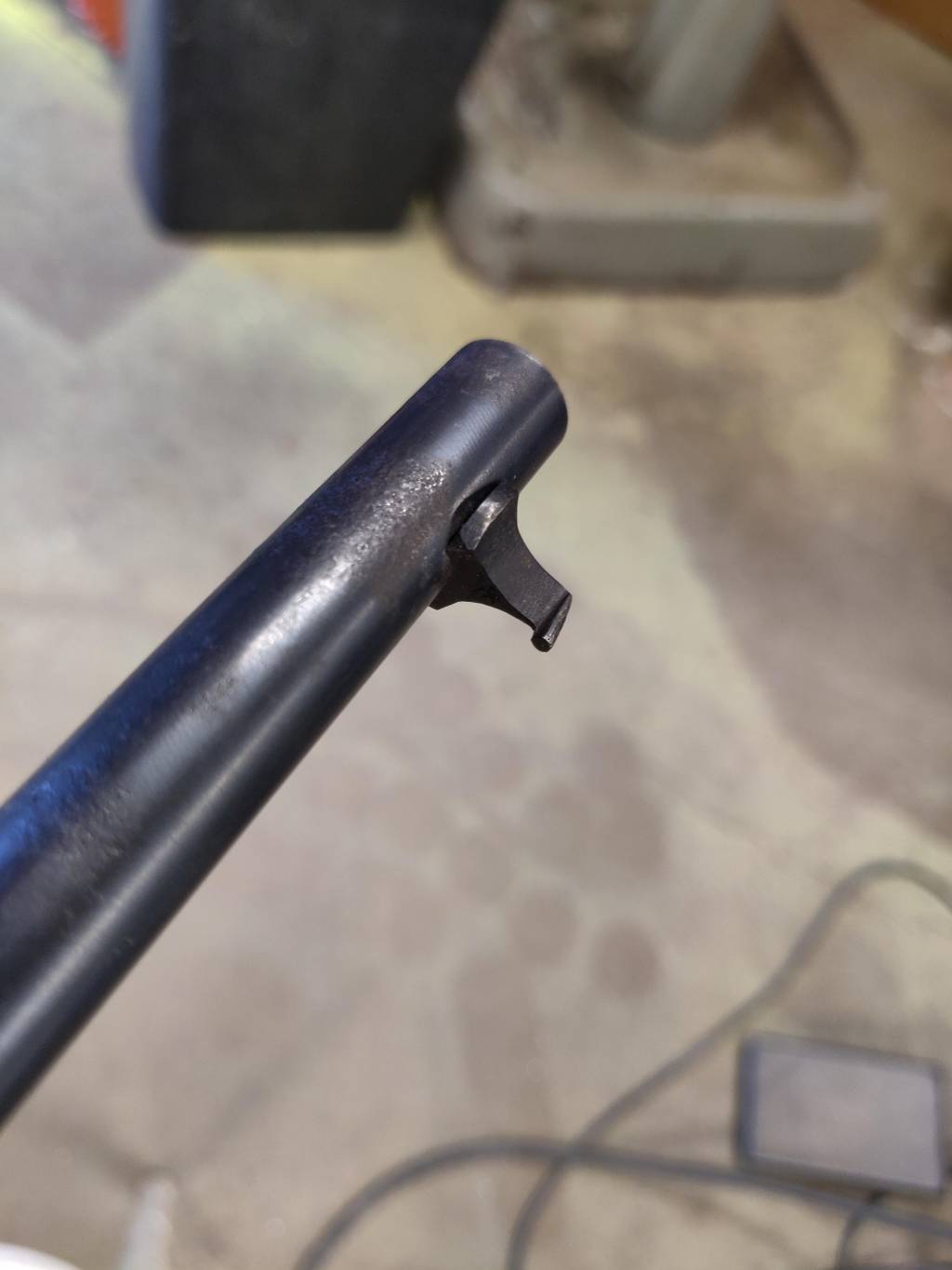

Nice Mark. What thread pitch did you settle on? Man, you got lucky on that trigger guard. Not quite the original but you should be able to make it work out. The foresight dovetails vary in width on earlier models. Did you get lucky there too? It fits? I think the turret rear sight you got is for an earlier model but it should fit ok. That type also came on certain BSA .22 RF's. You can tell which gun they originally came on by the yardage numbers on the side. #100 is from a 22 RF. #50 is from a Long Tom or Sporting pattern 45 inch. I think Light pattern sight says #35. Your original rear sight is the same as a Cadet Major and an Airsporter Mk1.

I apologise, I forgot to note that, before the game of Twister last weekend, I made a couple of passes on a piece of steel to see what I could come up with. Amazingly, I got lucky and a scratch pass at 22 TPI looked visually correct, so I ran some threads to create a thread gauge and determine how the pitch would need to be cut. I ground my tool to sit perfectly in the thread on the trigger block.

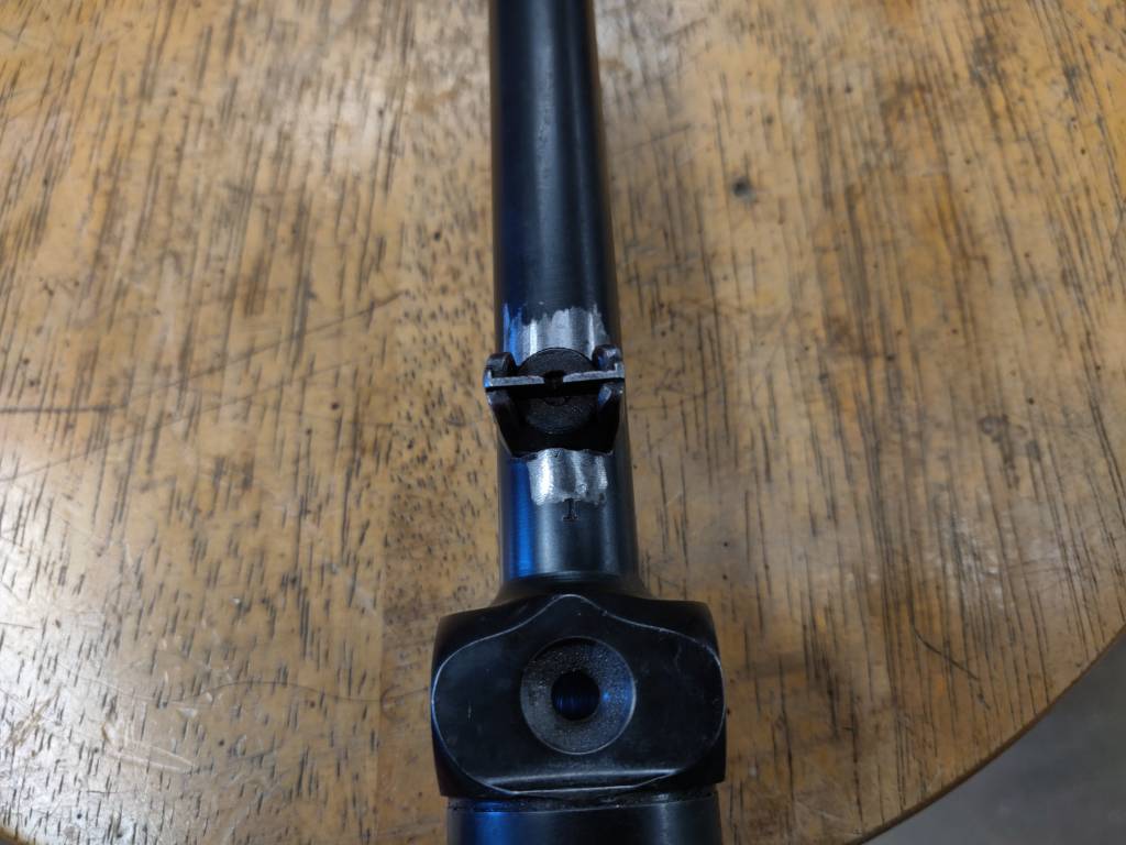

I checked the sight it is marked to 25. The front is loose and the rear is tight due to someone trying to tighten the dovetail.

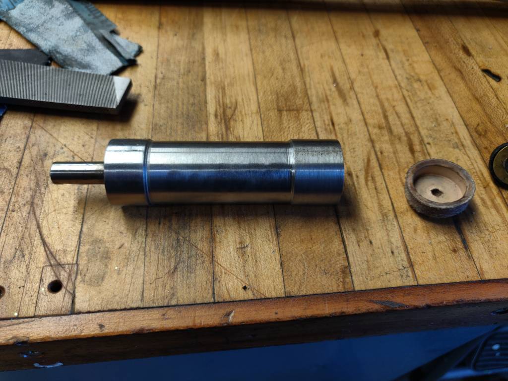

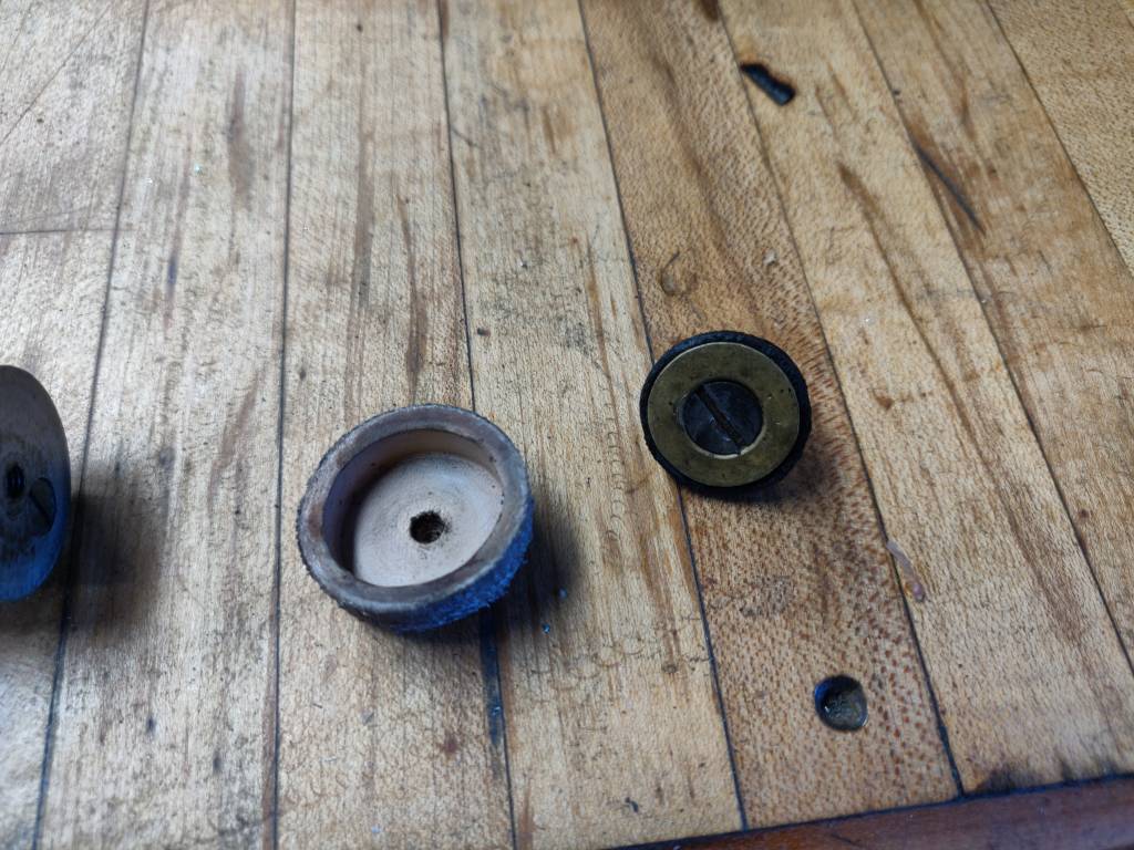

I also blued the tube and then went and made a new piston cup. It's sitting in it's mould and I'll let it dry for a couple of days.

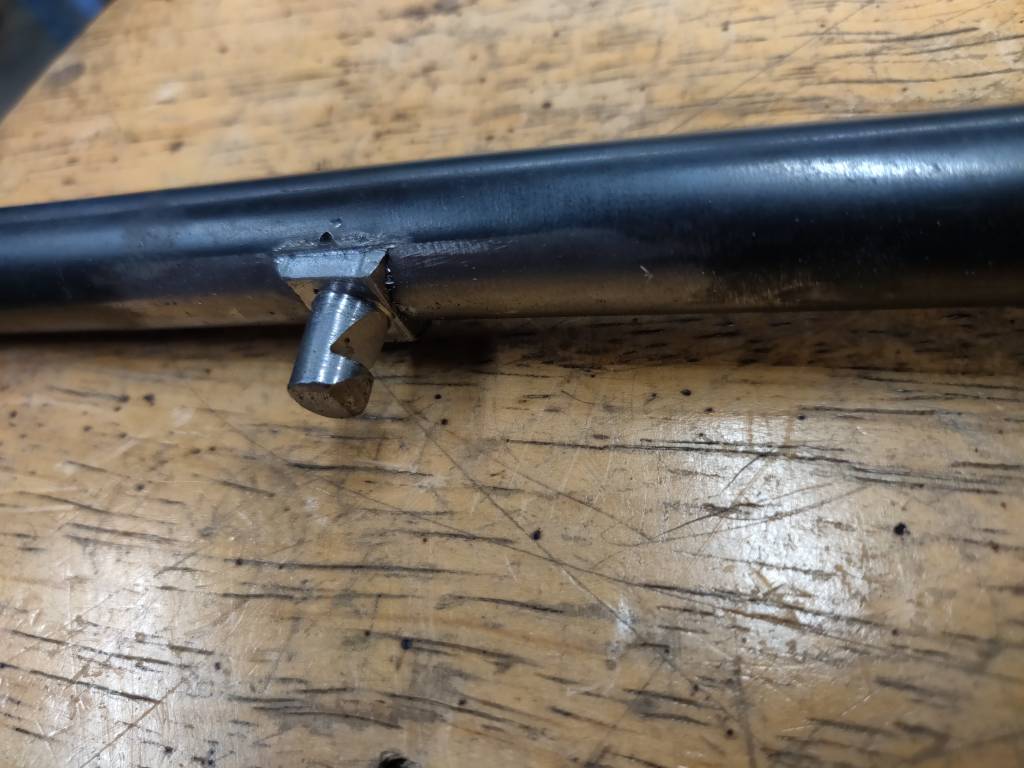

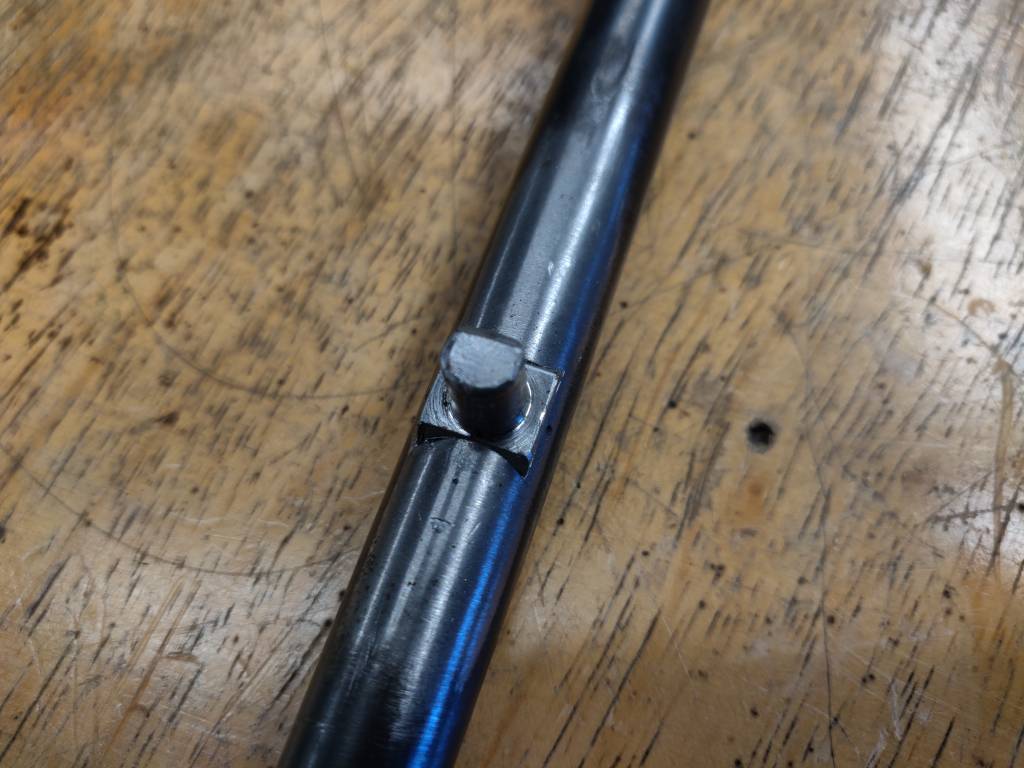

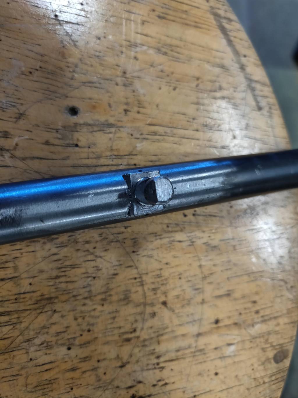

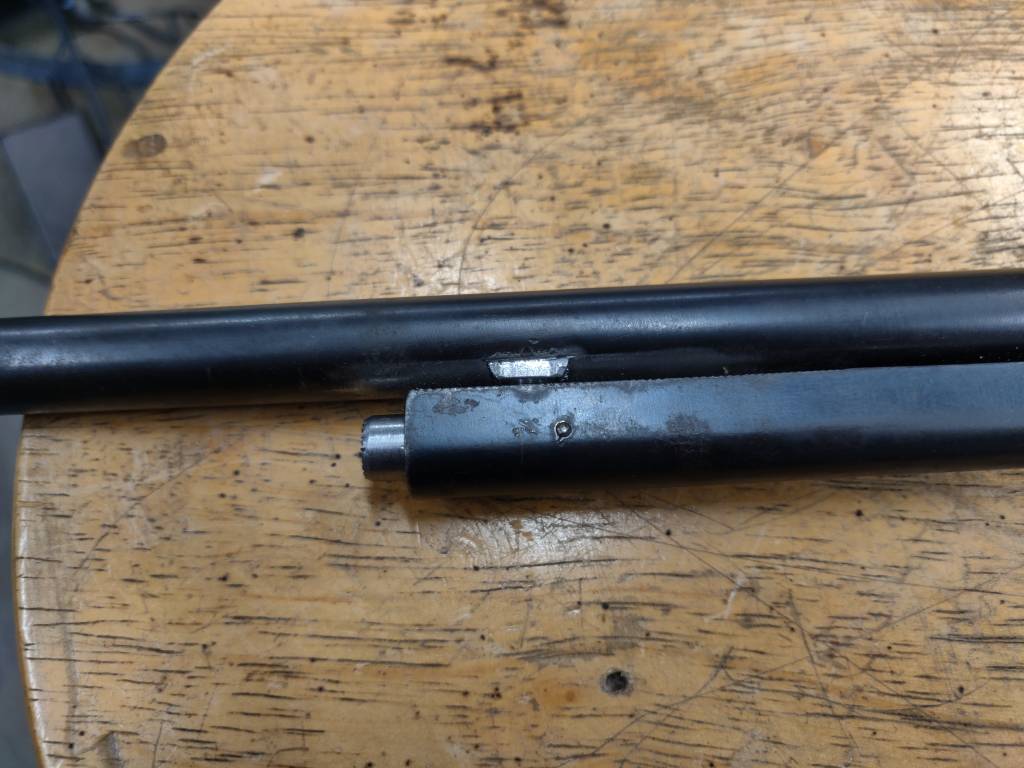

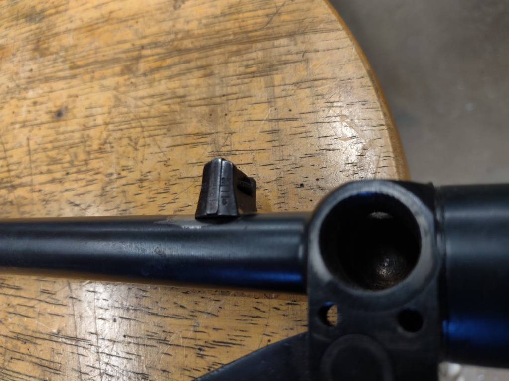

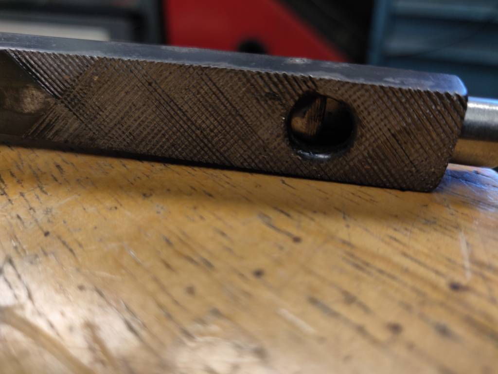

In the interim, the trigger guard showed up, so a few hours before I started cooking Thanksgiving, I welded the damaged dovetails. Today, I made the lever release latch and stud, fitted the sights and put the new piston seal together.

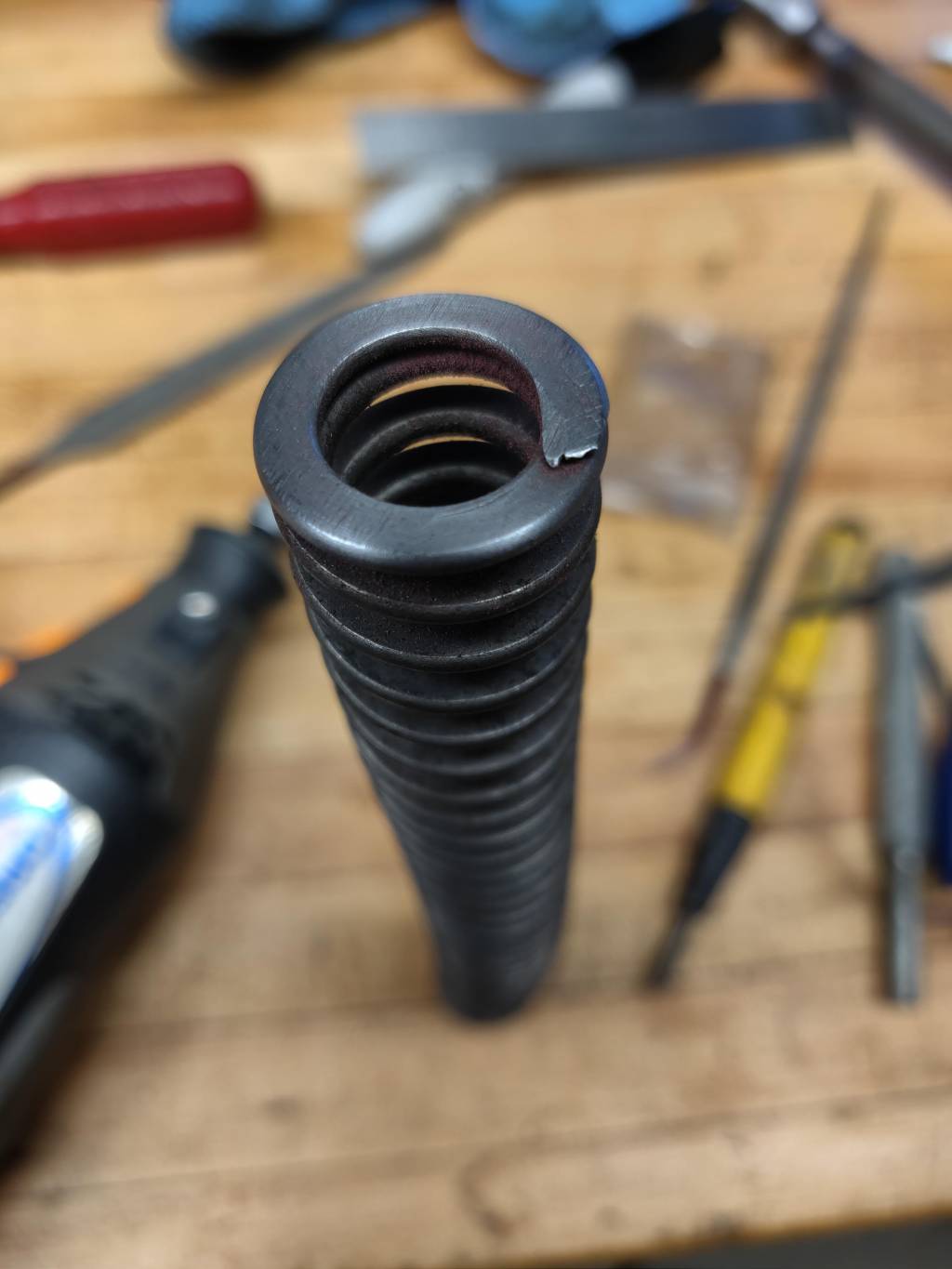

I was surprised to find that the mainspring is an original BSA, as it has a trace of the stacked rifle stamp on it.
I lubed the piston and spring, proceeded to struggle to get it back together, but finally got it done.

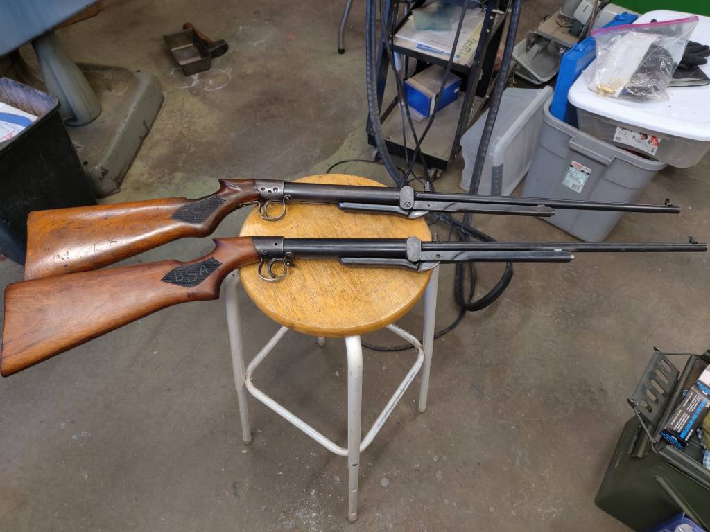

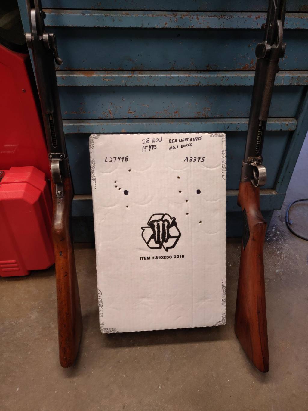

The crummy news is that the bore has a section about 4" long that is pitted and rough. No amount of scrubbing, JB bore paste and even Evapo-rust didn't make that go away. As seen by the 15yd target, it's not that great. Now it may behave differently with normal weight pellets, but my hastily set up and dismantled test range is not a safe thing for prolonged testing, so I ran what was at hand without digging around. I also shot my other Light to compare and it seemed fine with the same pellets. My groups are nothing stellar, just quickly snapped off while staying out of sight from the neighbors on the hillside above me. These were offhand unrested and shot between the branches of an orange tree 😁.
So for now, other than some touch up and a bit of bluing, I'm done with this for now. I know it would be more grief than it's probably worth, but I might consider putting a new barrel on it. It's not in any kind of collectable condition, so I probably can't do anything too heretical. I just love the balance and way it shoulders..I'll need to take the other Light apart and see how the piston looks. That one has an annoying shot cycle with a twang that rings my ears. The power is almost as much as this one I just put the seal in, but I'll bet it could use a bit of freshening up.

By the way, I took down the other Light rifle and the leather piston cup was mushy trash. It still sealed, but barely and it was smashing the center screw into the front of the compression tube and had an imprint of the port formed on it. I have made a new leather piston cup and will let it dry overnight before I lube it up and put it back together.
Unfortunately, I didn't chronograph it in the before condition, but it was almost as much penetration as the one I put together today. Crude at best, but it's something.
