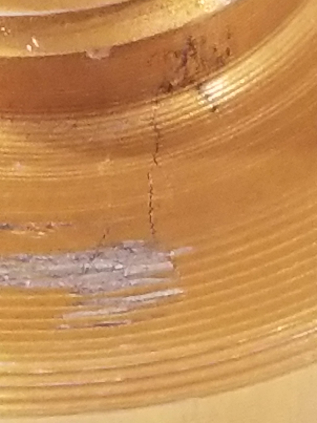

I was tracking down a persistent leak on a regulator for a small bottle. I replaced the bottle neck o-ring (twice) but it still leaked. Upon closer inspection with a large magnifying glass, I found this:
Yup, that's a hairline crack in the reg body where the reg to tank o-ring sits. 4500 psi tank. Be very, very careful out there folks.
It is from an Air Venturi tank. I think that they use Ninja regs. Don't get alarmed. Pretty sure that it was caused by me when I rebuilt the reg. Might have over tightened the fill nipple as that is the side with the crack. I'm not trying to point fingers at the reg manufacturer. Just want to warn others to be mindful and diligent when dealing with HPA.
