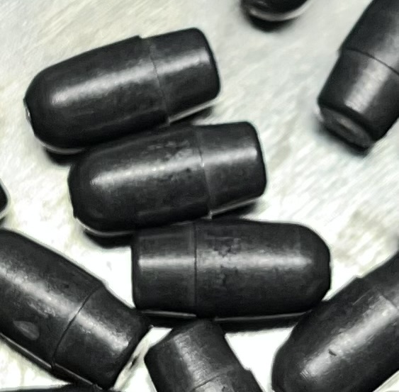

Looking at the actual round pictures, they seem to have a smaller meplat diameter than shown on the tin lid pictures. Meplats need to be smaller than about 65% of the projectile diameter to keep the drag low, but it will depend on the projectile speed.
Does this hold true about meplats? it's from wiki, so not the best source of info
Trimming the meplat (cutting the tip of the bullet, thus increasing its area) decreases the bullet's ballistic coefficient, increasing drag, and making it more susceptible to wind drift. So even though the grouping will be tighter, the time of flight and wind drift will be slightly greater.
the time of flight and wind drift will be slightly greater. YES but you can compensate for both and achieve tighter groups .
Reactions: manabeknives
For supersonic speeds of bullets, yes it is true. For subsonic speeds no, it is not true up to a point (the meplat value I mentioned).
I shoot these at 50yds and they seem to be doing well (for me). They are very similar to the ones above by Zan. I have not tried them at longer ranges, so I can’t speak to how they do at ‘extreme longe range’.
These are swaged in a die I made.
