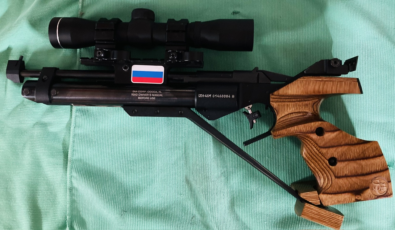

I finally got around to carving the grip on my Izzy to where I think it's pretty well dialed in. I'm wondering if anyone knows the size of the grip screws? I'd like to replace the stock ones with hex stainless.
